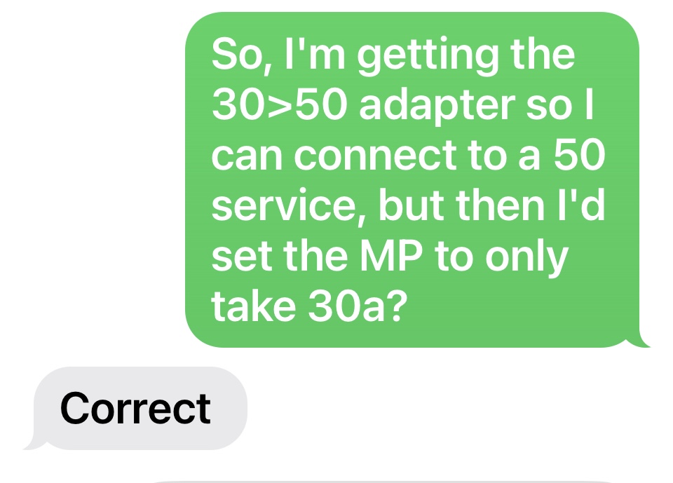

[Rich (ozindfw), Daniel (Modularmaker) and I were at DMS today and I was confused about connecting to 50a service at an RV park with my 30a 10 AWG cable. So I got back to Graham, the guy who installed my system for me, for clarification.]
[MP=(Victron) Multiplus inverter/charger which allows you to limit the input current via the screen or app]
