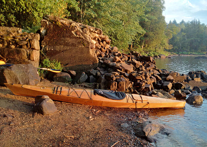

I’ma build a couple of kayaks by Chesapeake Light Craft - one each for my daughter and myself. These are beautiful marine-grade okoume boats fully encapsulated in fiberglass. Construction looks extremely doable by relative amateurs in home garages. It’s stitch-and-glue, which greatly simplifies construction and obviates the need for complex jigs and fixtures.
The plans are published by Chesapeake Light Craft (https://www.clcboats.com/shop/kayak-kits/). I’m building the Chesapeake 16 and the Chesapeake 16LT. These are touring boats suitable for use on lakes, seawater or gentle rivers. They are very stable and not for whitewater kayaking.

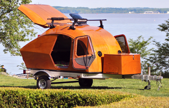

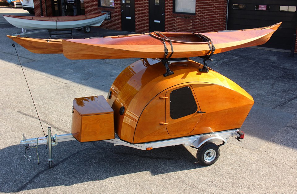

Also - seriously considering a build of their “matching” teardrop trailer, built with the same materials and construction techniques. Plan is to CNC this too, after digitizing their paper plans. It’s a beautiful and very functional design towable by any car.

That teardrop trailer looks interesting. A lot of work, but I love how light it is! Since I don’t have room for a trailer in my driveway or garage, I need something that I can roll to the side of my garage on my own. That one actually looks light enough. :thinking:
If you decide to make that also, I might be interested. It would really help me practice a lot of skills while building it.
