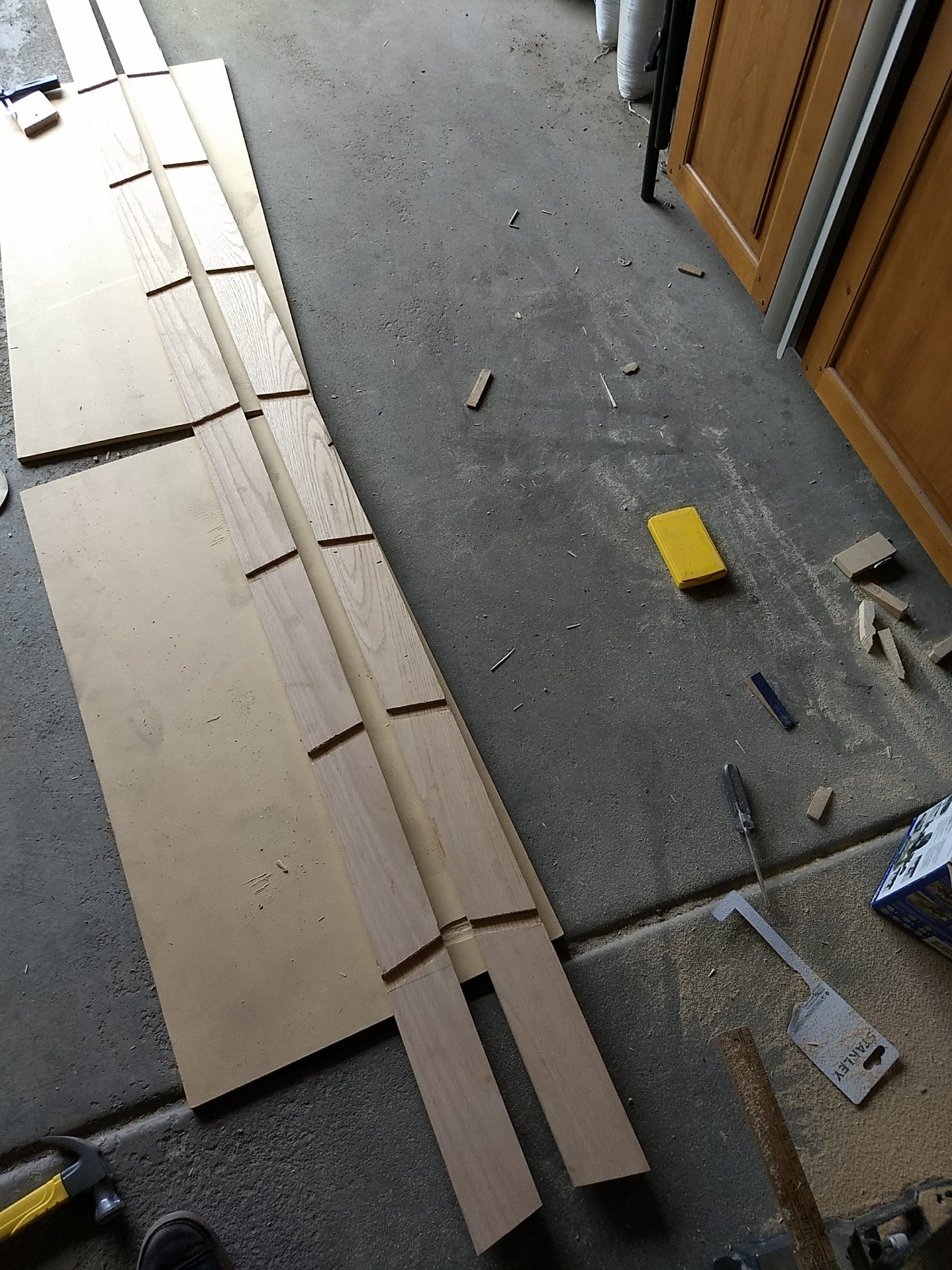

One way to do this is to make one single upright that is twice as wide as you need it to be. Make all the dados in this one piece. Then rip it in half and you have matching dados.
Unfortunately, the steps aren’t at a 90 degree angle to the uprights, so the dados need to be mirror reflections on each piece.
Set up a jig with a router to make the dados. Shouldn’t be too bad. All you need to do is make the first one in the right spot then the jig would make the spacing easier & more important consistent.
Or find someone with a radial arm saw. Then put a dado blade in it.
The angled dadoes on the ladder rails are usually done on a table saw, but can be used on a racial arm saw as well. You’ll need to buy a a dado stack and adjust accordingly. Use an adjustable cross-cut miter gauge and adjust to proper angle. From there, remove the fence , clamp the stock to your gauge and go at it. I would use red oak, depending on the look you want.
The upper detail can easily be done by creating a template and tracing to the stock and using a jig saw to cut out. Finish off the edging with a round over router bit on the router table.
For added detail, you might try a through mortise-tenon with wedging for the steps. This would eliminate any hardware and can be done without dadoing. More handcrafting, but look really cool, especially if you use a darker wood double wedge locking system. Crap, now I’m thinking about this!
One more way to accomplish this, probably the easiest. You could use 1x stock and laminate the dado for the steps. So by using the miter saw, you’ll just need to get your angle then cut the inner laminate to create a dado for each step. This will create an 1-1/2" ladder rails. Round over the rails on the router table and you’ll create a very stable laddder.
So here’s how
Measure and make dado on one then get your blank lined up off the 1st. Check ever mfing step. PITA
I also used a miter saw with a spacer block. Set the stop depth to 1/8" then made all my cuts @ 12degrees obviously you have to slide the 12 degrees to opposite for the opposite rail. Make one rail with dadoes then lay your other right next to it measure off the first one
