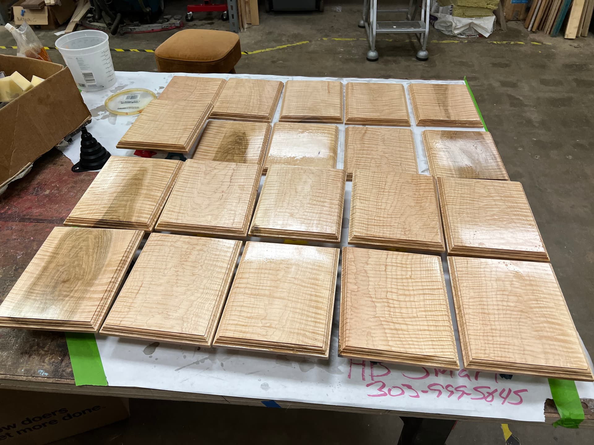

Seeking suggestions for polyurethane finish. I am not the greatest when it comes to eliminating brush strokes so the concept of wipe-on (or wipe-off?) poly is enticing. While I want it to look nice, “less likely for me to mess it up” is more important than musical-instrument-quality appearance.
Details:
  • clear coat for gel stain
  • decorative item comparable to a simple beveled picture frame
  • willing to put on several coats
  • Durability doesn’t matter
  • Yellowing doesn’t matter. The gel stain is very dark.
  • For no defensible reason other than personal preference, I prefer oil-based if possible
TIA.

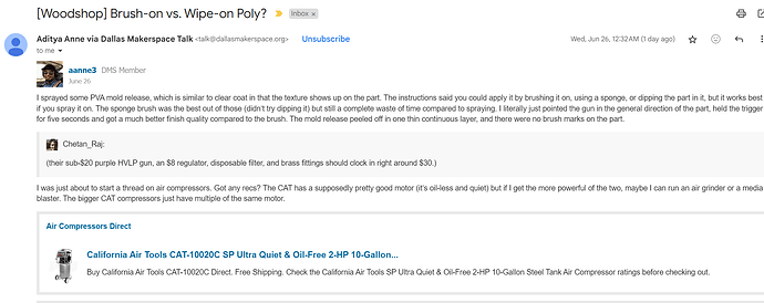

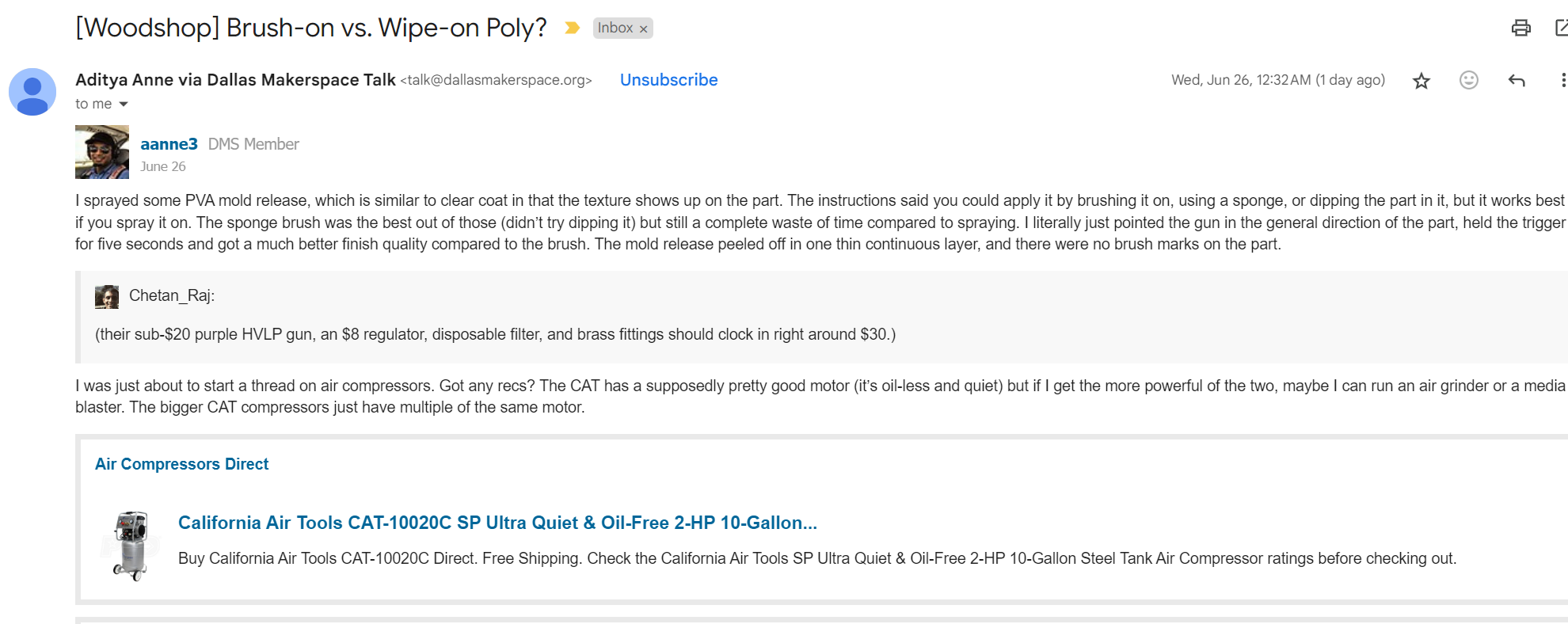

I sprayed some PVA mold release, which is similar to clear coat in that the texture shows up on the part. The instructions said you could apply it by brushing it on, using a sponge, or dipping the part in it, but it works best if you spray it on. The sponge brush was the best out of those (didn’t try dipping it) but still a complete waste of time compared to spraying. I literally just pointed the gun in the general direction of the part, held the trigger for five seconds and got a much better finish quality compared to the brush. The mold release peeled off in one thin continuous layer, and there were no brush marks on the part.
I was just about to start a thread on air compressors. Got any recs for garage use? The HVLP gun uses a lot of air; that’s the downside. The turbine and quality LVLP setups are more than $30.
So your message preview/notification in my gmail is the first time I’ve actually seen an inline ad for something in gmail. At first I thought the listed compressors were actually part of your post and it wasn’t until I clicked through that I realized they weren’t!
Funnily enough, the first ad is the exact compressor that I’d recommend, as it’s the one that I own. I’m not sure if Google knows that I own it though as I bought it off of FB marketplace and am not sure if I’ve ever done a search for it before… so I think this really might just be a coincidence instead of a targeted history ad.
It is only a 10 gallon tank but the compressor is powerful and fills it quickly; it is indeed very quiet (which was a HUGE upgrade over my old Harbor Freight base model compressor which was deafening), and the oilless operation is a nice plus.
How big of a tank you need normally depends on how big of a part you’re spraying. But IMO unless you’re spraying something lets say bigger than a car hood, this 10 gallon tank is sufficient. Bigger is always better but budget and space considerations made me go with it.
They were in my original post. I edited my post, but it sent you an email of the original, whereas the website displays the most recent version along with a button to see the history.
Oh, ha, that makes sense too then. Anyway, ya, I’d recommend the California Air Tools 10Gal Ultra Quiet. I have it and like it!
