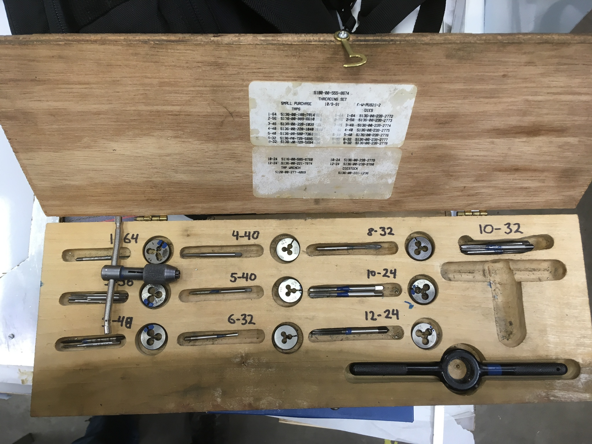

Broken 6-32 tap
@Team_Machine_Shop
I broke the 6-32 tap in this set. Let me know what I owe to replace it.
