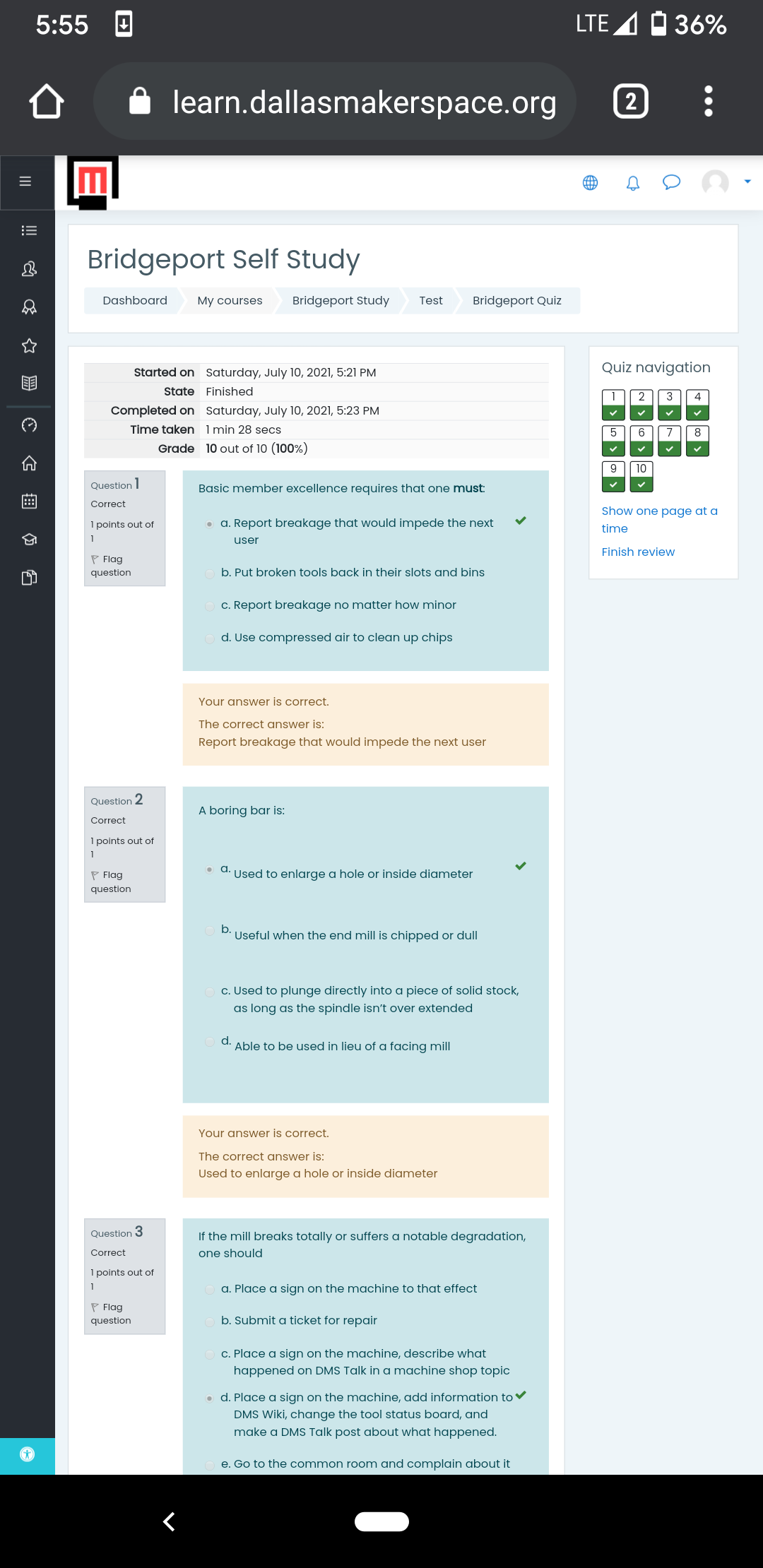

Finished the quiz. And nope, only home cnc experience.
I dont recall seeing your email come through with the quiz results.

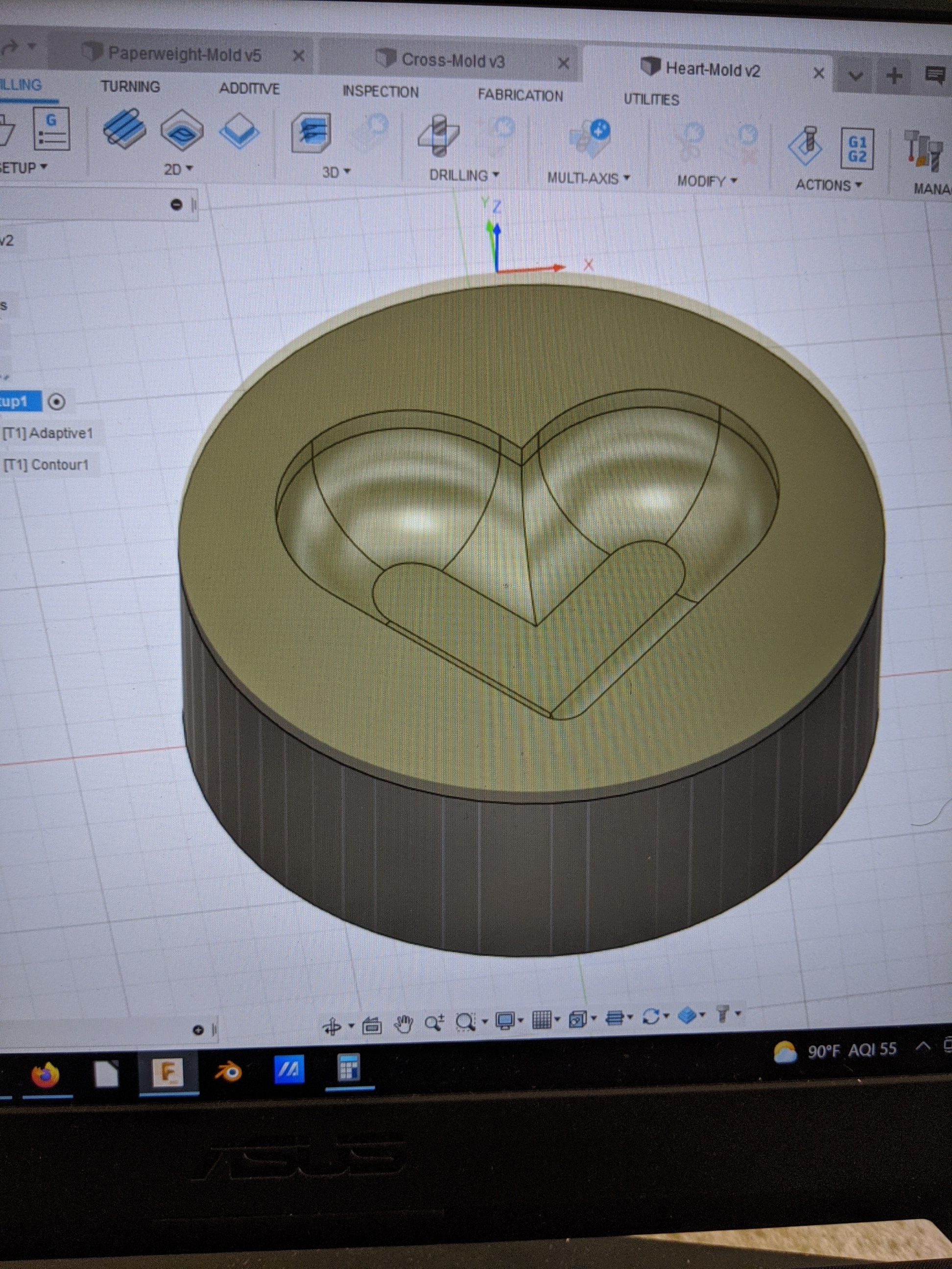

I’ve been making these small pour/stamp molds. You can either cut off the gather of glass into the hole and “pour” it in, or thread the back and use it to stamp into glass.

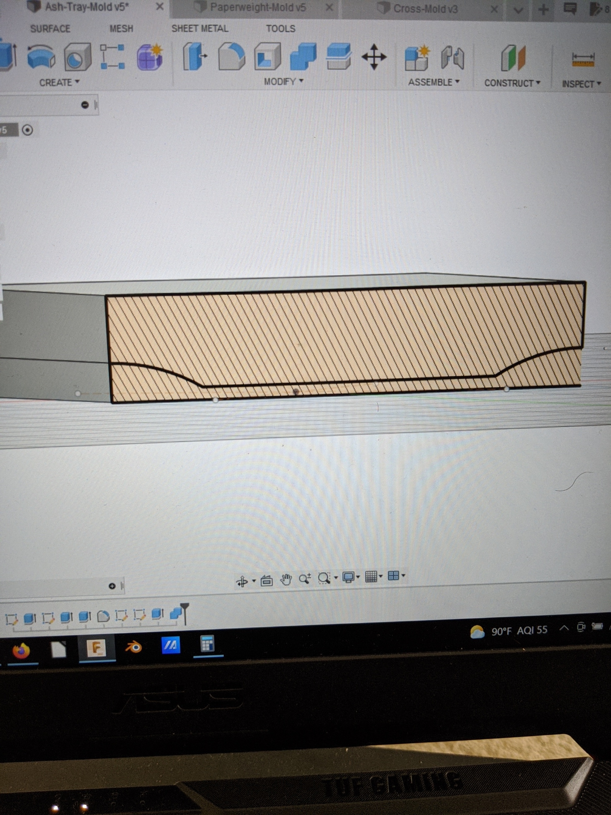

I just got a new Shapeoko that let’s me make 2-part press molds (this one makes an ash tray). Hopefully once I can use the Bridgeport and HAAS, I can make bigger molds and blow molds too.
Not to be a kill joy, what you have is a CNC part, not a manual mill part…
Compound complex curves on a manual mill like above part is extremely difficult for even a very experienced master machinist (you are adjusting the X-Y constantly as it moves, then in the Z axis to make the next cut down. You are doing this equation with your hands:
only your hands have to solve X and X simultaneous by adjusting table relative to the spindle. Both are accelerating or decelerating constantly relative to the other ordinate.
The Haas definitely can do it. We have knee-mill attachments that allow circular cuts (easy with rotary table) and some oval type cuts that are based on circular constant arcs If there is under cutting would be limited by the radius of a ball cutter from the edge of shank - on both the Haas and knee mills unless you have tooling that allows repositioning of the part. To even make it close to smooth surface, figure .001" depth of cut … inch deep a thousand passes.
If this is what you want to make, go straight to the Haas or some CNC unless you have super-human hand coordination.
The HAAS is definitely the end goal, but I have to take the Bridgeport as a prerequisite. Until then I can use the Bridgeport to clear out rough cavities and then use my CNC for the exact shape.
