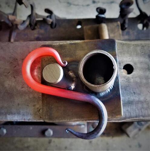

Is it brass tube or solid brass rod? If the latter, you don’t have to worry about the tube collapsing and can use a simple bending fork to bend it. Two bolts or pipe segments clamped in a vise with a small gap for the material can work. There are a couple of different one piece bending forks in the Blacksmithing area, too.
Here’s a Google-derived image of a similar design.
