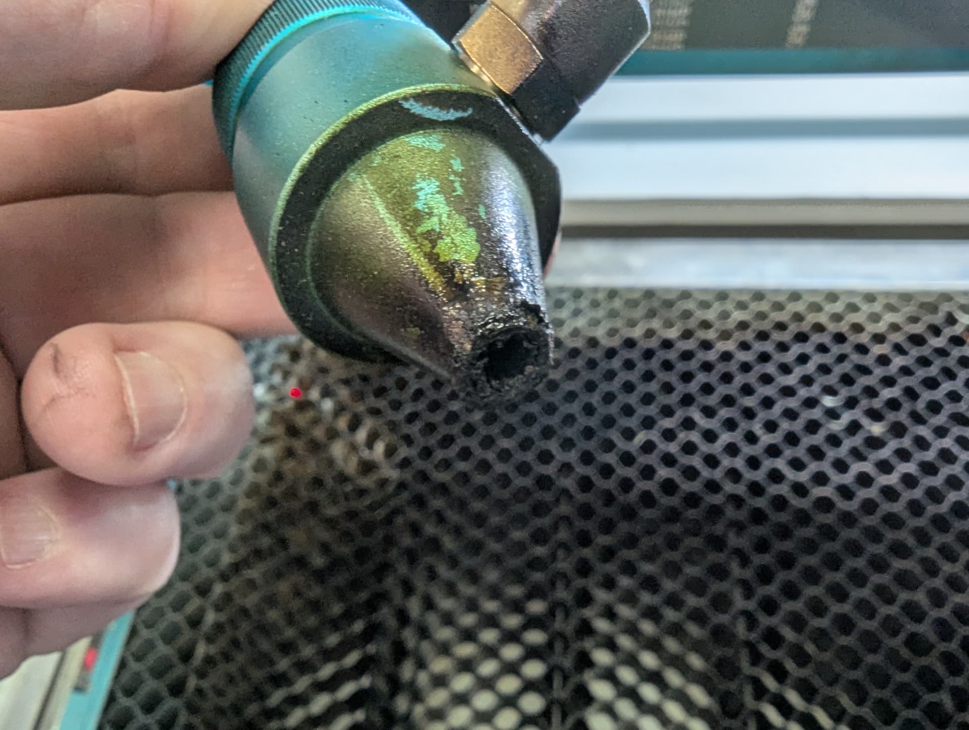

Blitzen Down - Misaligned?
Cone placed on top and power turned off.
3 visible issues:
1: Shadow\doubled line visible during cuts
2: Unusually heavy buildup of soot around air nozzle tip
3: Z-height only moves in set distances (approx 1 cm) per button push
instead of the normal movement only when the button is actively pressed.

Thanks Paul. We will address later today.
shadow: loose lens
soot: deep blasting of material out of a board, or cutting cheap plywood
z-height: It appears that someone made adjustments to the default settings(can’t lock people out.)
