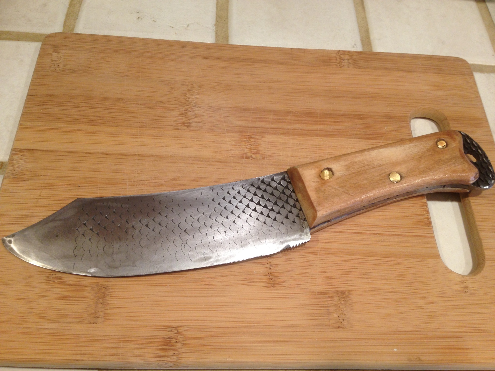

They make cool knives. My favorite kitchen knife is the first rasp knife I made:
