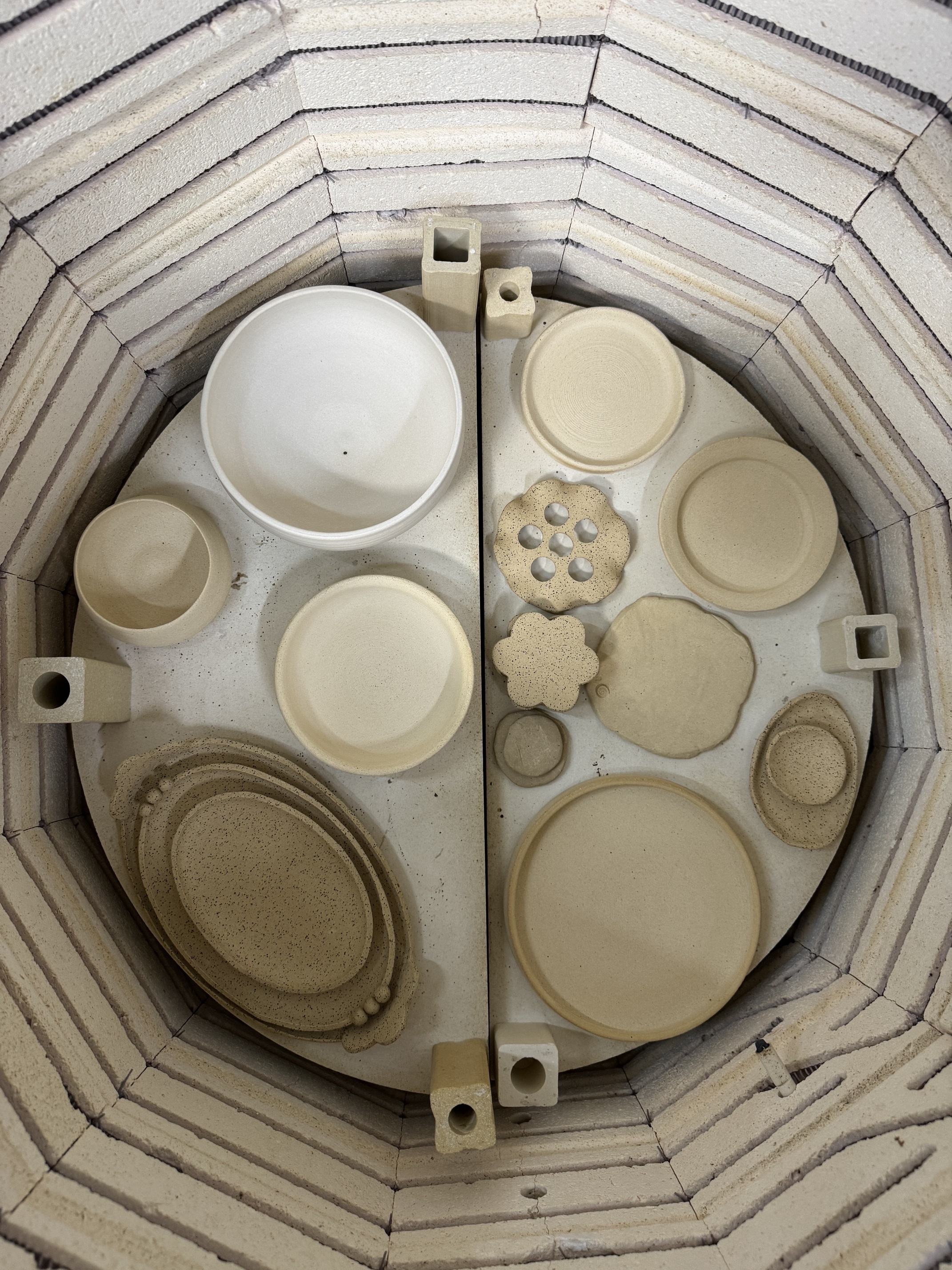

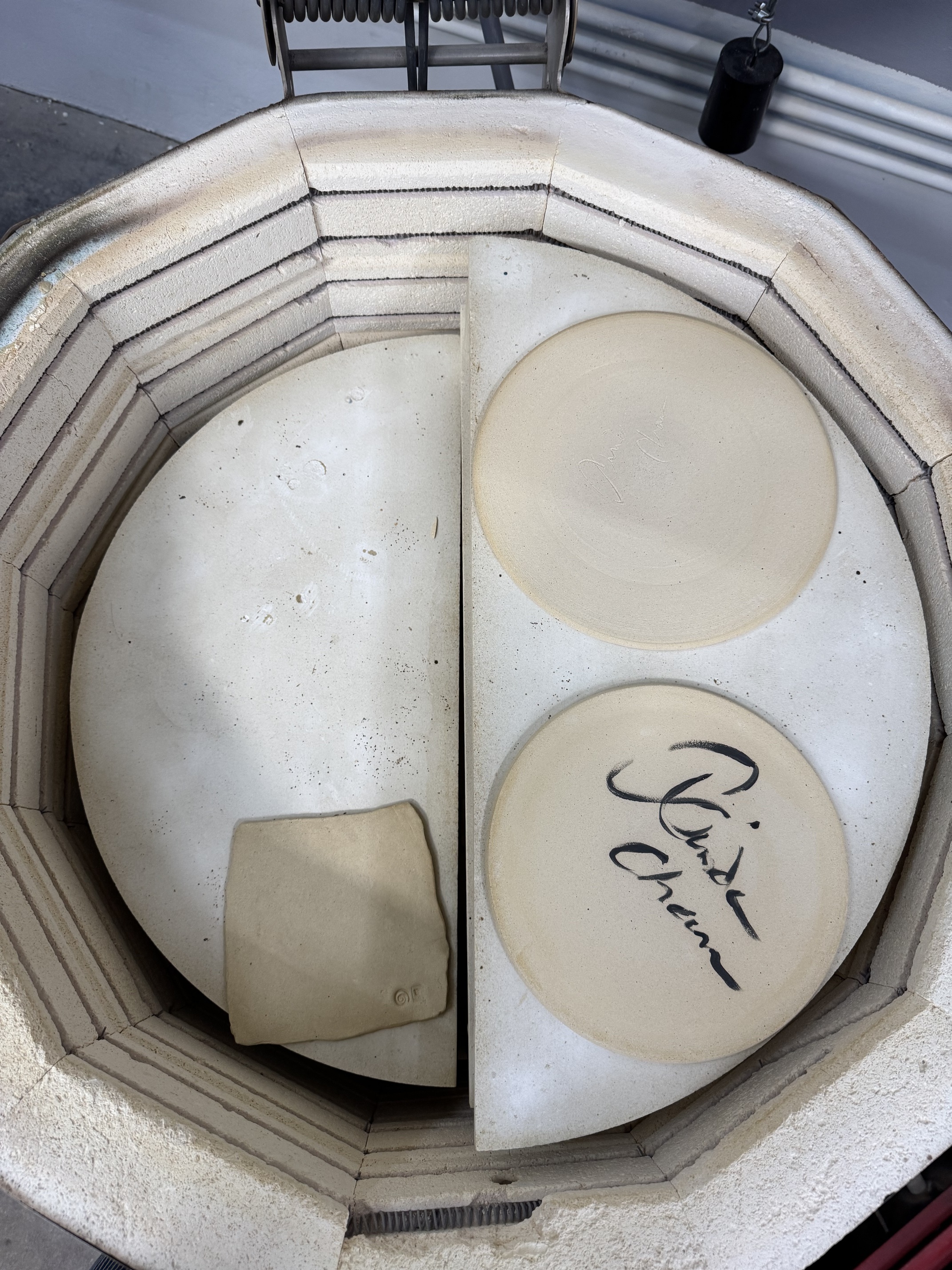

Hello friends, I wanted to let the community know that I mistakenly fired a load of greenware to cone 6 without a bisque firing. These pieces are now fully vitrified and it may make glazing difficult, but not impossible.

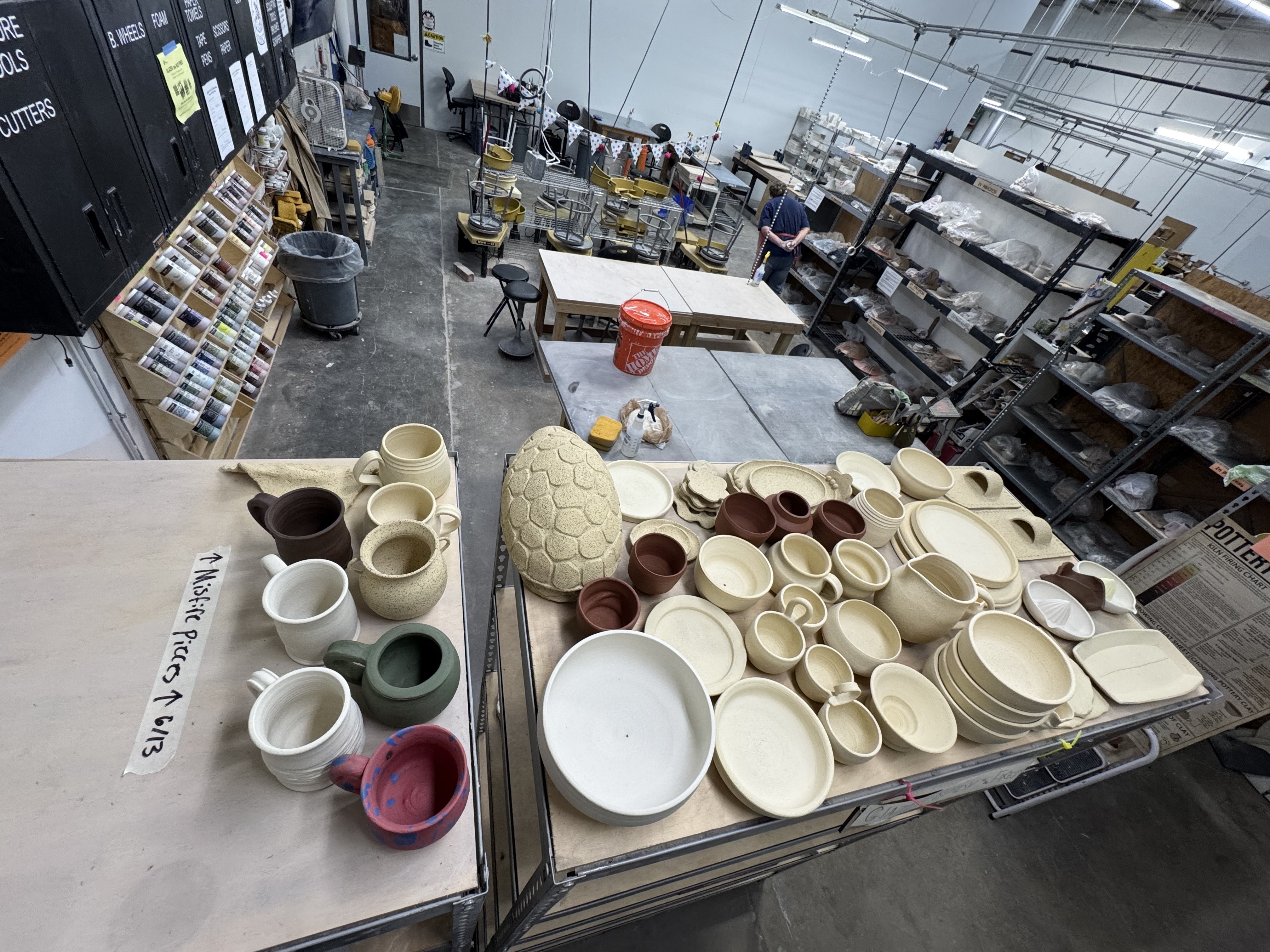

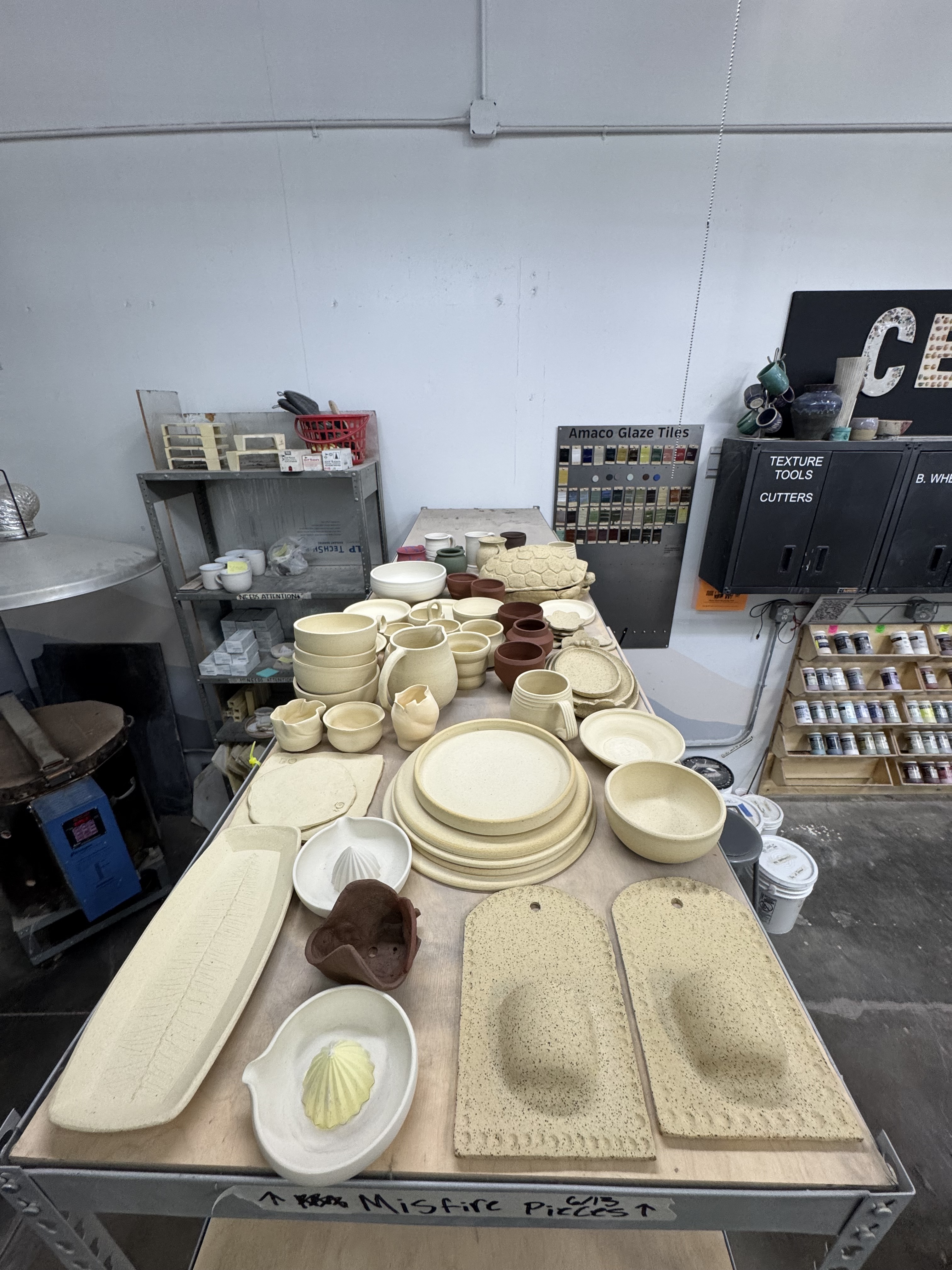

  • Affected pieces will be placed on the special firing shelves (the very top of the “ready for firing” glaze shelves). See image.

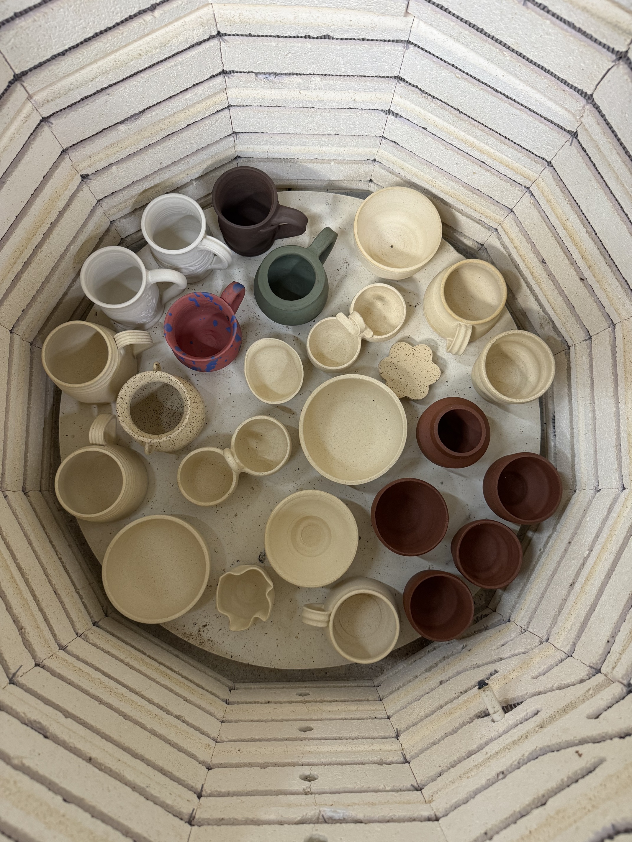

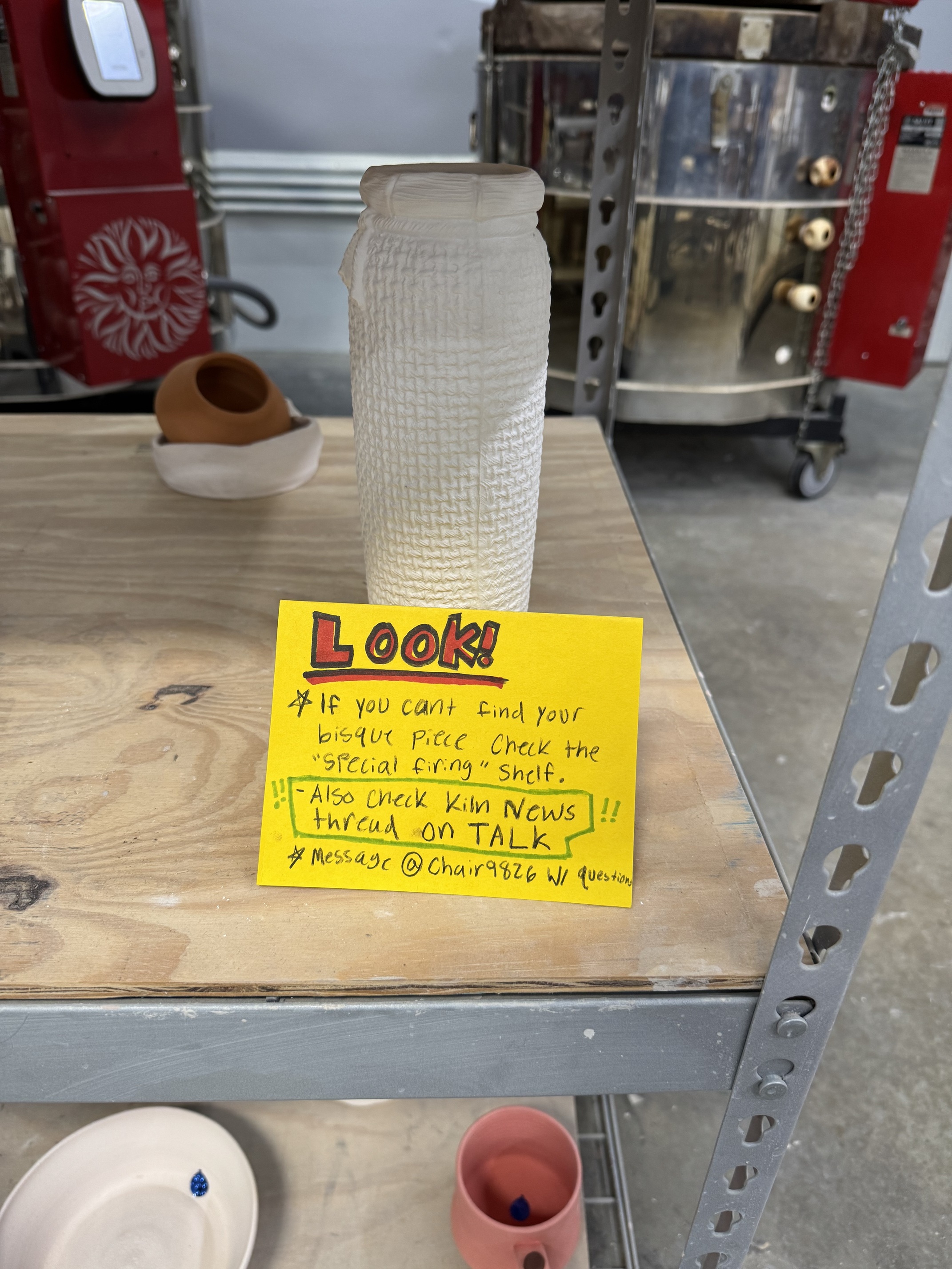

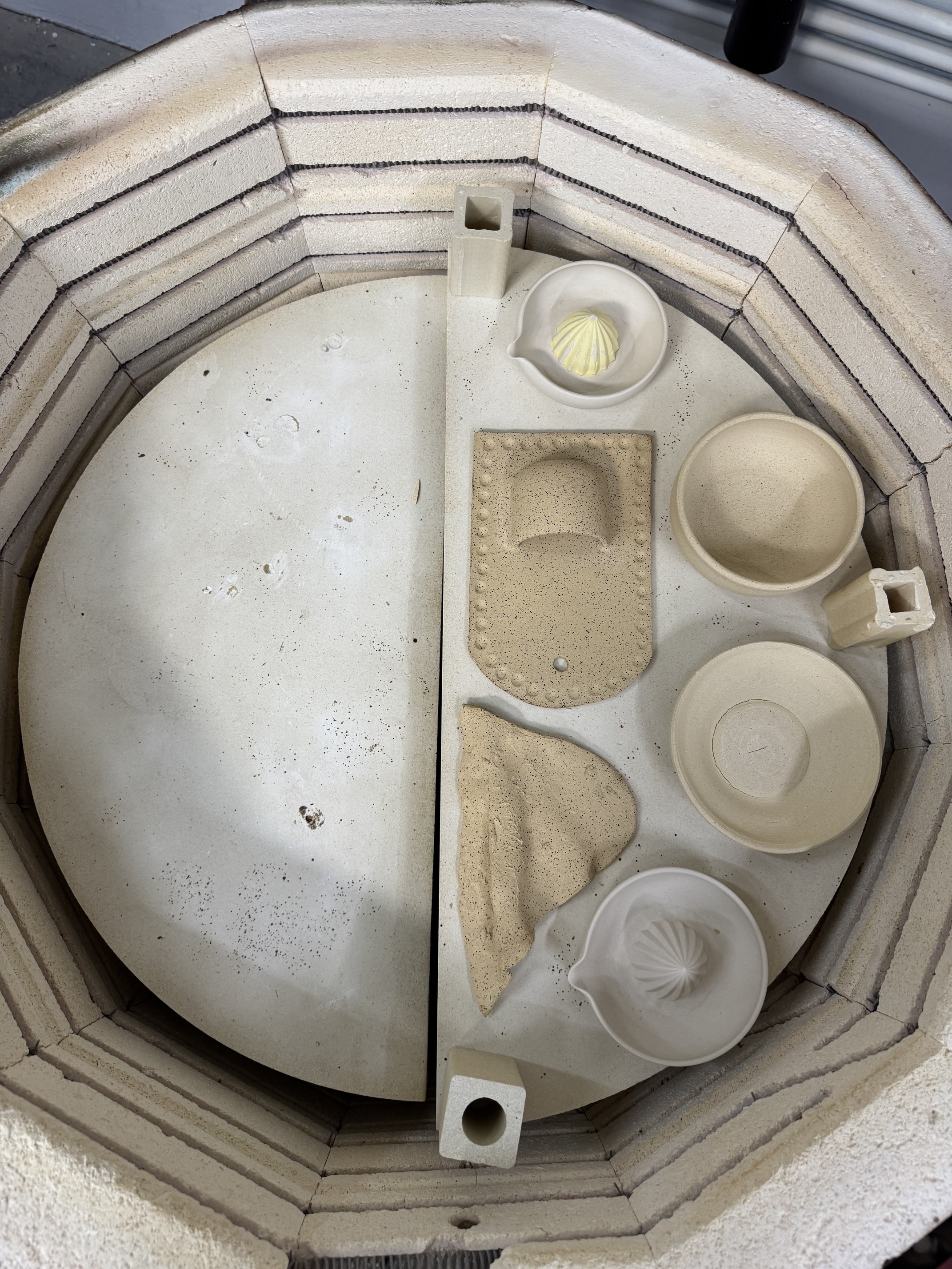

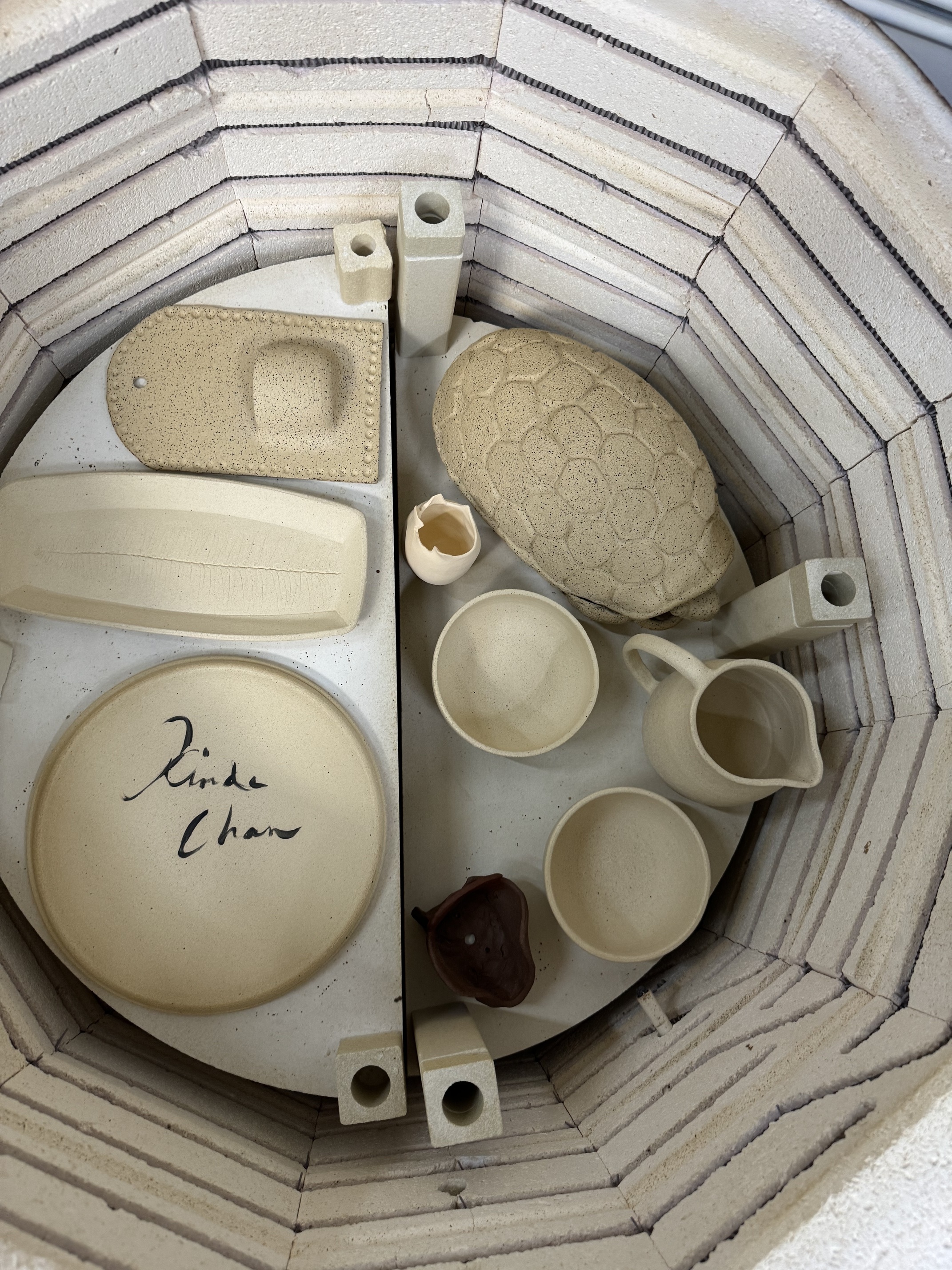

Please look at the following photos to determine if your piece may have been affected. I’m including photos of the signage and where they are located as well.
