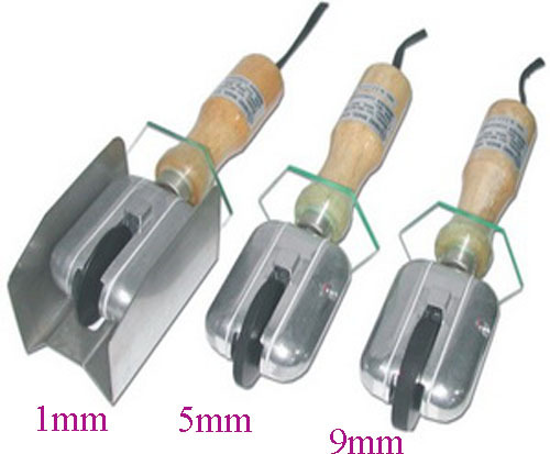

These are most likely heat sealed, so I would bet a costant heat roller sealer would be required.
Source: http://www.ebay.com/itm/9-mm-Constant-Heat-Roller-Sealer-for-Heat-Seal-Plastic-Hand-Hold-Long-Sealing-/370368369849
