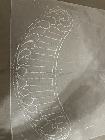

I actually don’t plan to use thread. I just want to needle-punch some waxed paper and then use that as a tracing template on my “real” project.
I usually do that on my lesser Viking (which is in the shop right now) and then I do the FMQ on my other Viking.
It’s a one-time need so it is not worth investing in additional equipment. I was only interested in the Babylock because it doesn’t have a thread sensor. If someone wants to do FMQ at DMS, then I endorse the Viking for that.
Seems like a pounce wheel would be easier. I assume you are making the holes to transfer a pattern to another material.
Pounce wheel is a good idea.
I pin the waxed paper pattern to the quilt, stitch through the paper, then tear it off. When I make the waxed paper pattern, I layer 6 - 8 sheets of waxed paper together to reduce the number of times I have to stitch a pattern and it’s good practice for when I stitch it with thread.
