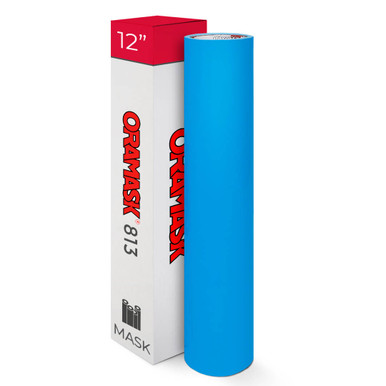

I’ve been told by multiple people that we had some, and was showed a roll of vinyl, but I have yet to see any that’s thick enough to do it properly. The stuff I use at work is Hartco 310-S Sandmask. Whatever it is that we have at the space isn’t strong enough to hold up to anything but a light frosting with very finely filtered sand. I’m assuming that the stuff I use is significantly more expensive (I think it’s like $4/ft on a 15" wide roll, but I haven’t ever bought any myself). In my experience, it doesn’t actually need any transfer tape because it sticks together again after cutting. I usually weed it after applying it to the piece I’m sandblasting.
This is the vinyl we have for masking:
The roll was almost used up the last time I checked it a few days ago.
I tried that one. It was good for about half a second of blasting before the edges started to fray. I’m sure it would’ve worked marvelously if I were airbrushing though.
