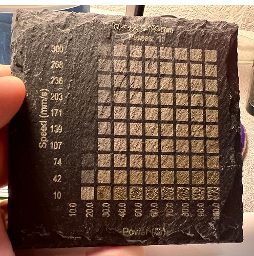

Forgot to say thank to @Hardsuit for the get together and the “paint”. Did get Lightburn set up on the F1 and burned a few power/speed grids:
Tile:
Wood:
Slate:
