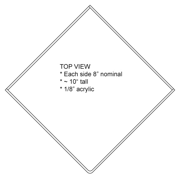

I need to make a plastic vitrine (i.e., display box) to cover something. Due to the nature of the contents, I’m thinking about bending one corner (using the strip heater) and gluing the others. The contents would be viewed from that one corner and I’d rather not have a seam there.
It would seem like I could still route the seam edges and also at the top, including around the bent corner.
I can’t seem to find a bend radius calculator for acrylic but I’m thinking I could get a fairly tight bend.
Anyone have thoughts? Suggestions on how to get a perpendicular bend at the corner that’s not skewed off of the vertical? @jlcourtman, what do you think?
