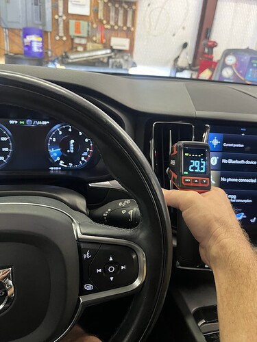

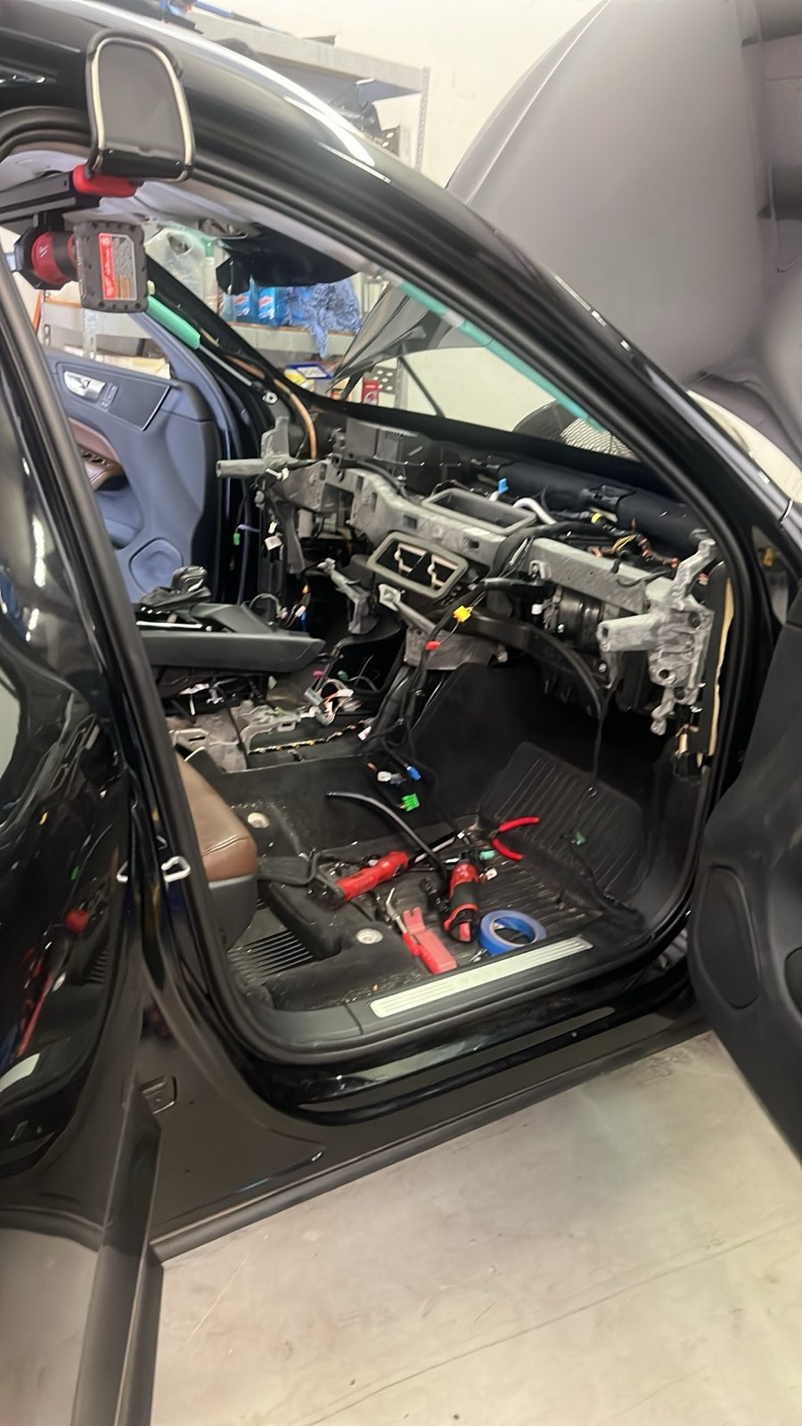

A friend of mine sent me a couple of pictures of an Air Conditioning Evaporator replacement he completed today.
In case anybody is curious as to what is typically involved on most cars…

Holy shit! 29 degrees? That has to be undercharged.
And yeah on the dashboard. That’s absurd.
No under or overcharging with a fully self contained AC machine!
I don’t miss the days of instrument panel removal!
He did say there was no hardware left over, no extra “mystery screws”
At times, I’ll take a mystery screw over having one that I realize at the end, should have gone in first.
Or running out of screws before it is all back together.
