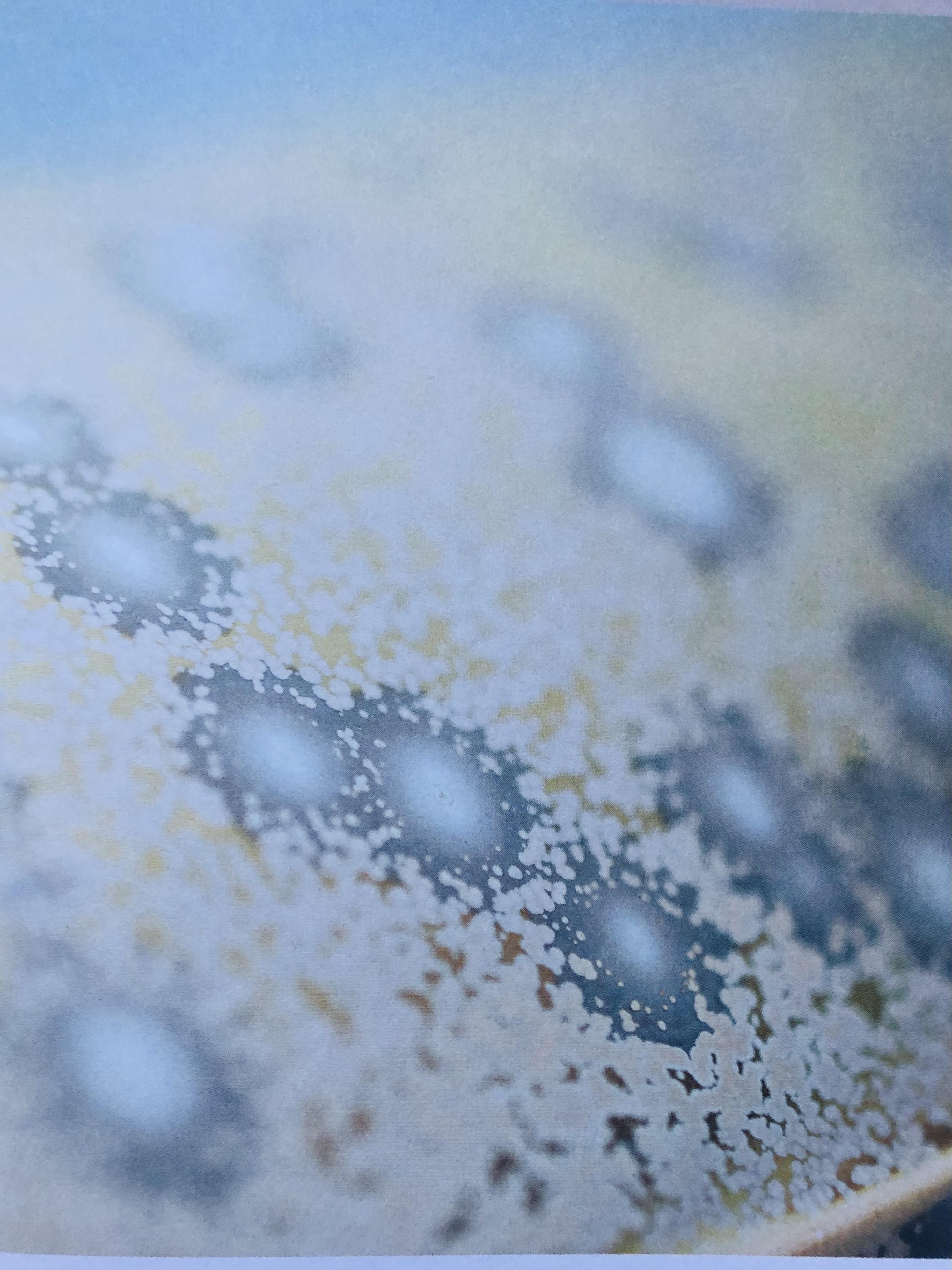

These three photos show examples of the microcrystalline effect in glazes when slow cooked giving an overall matte appearance.

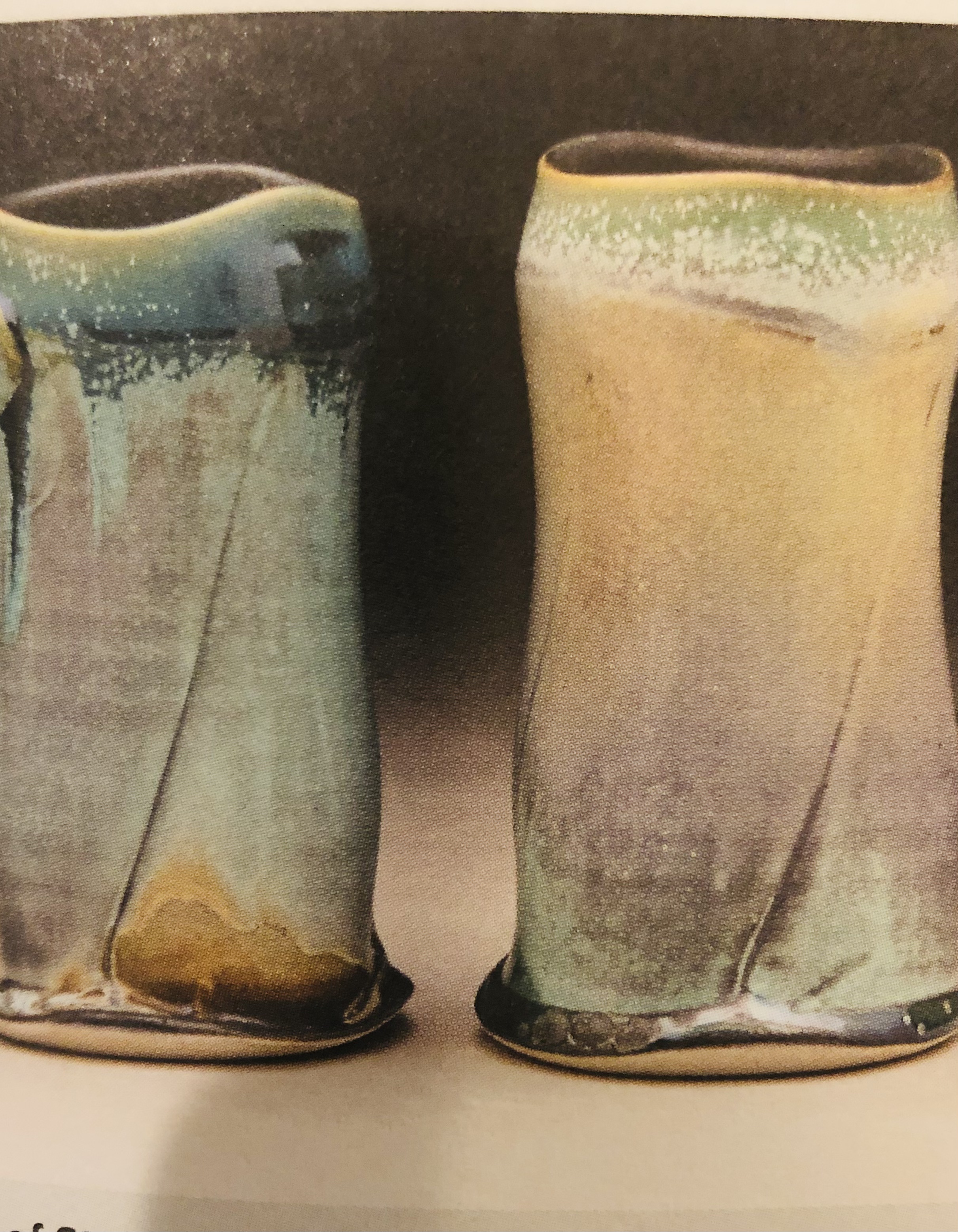

Same high-iron glaze. One crystallizes and the other does not. Why?
Both mugs have the same cone 6 oxidation high-iron (9%), high-boron, glossy glaze. Iron silicate crystals have completely invaded the surface of the one on the right, turning the near-black glossy into a yellowy matte. Why? Susceptible glazes have a temperature at which crystals form the best and that temperature can be hundreds of degrees down from the firing cone.
Slow cooling is a technique used to make cone6 glazes look good. Electric kilns are made with 2.5 - 3 inch firebrick and have less insulation when compared to standard gas kiln and are usually smaller. All in all they have less mass in terms of pieces and shelves; with less mass and thinner walls they cool more quickly. Slow cooling is a way to overcome this. It encourages crystal growth in certain types of glazes and can combat glaze defects such as pin holes and dunting. During the cooldown in the 1800-1400F temp range glazes are most often still molten. By adding holds and slowing the cooldown crystalline and calcium glazes form crystals and iron and copper glazes are returning to oxide states and the slow cooling helps to allow them to fully mature. Below 1400F is when the glazes “freeze” and they reach their final appearance.

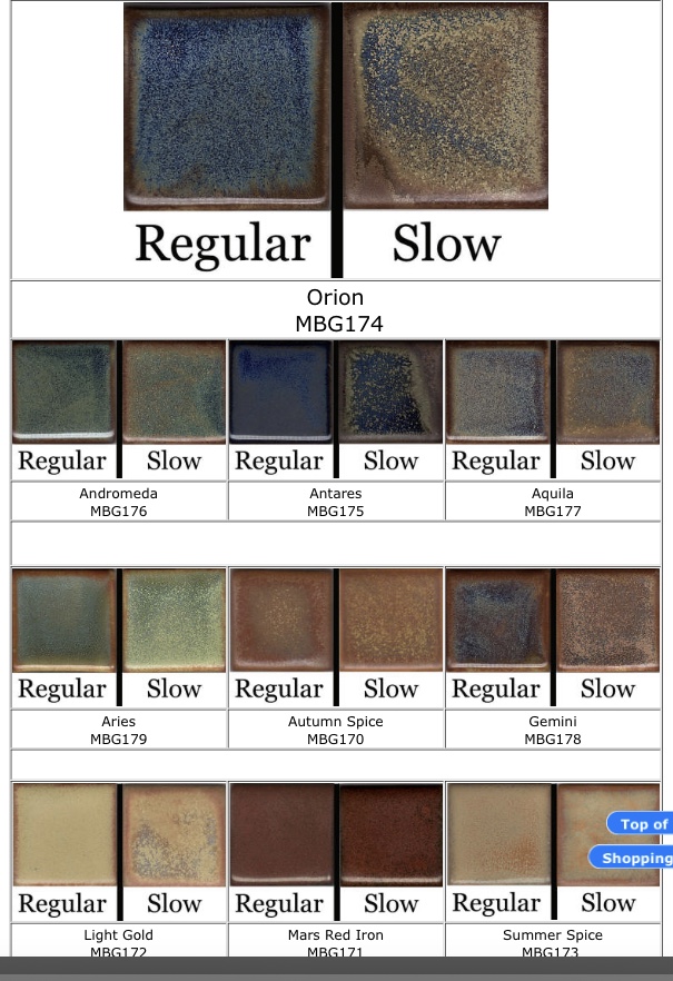

With most commercial glazes you don’t know what materials are in the glaze and therefore have no way of knowing if there will be any difference compared to a standard firing. Any glaze getting it’s color from mason stain will be unaffected, as well as underglazes, whites, blacks and clears also won’t be different. However, Coyote offers a line of glazes specifically made to take advantage of this process. Below is a chart taken from their website comparing the glazes normal run and slow cooled run side by side.

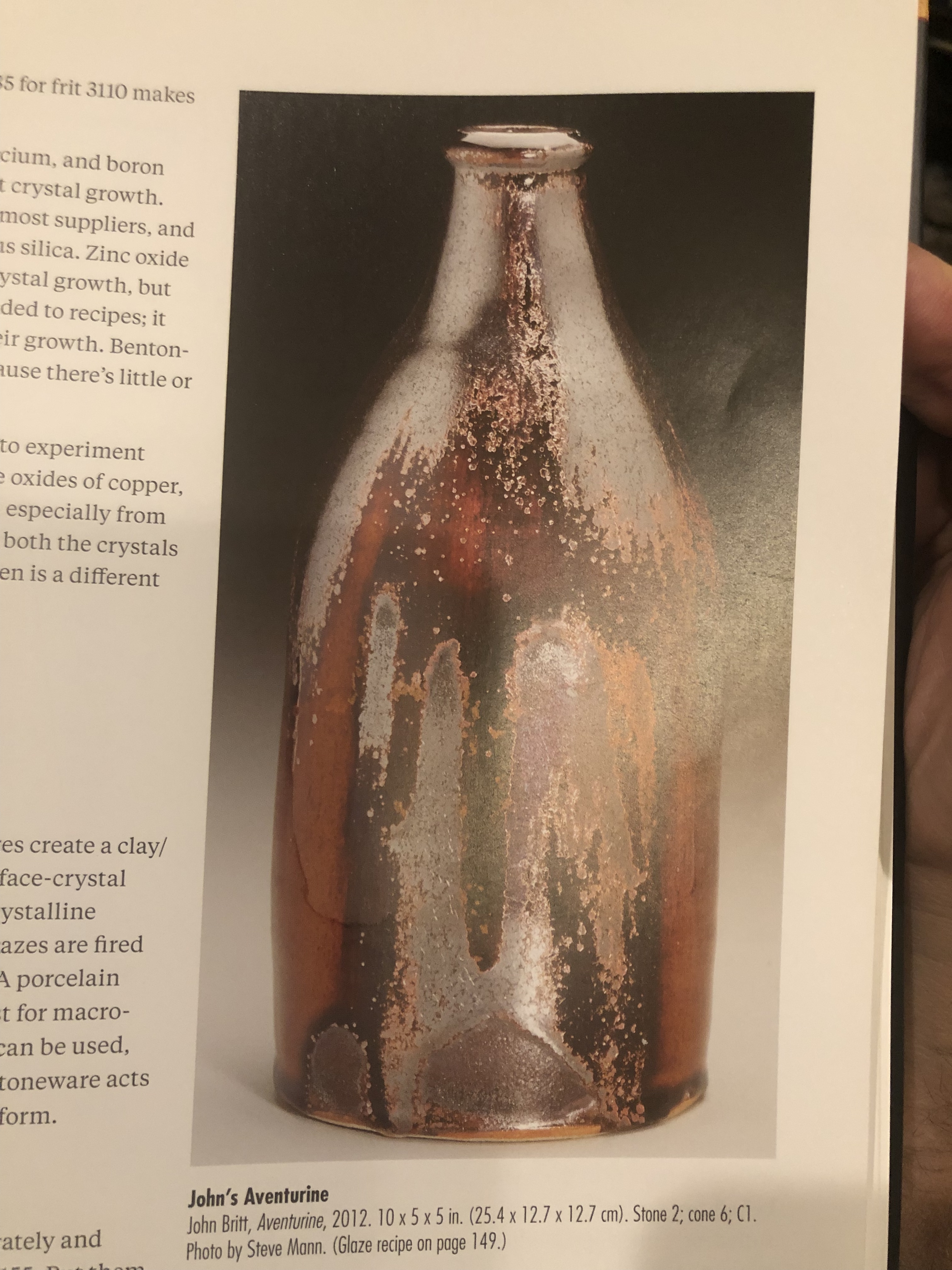

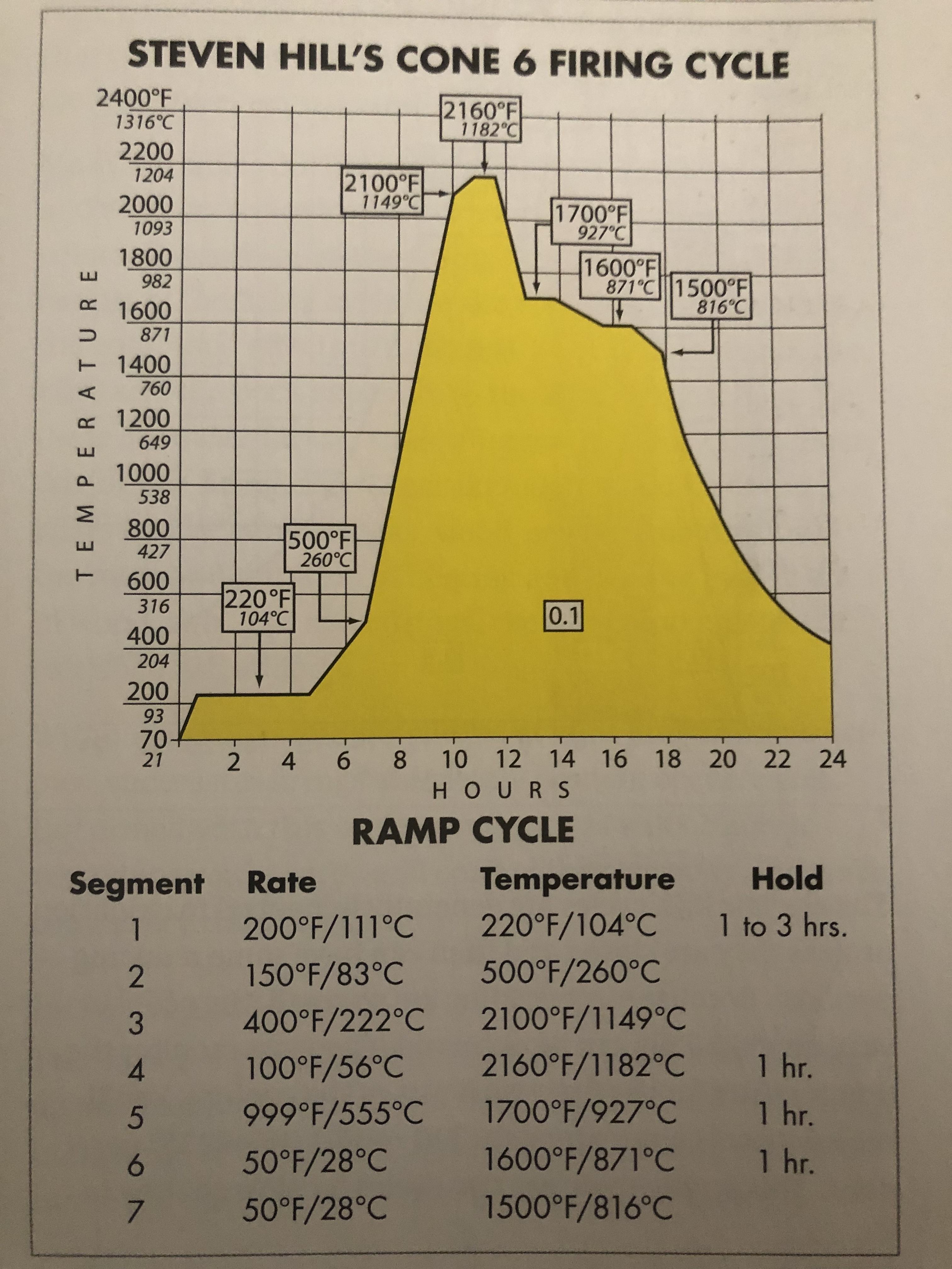

Steven Hill incorporates this technique in his works as noted in John Britt’s book on mid-range glazes. Below is the firing schedule taken from that book for reference.

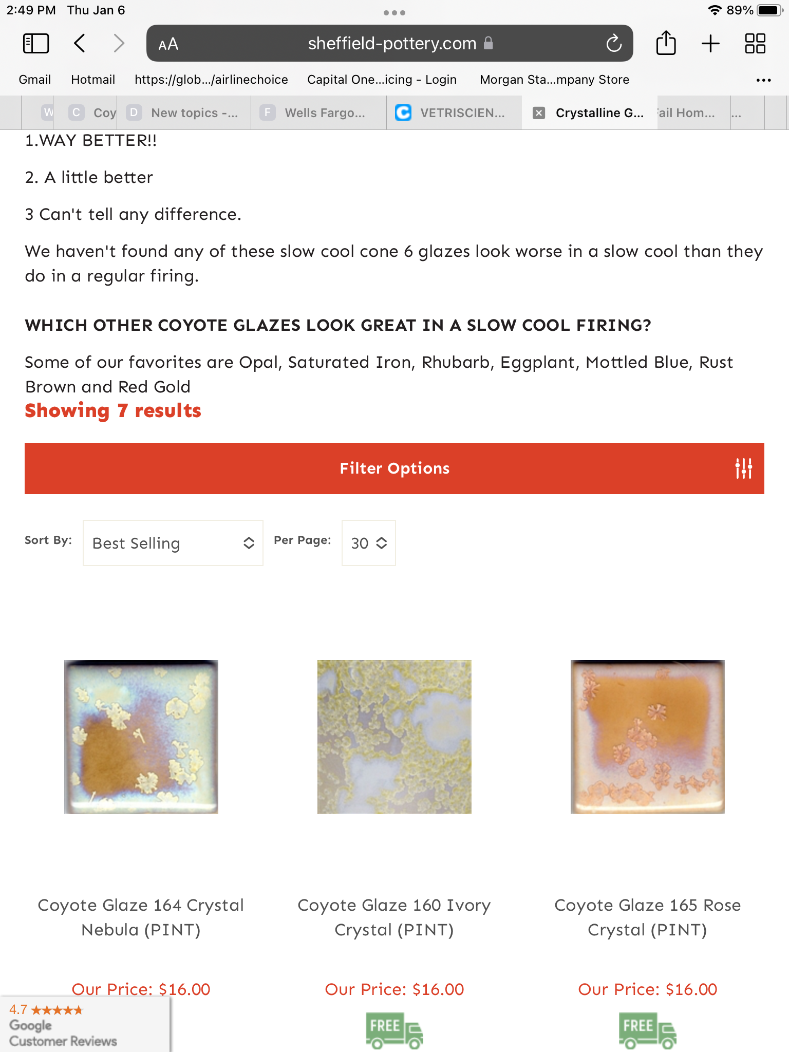

I found this information about the favorites for slow cool results.
