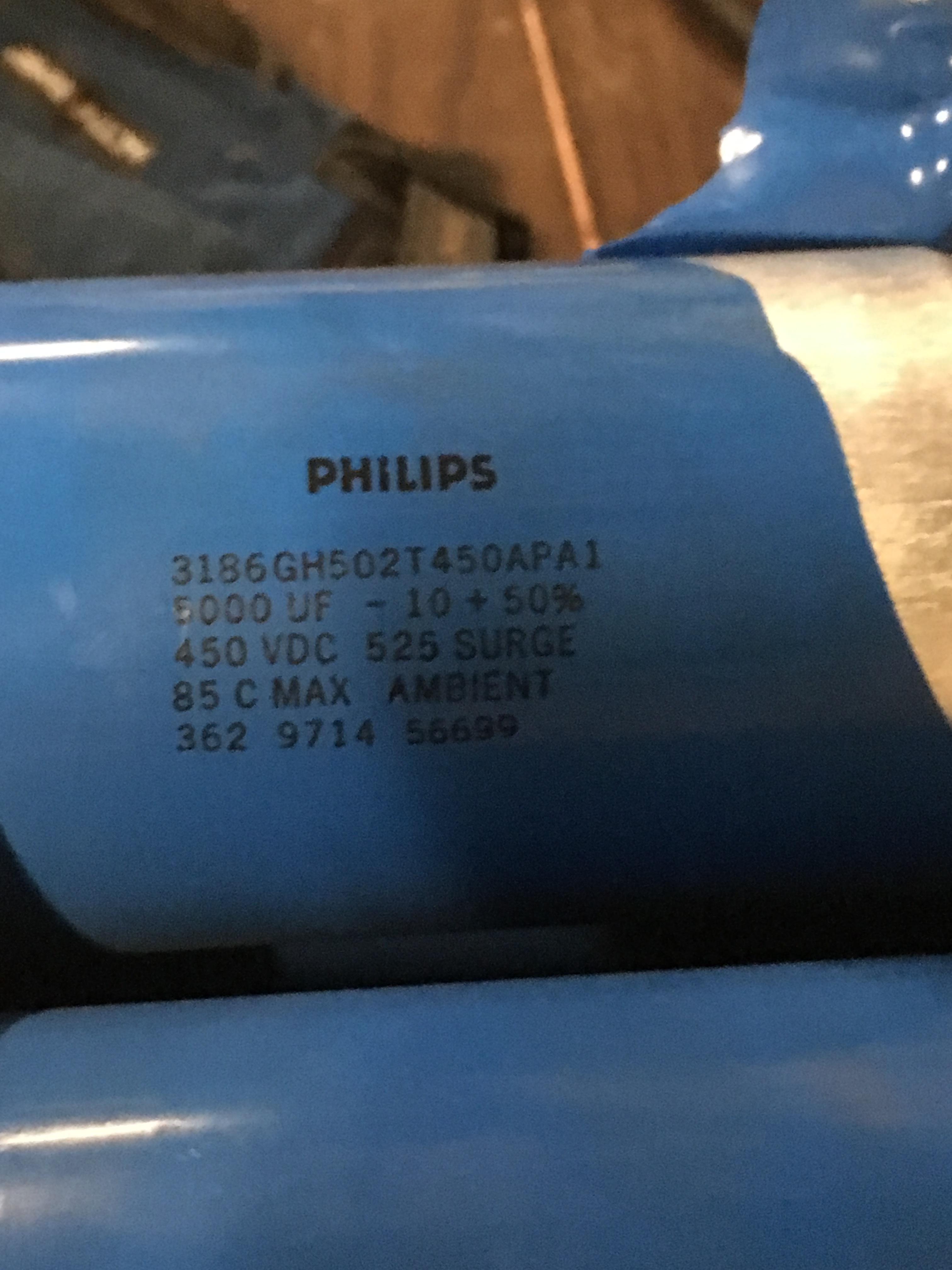

Does anyone happen to know where I/we can find some large capacitors?
The spec I’m looking for is 5000 microfarad 450v. Here is a picture of the cap. We need about 8.

Since the date code on the cap is 9714, I doubt seriously that the circuit you are servicing will be demanding on ESR or ripple ratings. Twenty years ago, you almost never saw an ESR rating.
Notice the tolerance is -10/+50, another artifact of a twenty year old blast from the past.
You might be ale to get by with 10% lower value (ie 4500uF) because stuff made today doesn’t have that sloppy a tolerance range.
You should be fine with a part that has high enough voltage rating and correct capacitance value.

You want part #: 3186GH502T450APA1

We ended finding some from an old machine someone had that they took out of Rochester. We did try to get new ones from the manufacturer, they had them on their shelf in Florida. They however were an OEM part, even though we are the OEM, they wouldn’t sell it to us. They would only would sell to our parts center, which our parts center said was 4 weeks out.
