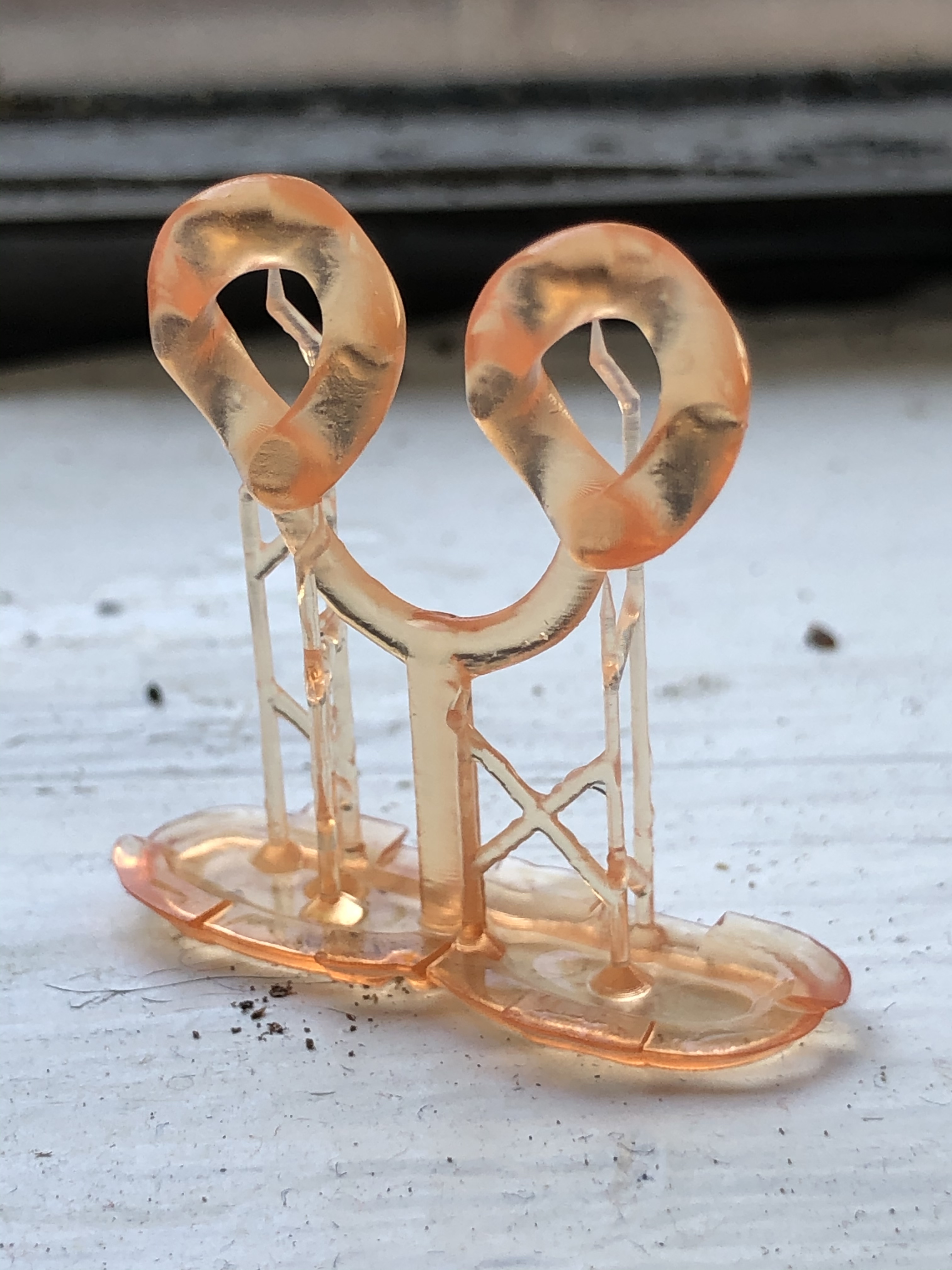

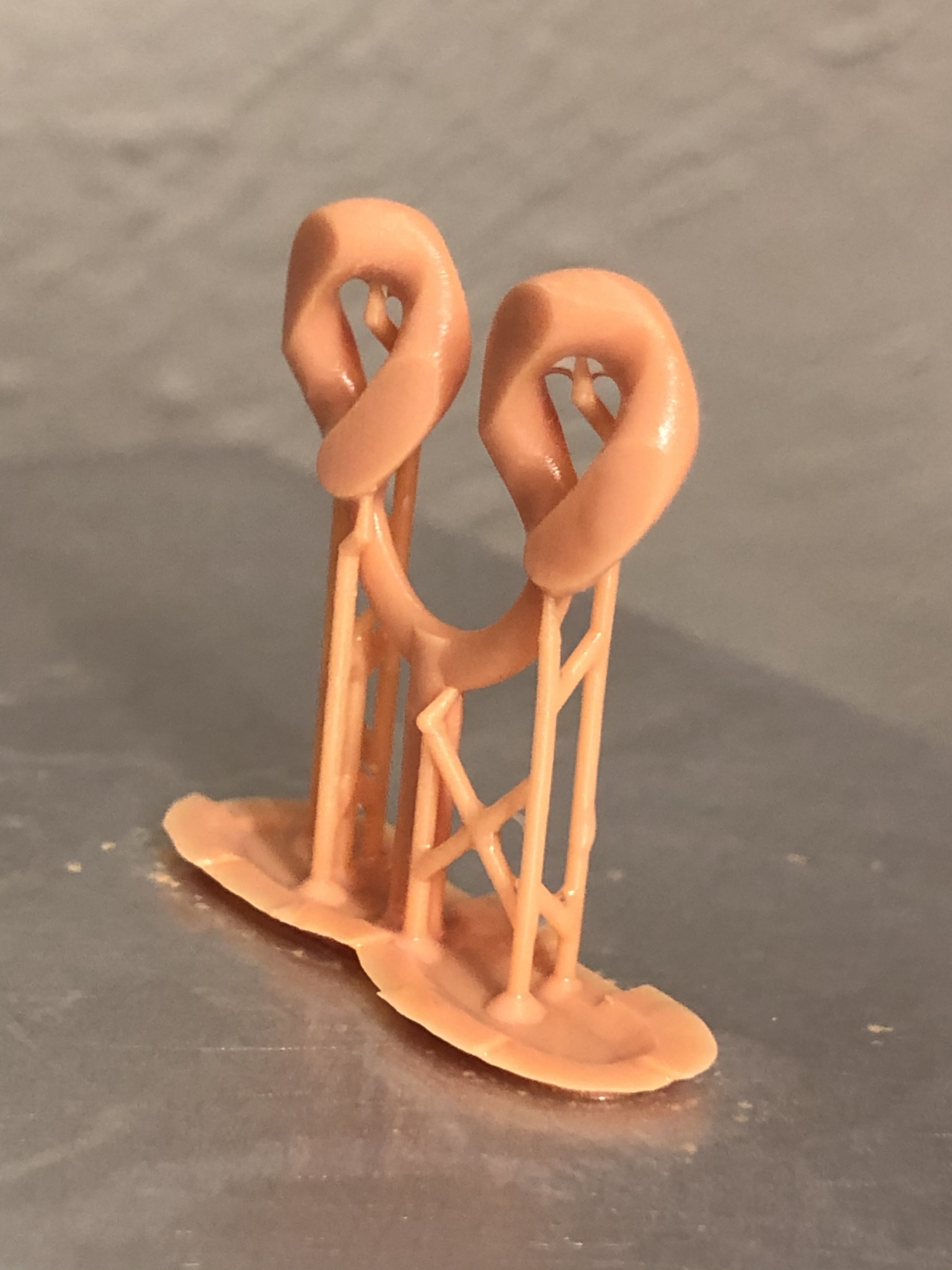

If we can keep them clean, it should be viable for jewelry lost wax casting. I have two dif versions of wax resin I’ll be testing next week. Probably a bring your own tanks resin set up for us.

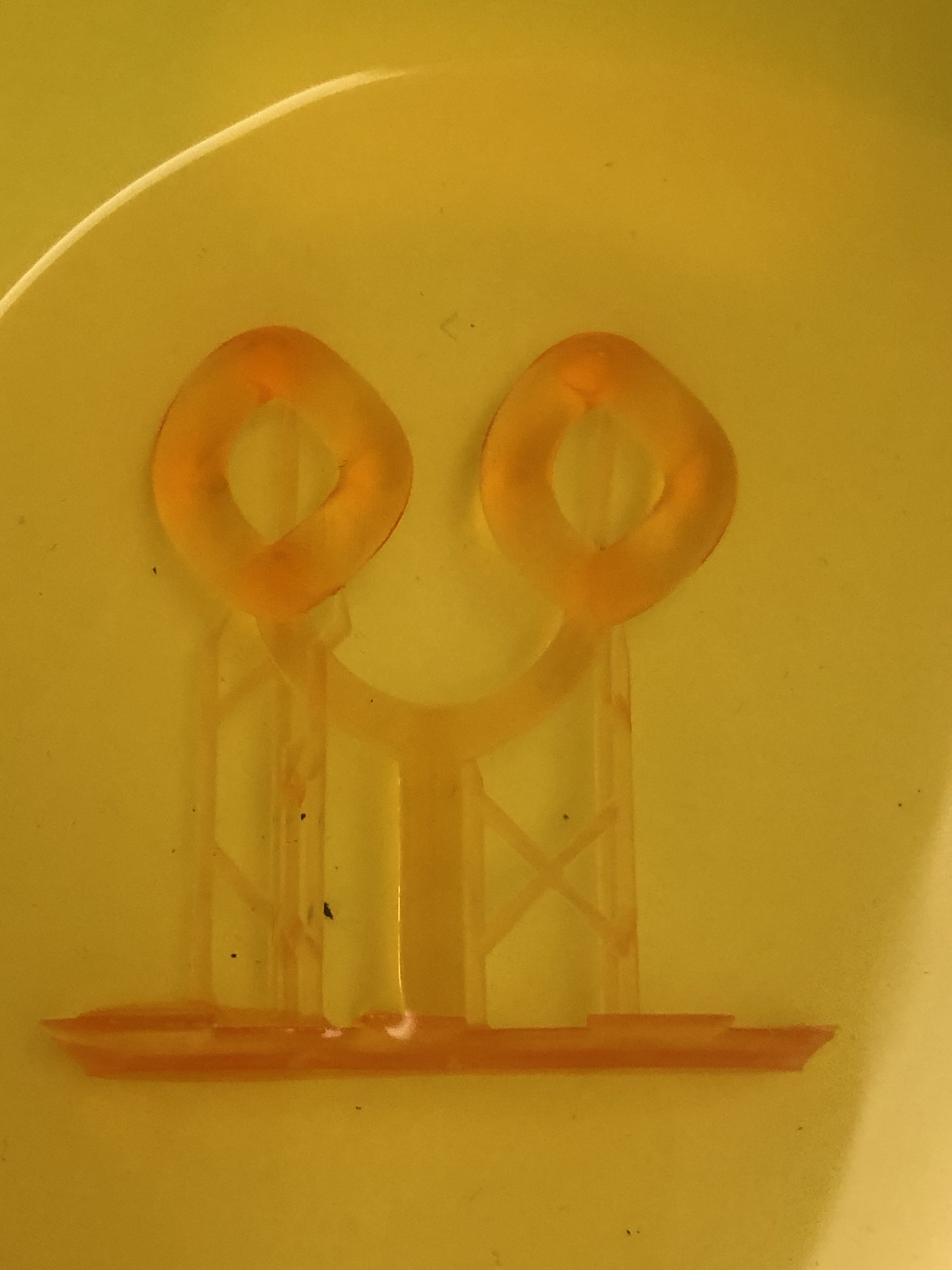

Senetek wax resin. Will test the burnout next week.
Before curing and cleanup.
Before you burn it out … Any idea how much it shrank?

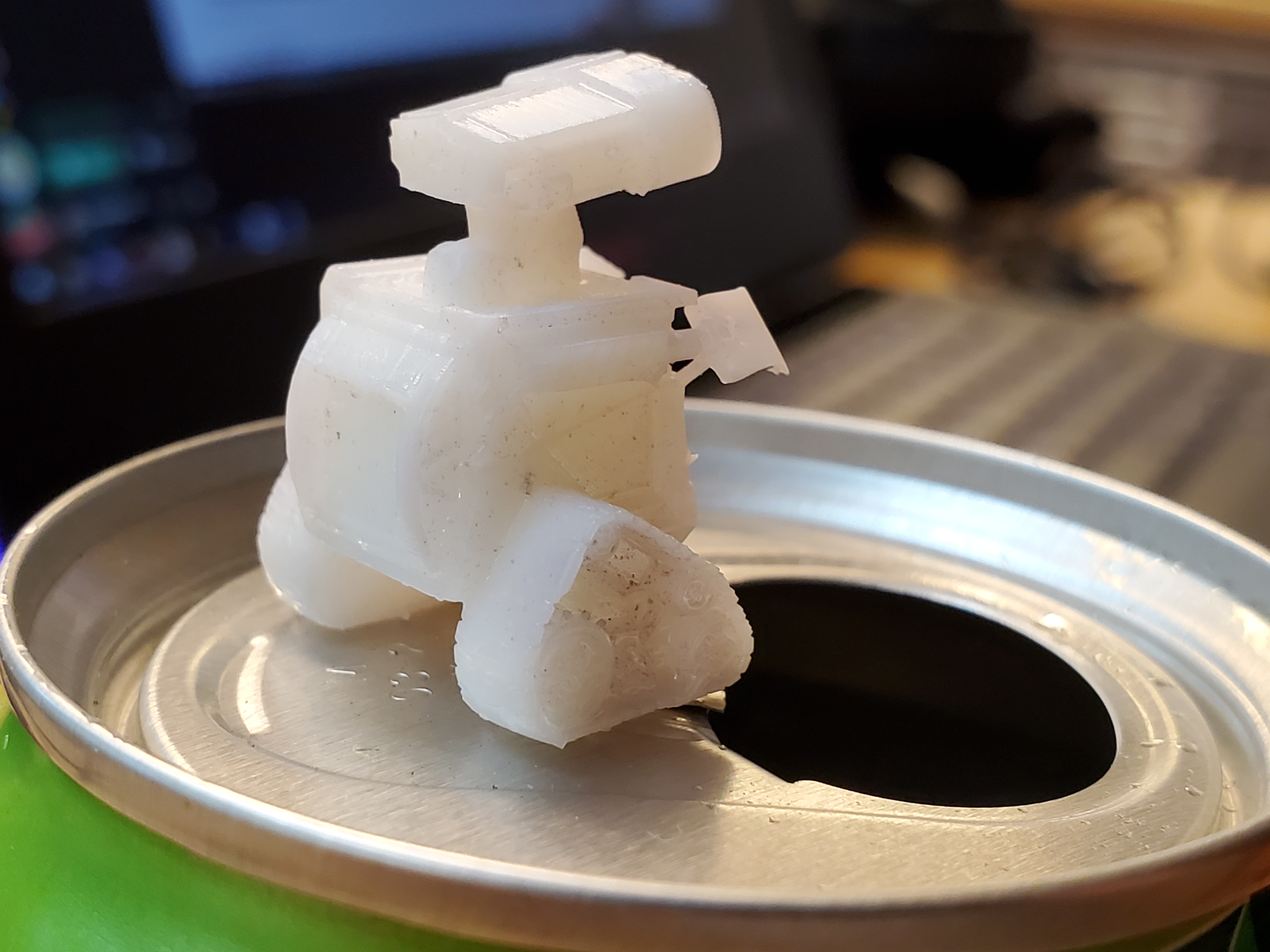

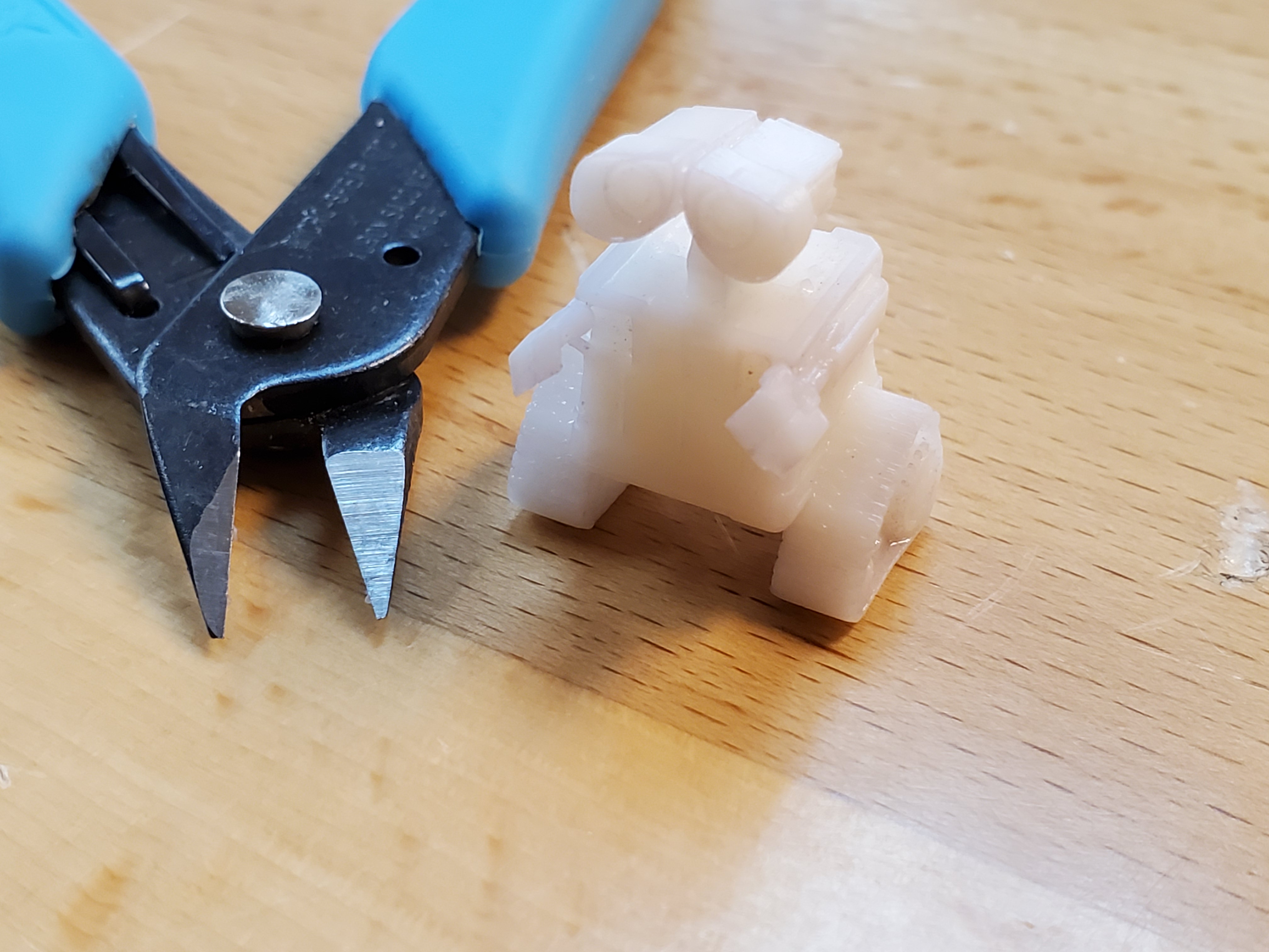

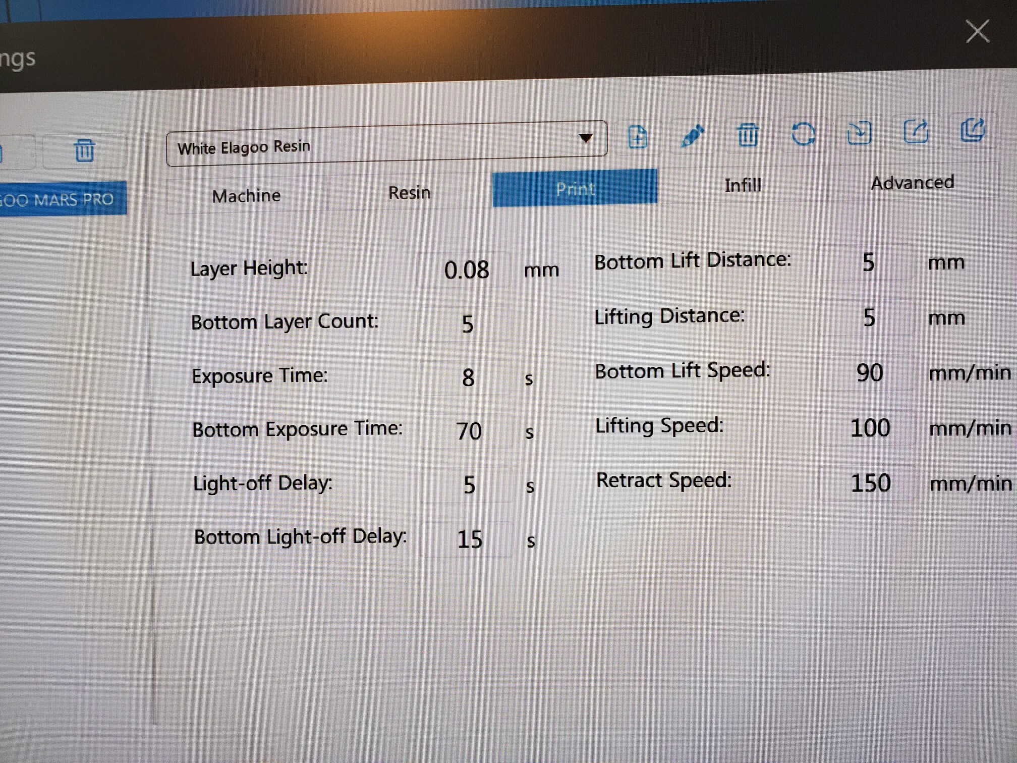

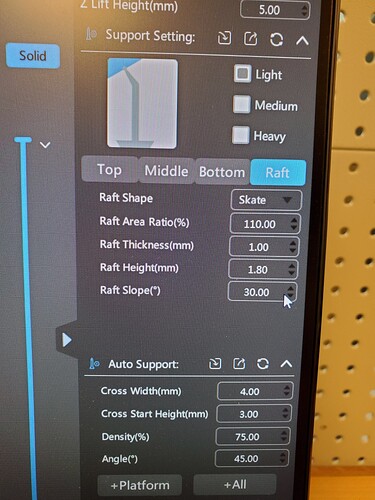

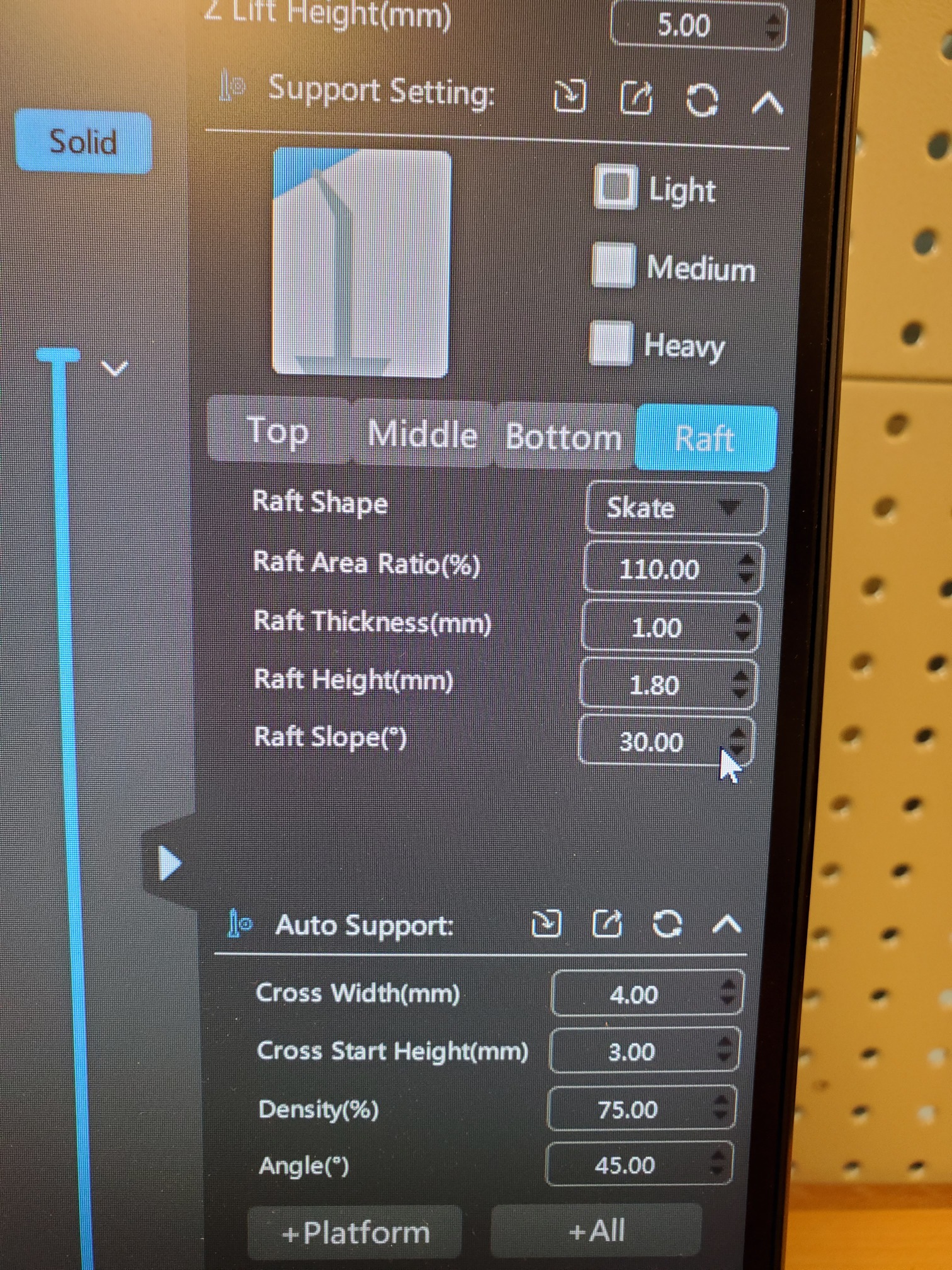

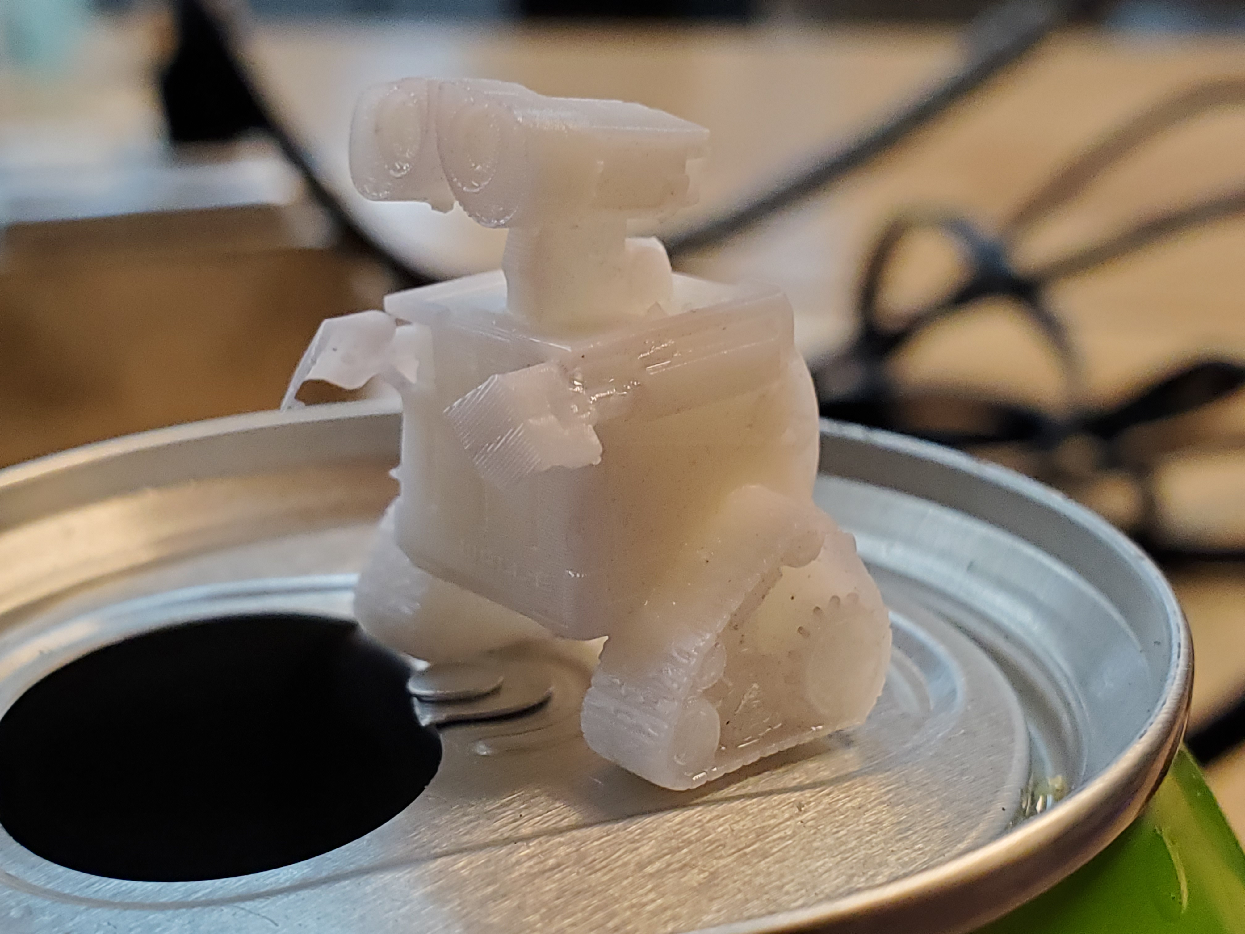

Based on previous suggestions I tried this profile and support settings. Tiny Wall-E worked pretty well 1hr 35min print time.

Is there a way to set defaults to these settings? Or possibly by resin type?
You can save them in Chitubox settings as profiles. I just use the base Elegoo Mars Pro profile, make recommended adjustments from resin companies, or suggestions. Then save as Elegoo Seketer Wax Resin Fast etc
Seems to have worked fine on my two test. I’ll bring a can up today for others to try.
Just a note, WALL-E may have come off the line a bit underdeveloped there, 0.08mm layer and 8sec? Defaults were 8sec for 0.05mm.
I ran that batch print with the light off delay at 1 sec? And bottom light off was 5 or 10. That should shave off a good chunk of time off printing as well.

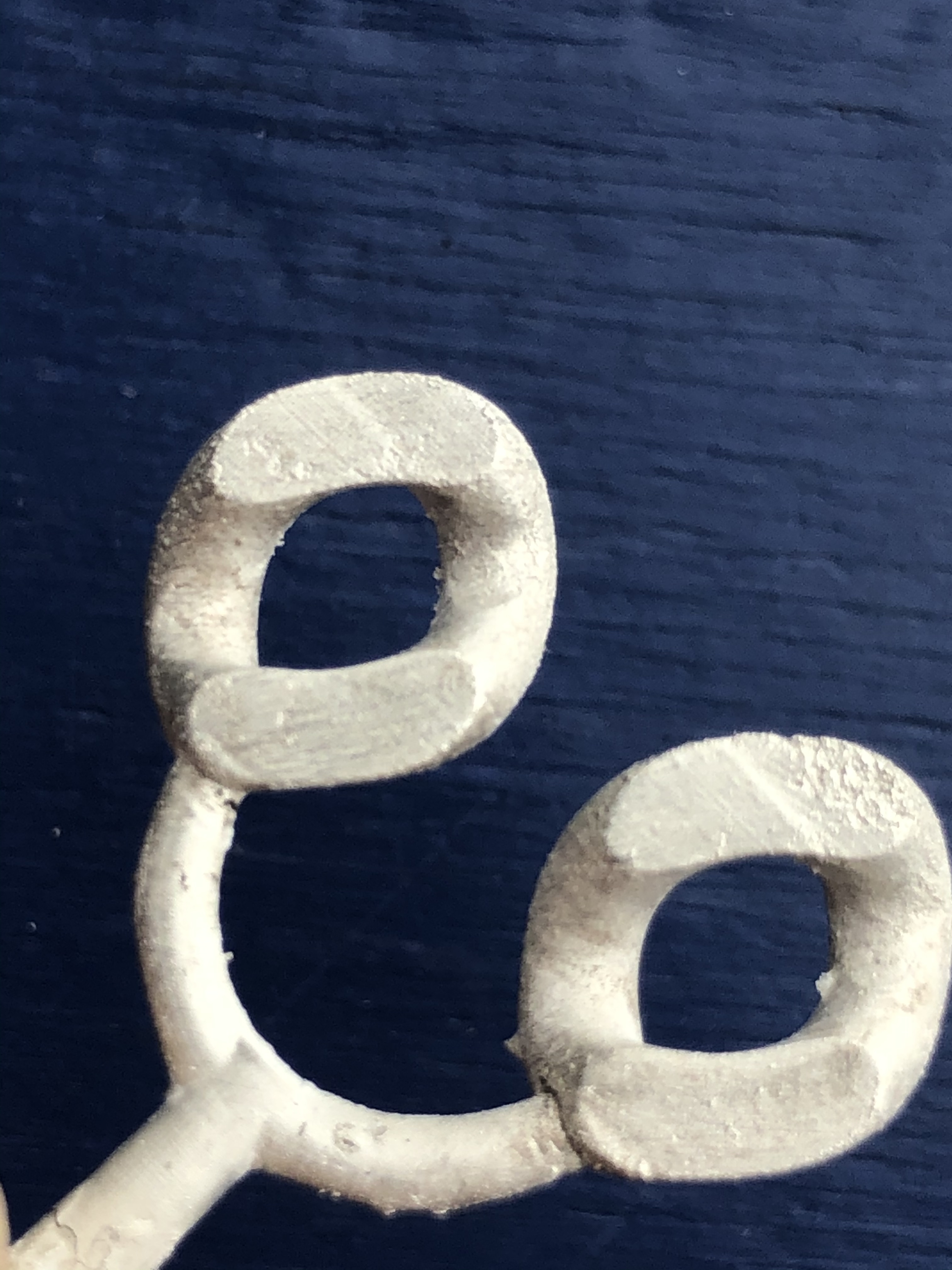

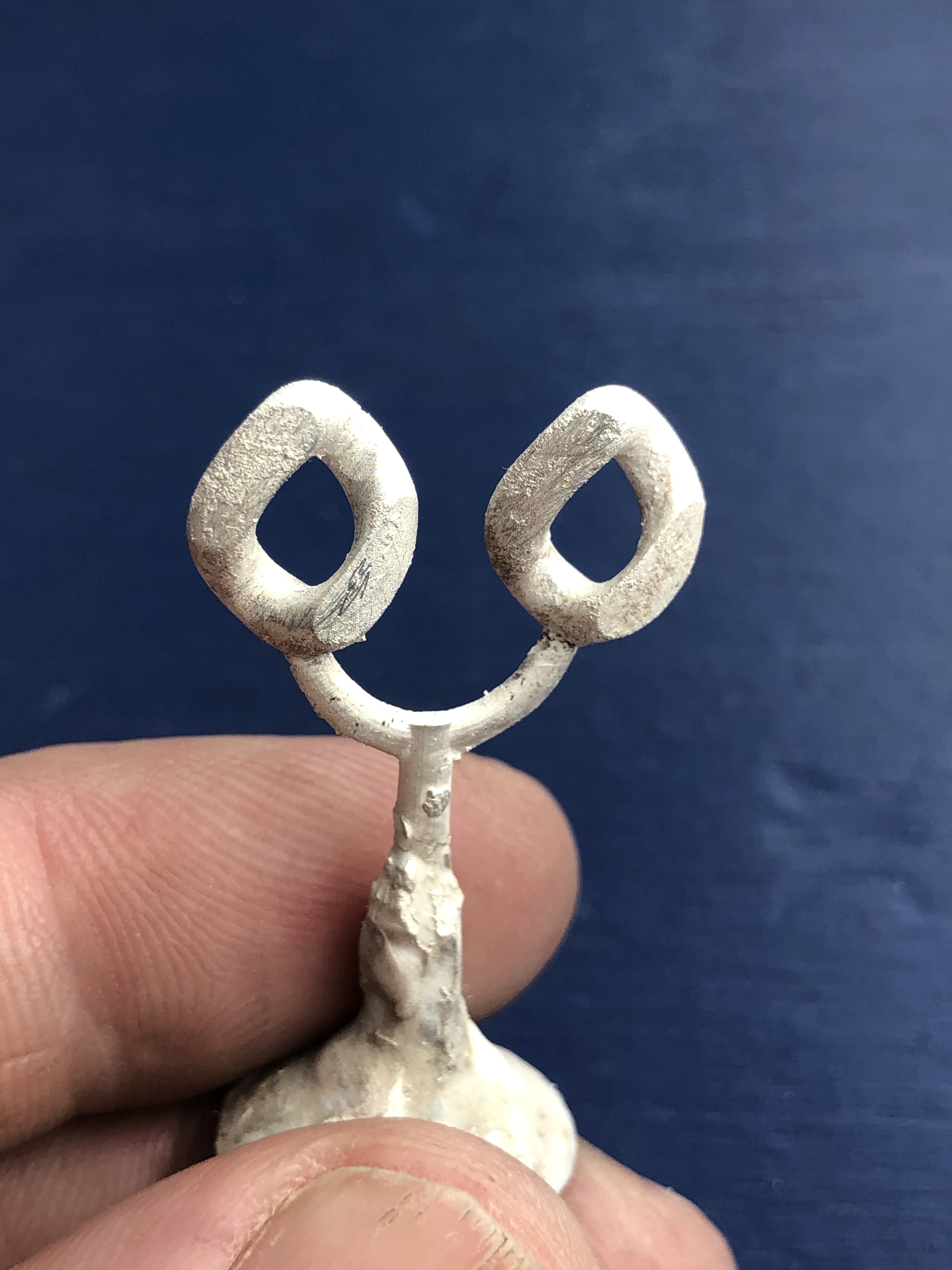

Jewelry folks ran a few test burn outs of the casting resin this weekend. No failures in both gold cast investment and plasti cast. Very affordable and viable casting ave. :raised_hands:t3:
