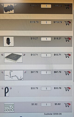

This is a pic of the cart from Rockauto. I included the liquid line/manifold assembly (2WD), & cabin filter and serpentine belt.
Total is less than $600 (but you have to add shipping & sales tax)

I stopped at NAPA yesterday. For years they had massive last-Saturday-of-the-month discounts. They recently discontinued that. Additionally, they are not stocking and are unable to get the compressor, which they listed for $755.00. However, they DO have the Condenser @ $265.00 and expansion valve $22.00. These prices reflect Veteran discount.
So I stopped at Autozone. They have the compressor @ 671.99, but not the other parts! This also price also includes Veteran’s discount.
So, I am following your advice regarding Rockauto. I will also p.m. you my VIN number.
