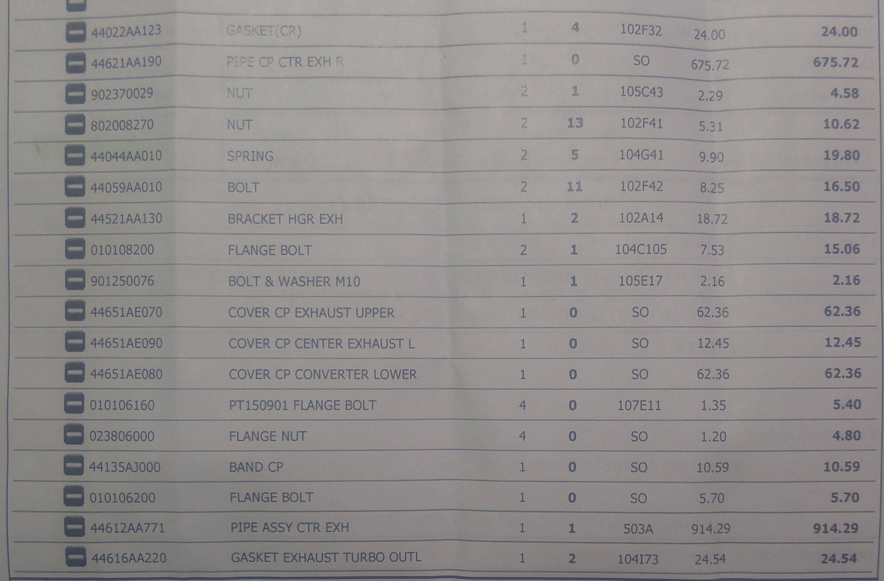

In lieu of paying north of $3,000 for Subaru to replace just the mid pipe I would rather buy an aftermarket kit and install it myself. Both as a cost cutting measure and to become more familiar with the mechanics of my car. I have attached a picture of the parts list supplied to me for just the mid-pipe assembly below. However, going aftermarket I would like to replace from the damage, back. Which I am assuming means I need more than just a typical Cat-back system. In this case is it actually a Turbo-back system system I need? Or is it a Cat-back + a catted J-pipe? Are those in-fact the same thing and I am just a dummy?
