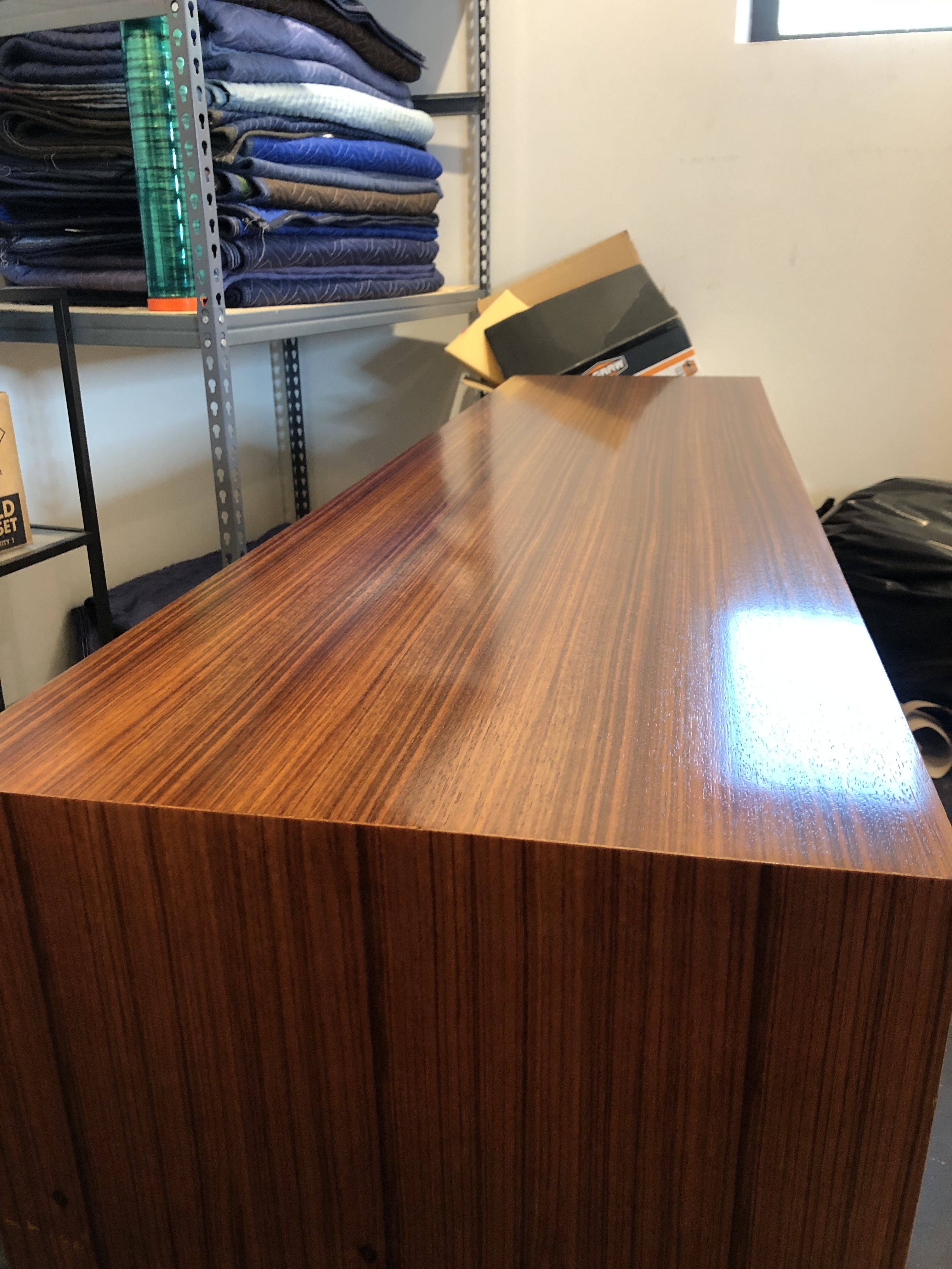

Instead of wet sanding I 00 wool between coats and then 00-000-0000 before the last coat and that gets me where I need to be for high high gloss finishes. When it comes to refinishing there’s no “one stop shop” miracle product imo EXCEPT Mohawk sells a product called “OZ” that’s a liquid polish that is incredible on lacquer. If you apply it with 0000 and wipe it off after your last layer of topcoat has dried you’ll have the nicest gloss finish, it works miracles on dull old lacquer too.
Here’s some pieces I did this way, I wish I could seal-a-cell->arm-r-seal or Rubio/Polyx everything but it takes so much longer because or color matching/curing times
