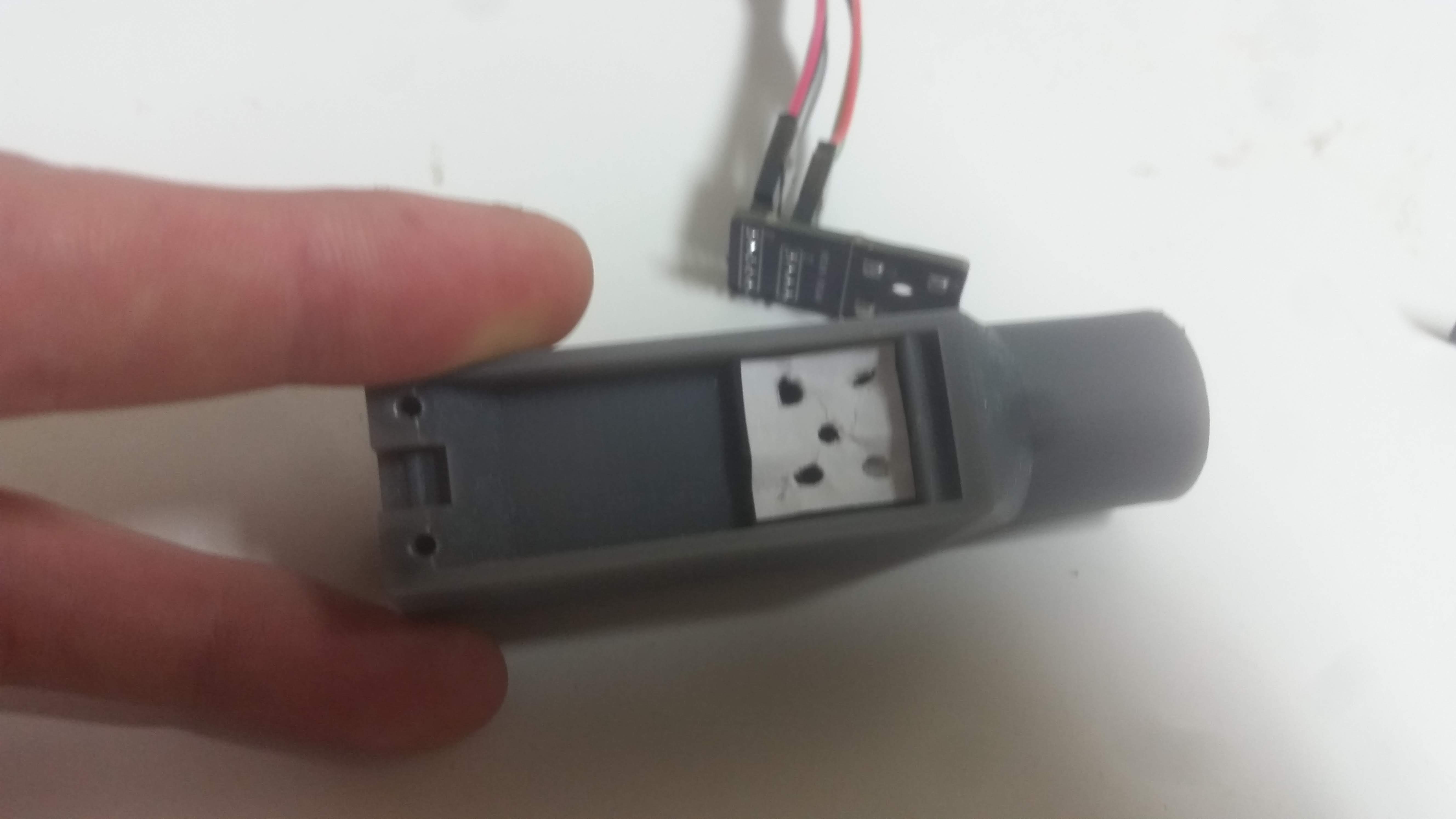

I’m building a flow and pressure sensor for open-source ventilators. It’s the one part that so far all open-source designs haven’t touched, yet it’s perhaps the one most important part that makes the difference between a helpful ventilator versus a homicidal ventilator.
It was broken out of the COSV project and modularized as the VISP project upon realizing that all ventilators need it yet none so far have it.
The novel aspect of this approach is that it uses absolute pressure sensors, which have high global availability, instead of differential pressure sensors, which are what commercial ventilators use but they have very poor instantaneous availability and that’s a serious and under-discussed problem given that we need at least a million new ventilators within just a few months.

Thanks. We have enough BMP280 for a few tens of prototypes and for now we’re still needing to prove whether absolute sensors can even stay calibrated well enough to work for a pitot tube which is technically a differential application. I’m expecting a problem with absolute drift over time between sensors and hoping it won’t be as bad as it could be. No one specifies that in the datasheet so we can only find out empirically.
I’m wondering though if the world is actually going to end up needing multiple designs that each use different sensors in case one manufacturer just isn’t able to make enough sensors in time. The pressure sensor is definitely the bottleneck part. I’m still waiting to hear from Bosch on a lead time for 200,000 units but I went with BMP280 for now because they already have tens of thousands in stock distributed around the world and there are at least two other parts that fit the same footprint including a (gasp) chinese clone that happens to have high availability.
