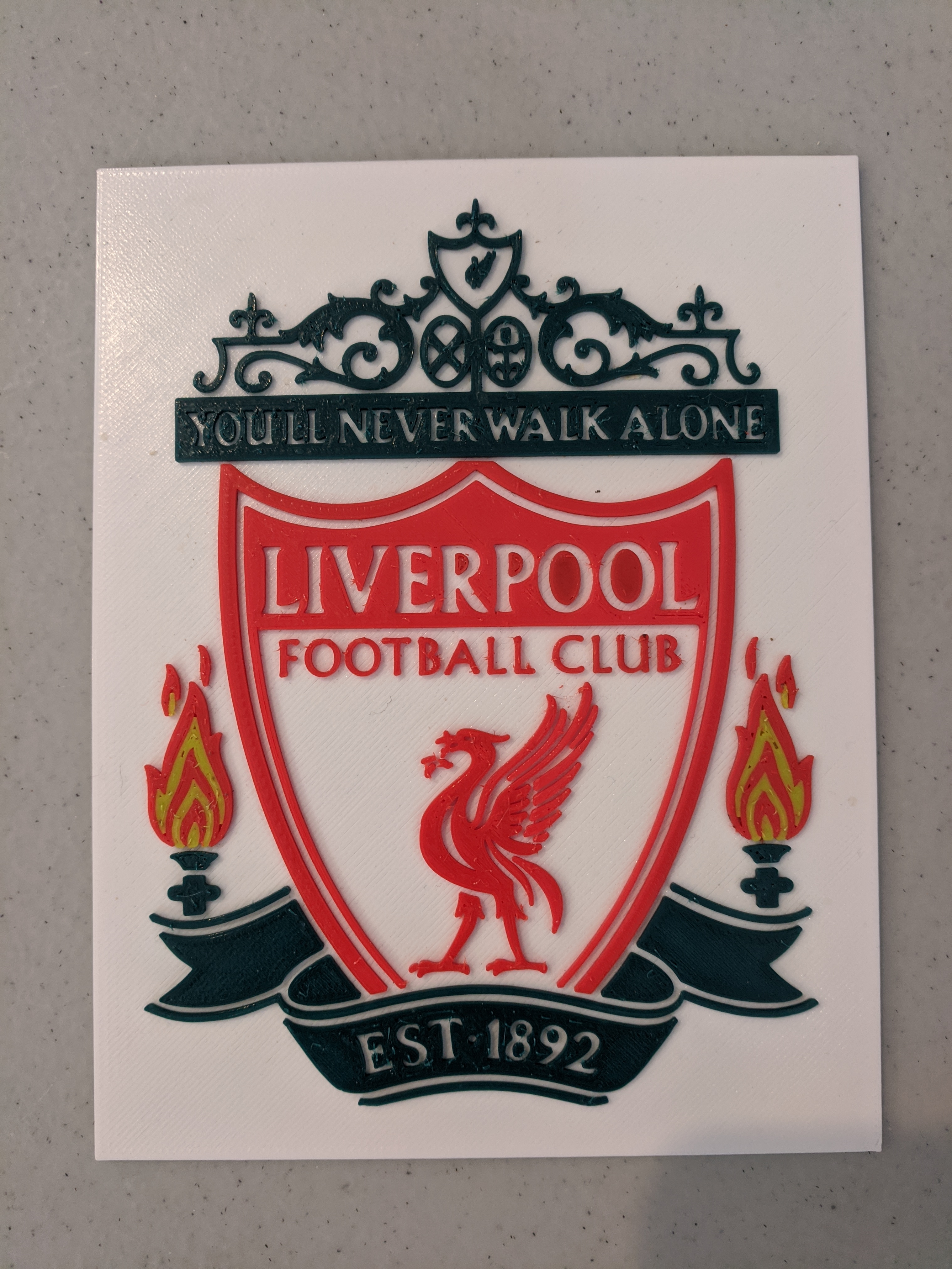

The color wiping sometimes takes a lot more purging than the default settings too. For instance if you look at this:
you can tell the yellow parts still have some green filament in them (the red was just the lousy color of the filament, needs to be darker for sure in this context).

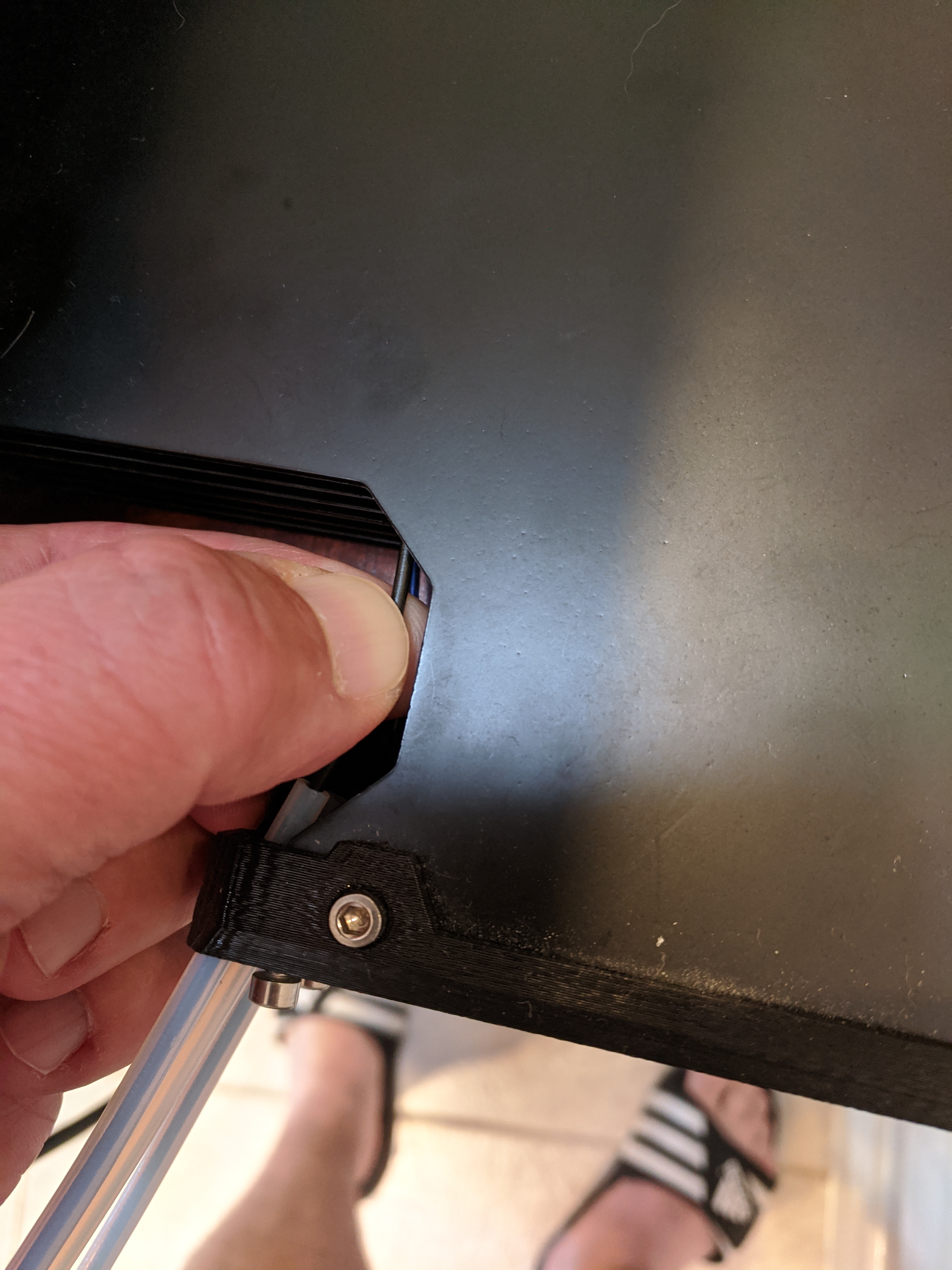

One thing I need to do is also some sort of auto rollback filament spool setup. The filament buffer that comes with the MMU2 kit is kinda a PITA. To actually load filament, your thumb and pointer finger grab the filament and push it towards the MMU2. With the way the buffer works, you can move it about a half an inch at a time, and it’s annoying. This comes back to me needing to build some auto rewind spools (there are lots of designs out there), but you can maybe see what I mean in this picture:
The buffer and spools also take up a lot of real estate on your table and you lose a lot of mobility in general with your printer. Transporting it safely mostly requires loosening screws and removing tubes etc. When it was just a MK3, I could seatbelt it in and take it elsewhere :smile:
The Red PLA+ from Microcenter was a lighter color than I wanted. True Red was darker and I like it much better.
Thanks for the info, that’s a nice print, btw.
