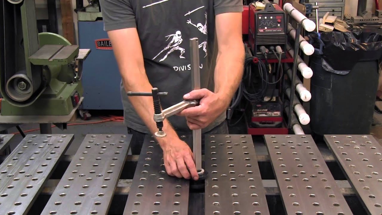

One day I would hope that we could get these welding/fixture tables. I like the fact that they boast .0015 flatness tolerance, they have slots so you can use traditional clamps & all the ball lock holes for all the other fixtures. You can also get a tubing notcher for it as well. In reality it would probably get tore up & the clamps lost.

We had some discussion today in the Metal Shop meeting about tables.
Most of us liked the thought of a table like this.
http://www.buildprotables.com/tables/slotted_6.5x4.php
The idea is that it covers many areas.
  1. Allows use of standard clamps
  2. Allows use of jig clamps of standard issue
  3. If one or 2 sections of table are destroyed they can be easily replaced. The user that destroys it would be ultimately held responsible for the replacement.
  4. Allow for larger fixuring.
