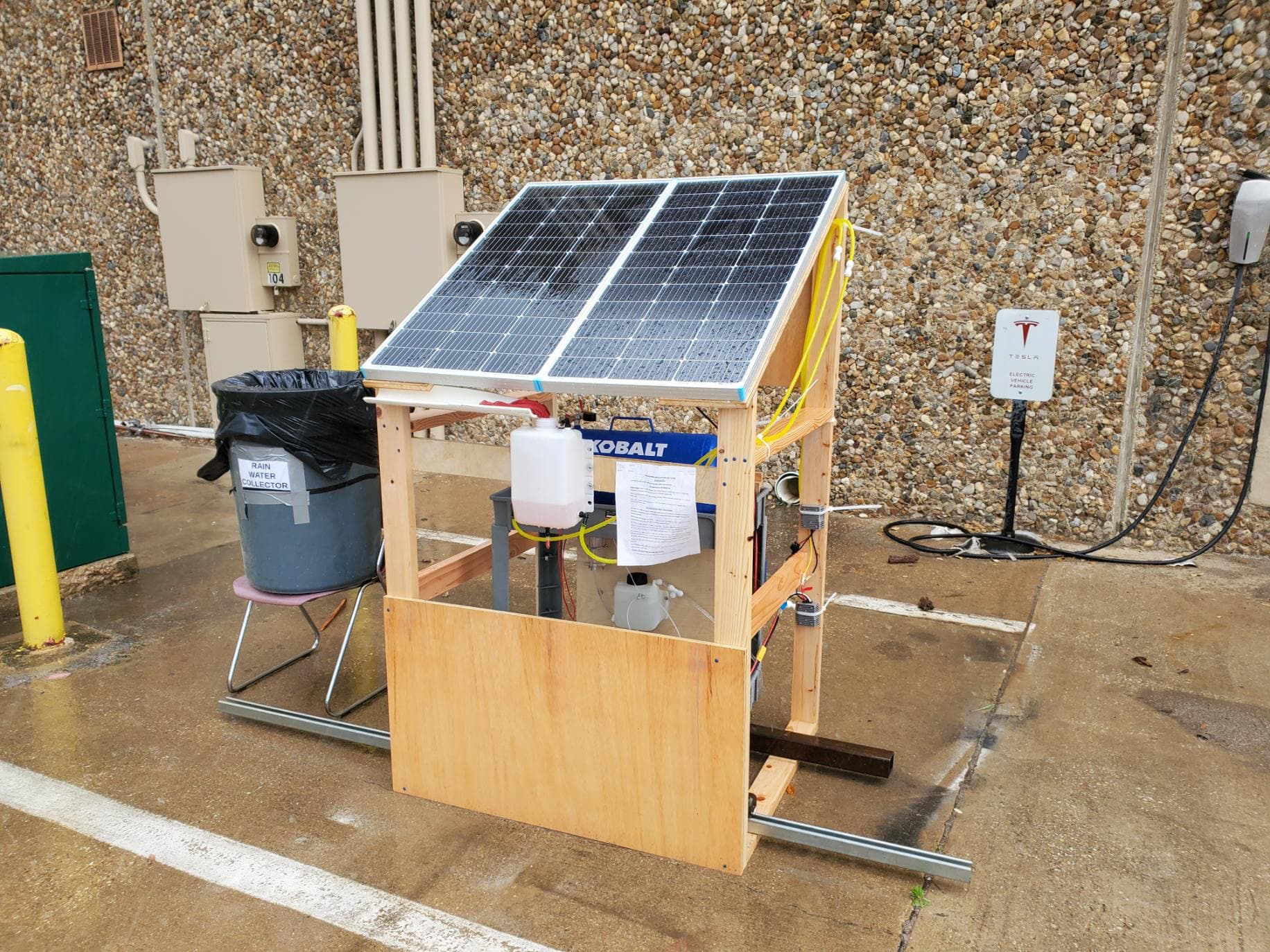

John got us connected with the board to see which days we’re good for a fill-n-launch in the parking lot. Possible days would be this Wednesday or next week Tuesday, Wednesday, and/or Thursday.
The pressure sensor doesn’t have to be hydrogen necessarily. It’s more to protect the PEM from damage. So something like if: pressure > 80psi in the tank then: disconnect solar circuit

Looks like it will be a bit too cloudy and windy to get enough sun on the panels today.
Let’s shoot for Tuesday of next week. There’s a good chance of rain Monday and the rainwater system should be functional well before then.
First rain. With help from Taylor and Purnie, it’s sitting outside Woodshop bay doors the next couple days.

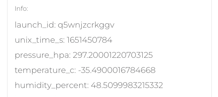

About 70 minutes into flight it reached minimum pressure of 297 millibars or about 30,200 feet . Last packet received near Wylie, Texas shortly after.
