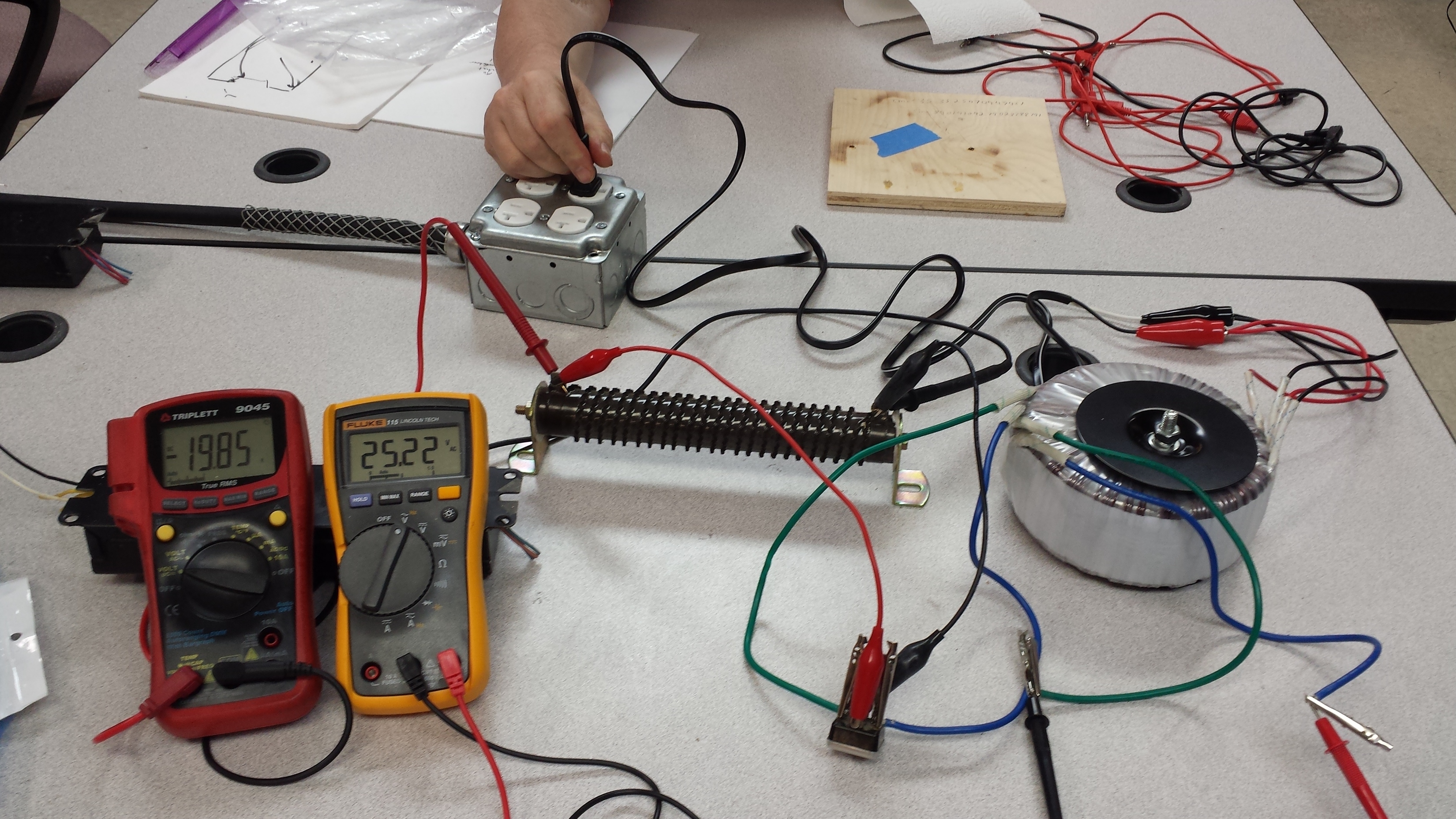

Load testing Walter’s 500w toroid transformer. 2x 25v 10a. Load resistor is 1.6 ohm 300w

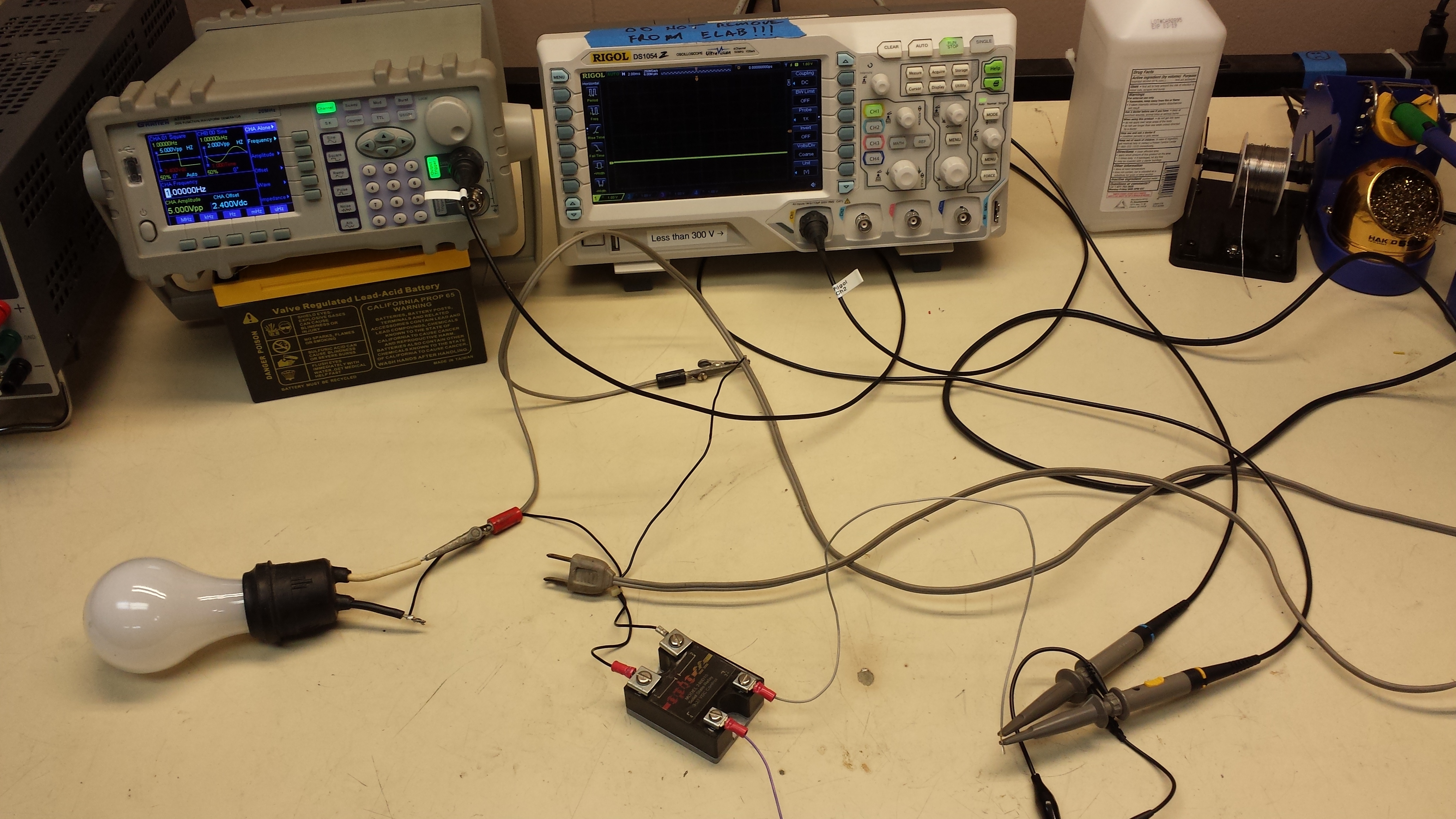

SSR (solid state relay) test. Replace sig gen w/ arduino and control up to 1kw ac. QED.
