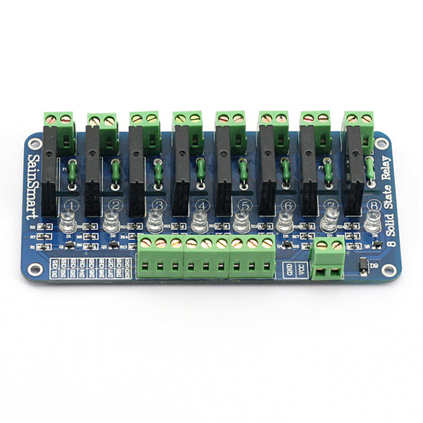

I probably should use this one instead since it has solid state relays with built in snubbers?
good for a/c resistive loads, not inductive loads
that’s even more good to know. Been looking to do some really interesting things with node-red, scada hacking and 3d printing. Love that the elegoo has a din rail mount on thingaverse (https://www.thingiverse.com/thing:4264897) but that 8-channel one looks interesting and might be easy to mount as well.
