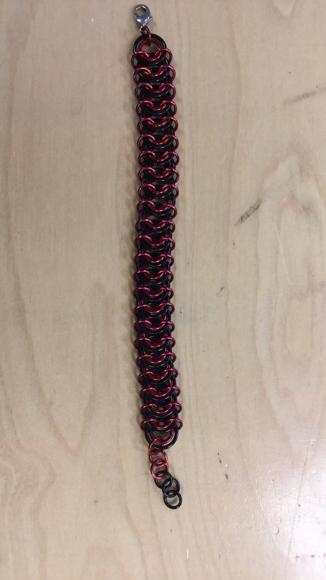

It was such a fun class! Here’s how my bracelet turned out.

Your bracelet is awesome…and love the cat.
