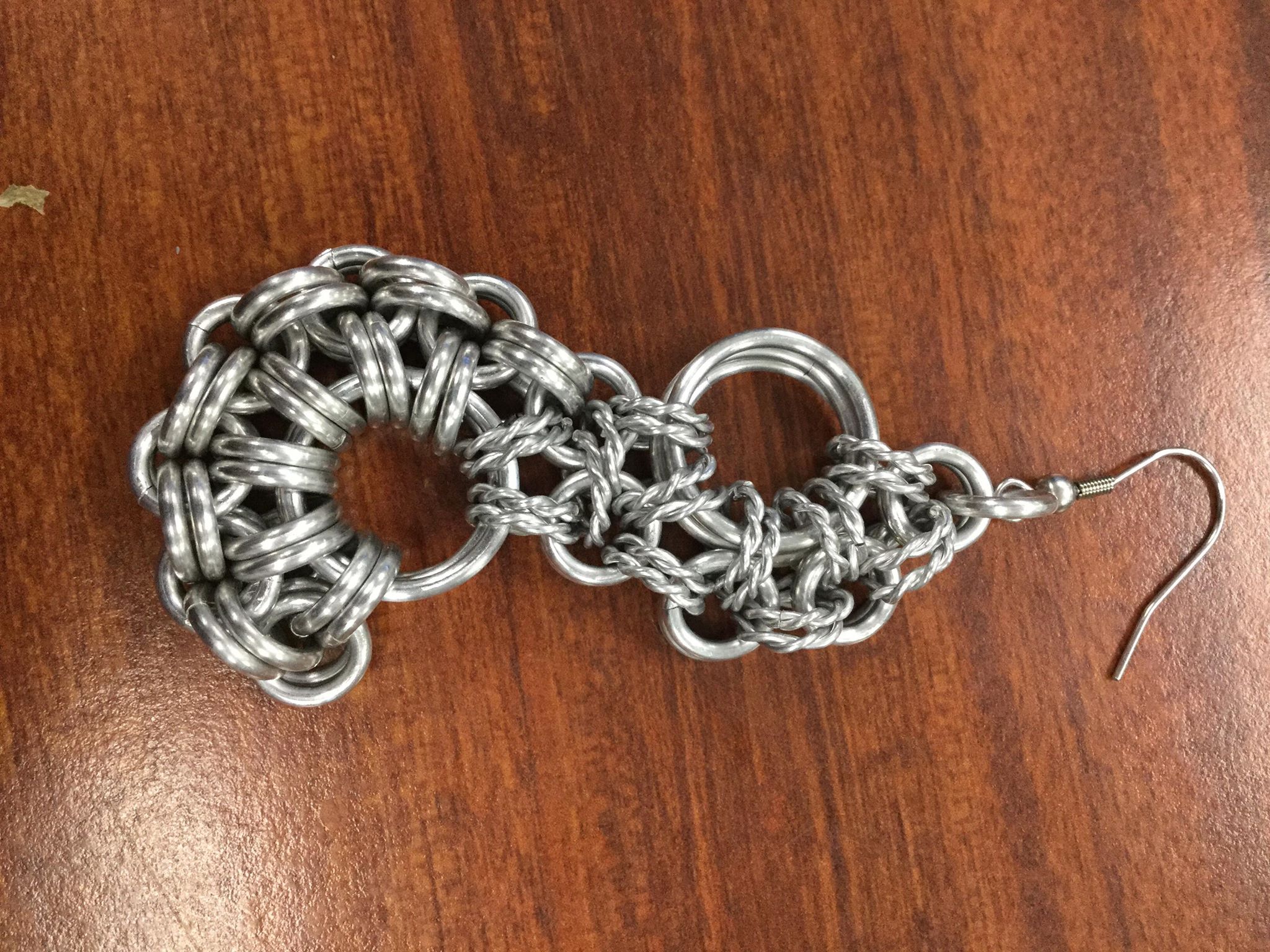

well folks ive got our earring kits for the next class and ive already made one to show off both types of rings i got for this (pics hopefully attached below) its not the best but its enough to show you how to go about it and cheap enough that the normal recommended $2 donation should cover it what im really excited about is to see how well the butterflies turn out as our first advanced project of 2019 i got us some rings and some lapis beads for the wing captures and again it turned out fairly cheap and will also only be $2 (i have ordered the parts but they are not here yet so no pics of this one yet) unfortunately im just about to start getting ready for work so i dont have time to go into detail on ring sizes and such but ill get them up asap for both projects
Ok so due to random cosmic spite I find my computer to be largely unreliable but I am determined to get the info out there so hold tight while I try to get this done with an iPod
Unless otherwise stated all rings for this project are saw cut Bright Aluminum (BA)
First up for the serpentine earring pictured above:
-16g swg 1/2”
-16g swg 7/32”
-Twisted rings are 16g 7/32” equivalent made from twisted 20g wire with a saw cut finish the item code for this product on the TRL website is “SXAB-TWIST16732” IMPORTANT NOTE: the twisted rings ended up feeling very flimsy the ends didn’t always match up leaving unavoidable burrs and in general being strange to work with I do NOT recommend their use for both practical and aesthetic reasons however they will be available
-French hooks are recommended but not required
Additional info:
These rings are larger and thicker than we normally work with so it wouldn’t be a bad idea to bring heavier than normal pliers if you have them just to see the difference if nothing else aspect ratios and how I chose these rings will be discussed in class and I intend to ask attendees how they would modify this design for different ring sizes and looks additionally all listed parts for this were obtained from theringlord.com (TRL) so any color substitutions should be ordered from there to maintain quality as much as possible for both structural and aesthetic reasons

hi all we have had another swell class!!! we made the serpentine earrings pictured above, another weave that i cant remember the name of at present (but ill look it up and get back to you in the mean time its hopefully pictured below), and discussed modifying the designs and how i chose the ring sizes and all sorts of things that the folk that didn’t attend missed. we even got to use the new tools for the first time (SQUEE!!!). I’m told it was a massive improvement and really increased the quality of the class. i also really liked how the conversation went on modification and planning and i think i will be incorporating that to future classes (so plan accordingly BAWAHAHAHAHAHAHA!!!). In addition, since no one was in our room when i got there, i was able to set up better than usual and do a much better visual aid. i don’t know if i will always be able to do that, but it seemed to work well. I’m gonna try and make that a more regular feature of the class but we shall see how it goes.

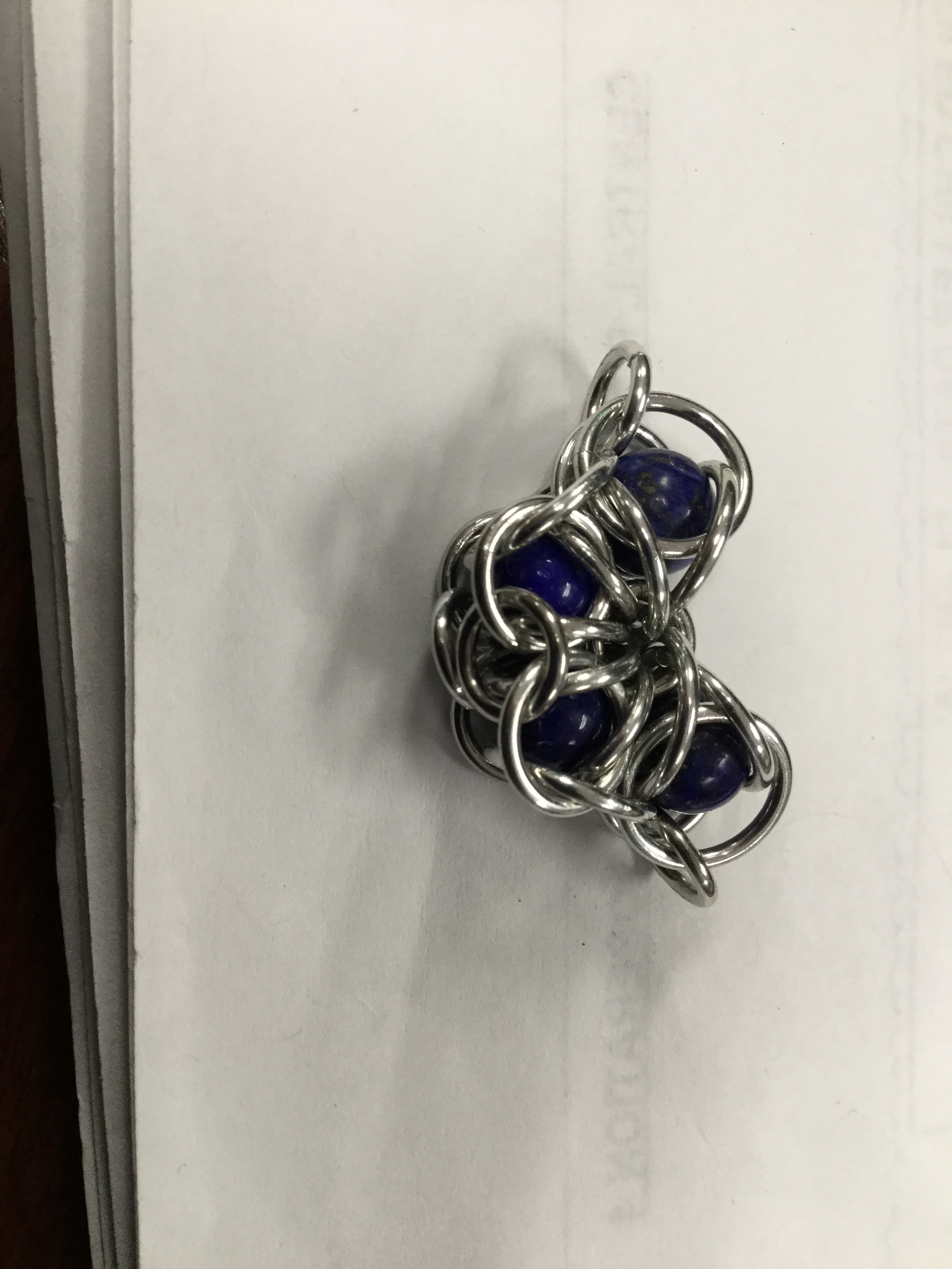

Ok so here’s the latest: there is only going to be one class in January. it’s going to be 25JAN19 and I will bring limited supplies (2-5 kits) what follows will be a pic of my finished product from the supplies I have and then later when I get home I’ll schedule the class and work up the parts list
beautiful work Tony!
ok folks sorry for the wait here is the parts list and notes i promised from creating the butterfly pendant pictured above.
!! the supplier for these parts was CandTDesigns.com and all rings are 18g SWG saw cut bright aluminium rings unless otherwise noted !!
3/16" X2 (hanging rings you would attach the necklace chain to)
Actual wire diameter .048", 1.22mm
Wire gauge 18 (SWG)
Actual ID inches .190"
Actual ID mm 4.83
Aspect Ratio 3.96
5/16" X10 (8 for the 8mm bead capture + 2 connecting rings)
Wire gauge 18 (SWG)
Actual ID inches .315"
Actual ID mm 8.02
Aspect Ratio 6.56
1/4" X9 (8 for the 6mm bead capture + 1 connecting ring)
Wire gauge 18 (SWG)
Actual ID inches .254"
Actual ID mm 6.45
Aspect Ratio 5.29
11/64" X2 (center ring)
Wire gauge 18 (SWG)
Actual ID inches .177"
Actual ID mm 4.50
Aspect Ratio 3.69
6mm spherical beads X2
8mm spherical beads X2
IF YOU BUY NATURAL STONE BEADS BUY MORE THAN YOU NEED!!! this will allow you to have a selection of relative size difference
i purchased my beads from TheRingLord.com, however, what i got varied widely due to them being natural stone apparently (Lapis Lazuli because it was cool looking and cheap) so i would not recommend them for this. as it is i had to improvise a bit to make it work. for mine (pictured above) i replaced the 1/4" connecting ring with two of the 3/16" hanging rings and in the pic you can see how they were added on the left side of the pic. this could (and probably will) become an attachment point for further chain. changing it from a pendant to a center piece if i should want to. last ring syndrome struck hard on both of the side connector rings. (you cant see them well in the pic but they join the 6 and 8mm captures on the outside edge.) then when i went to add the 1/4" connector ring the beads were just too far out of specification*
if you want to modify this parts list to accommodate other suppliers, beads or whatever: i would recommend erring in favor of rings that are too large rather than too small. if necessary a bigger bead is easier to find than new rings. (trust me on this i had to do it a time or two. :stuck_out_tongue: ) worst case a bit of balled up paper can replace a bead way better than a ring. with that said however you shouldn’t need to deviate from the parts i have listed unless you want to. you could have a shiny metal one with a nice heft if you used ball bearings instead of beads but i only tested the one set of beads that i had which again were natural stone and which had i thought about it i might have switched out for lava stones (for you aroma therapy lovers)
this is more finicky than i generally care for however i am going forward with this as a class subject because i believe it will encourage everyone to experiment in small ways and will be a good example of how small changes can affect the look of your project
finally with the 1/4" connector ring the only one missing the left and right half of the “butterfly” will move independently making it a fidget toy worth at least 5 minutes of entertainment. (or ~30 if you’re me) :3
supplies for this class will be limited but offered for the normal VOLUNTARY $2 donation for consumables with the most limited item being the lapis beads.
*this sentence holds the place for much ranting, cursing, mule headed stubbornness, and at least one projectile project…

That came out exquisite…love it!!!
