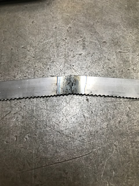

someone was obviously practicing welding a bandsaw blade (good for them). I found this one by the bandsaw. This probably wouldn’t work too well at that angle. It is important to use the break to get the ends a square as possible to butt up. cheers! :grin:
When practicing with the short stocks, it may be necessary to push one side in with a piece of wood. Otherwise they may get what’s pictured above.
