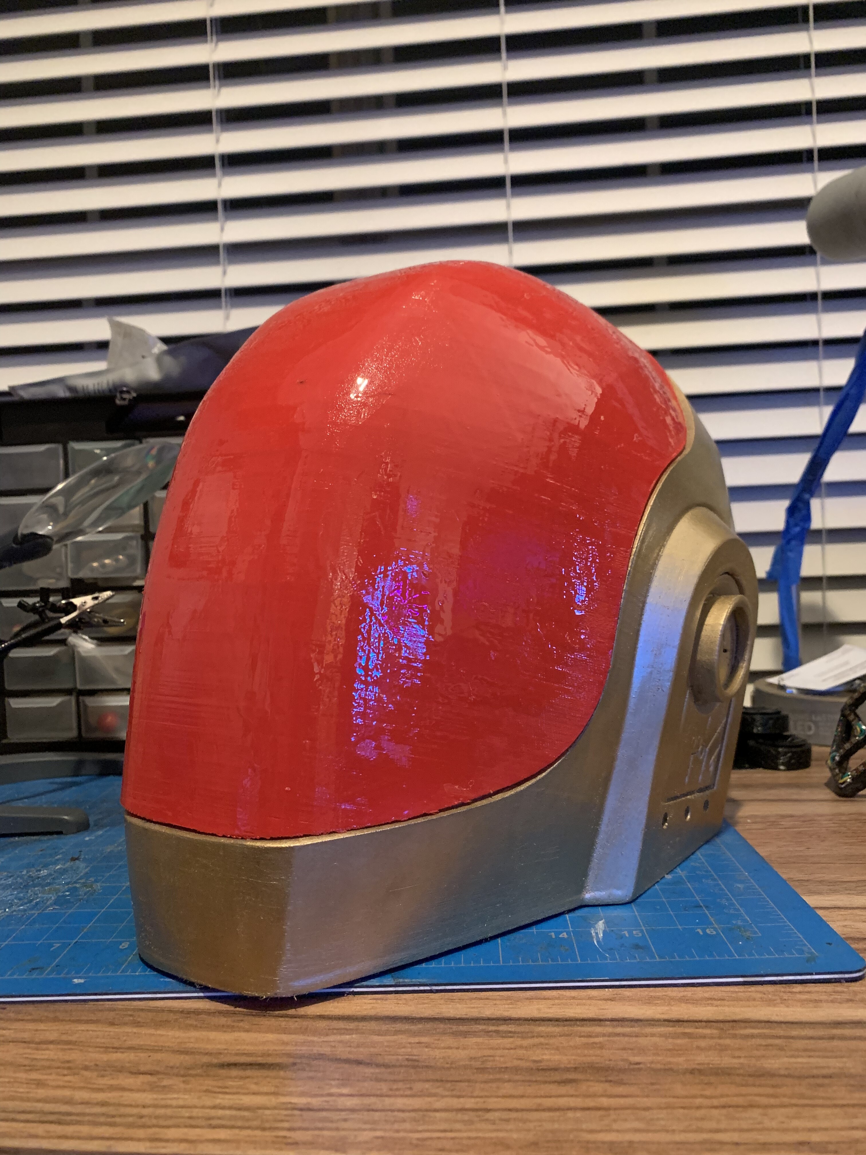

I am in need of some assistance with the thermoformer machine. My understanding of the logic is fair but I’ve never used one before.
I 3D modeled, printed, and set up the electrical for my Daft Punk Guy Manuel helmet. The last part I’m stuck on is making the visor…
Supervision and guidance would be much appreciated!!

I remember a member struggling to get a good daft punk helmet visor, I believe the mold buck can’t have any undercuts and should probably have vent holes. You might have better luck forming inside a cavity than over a dome. Very similar to this. https://youtu.be/RNAc0C8nApc

Does Makerspace have that type of vac setup?? I’ve only visited the space once the other day so I’m not sure if I remember seeing it or not. Would be a great solution! I can see it not working as well, with my luck it’ll be off measurement from the original object… but I do have other projects that require the machine! If it fails ill figure something out.
