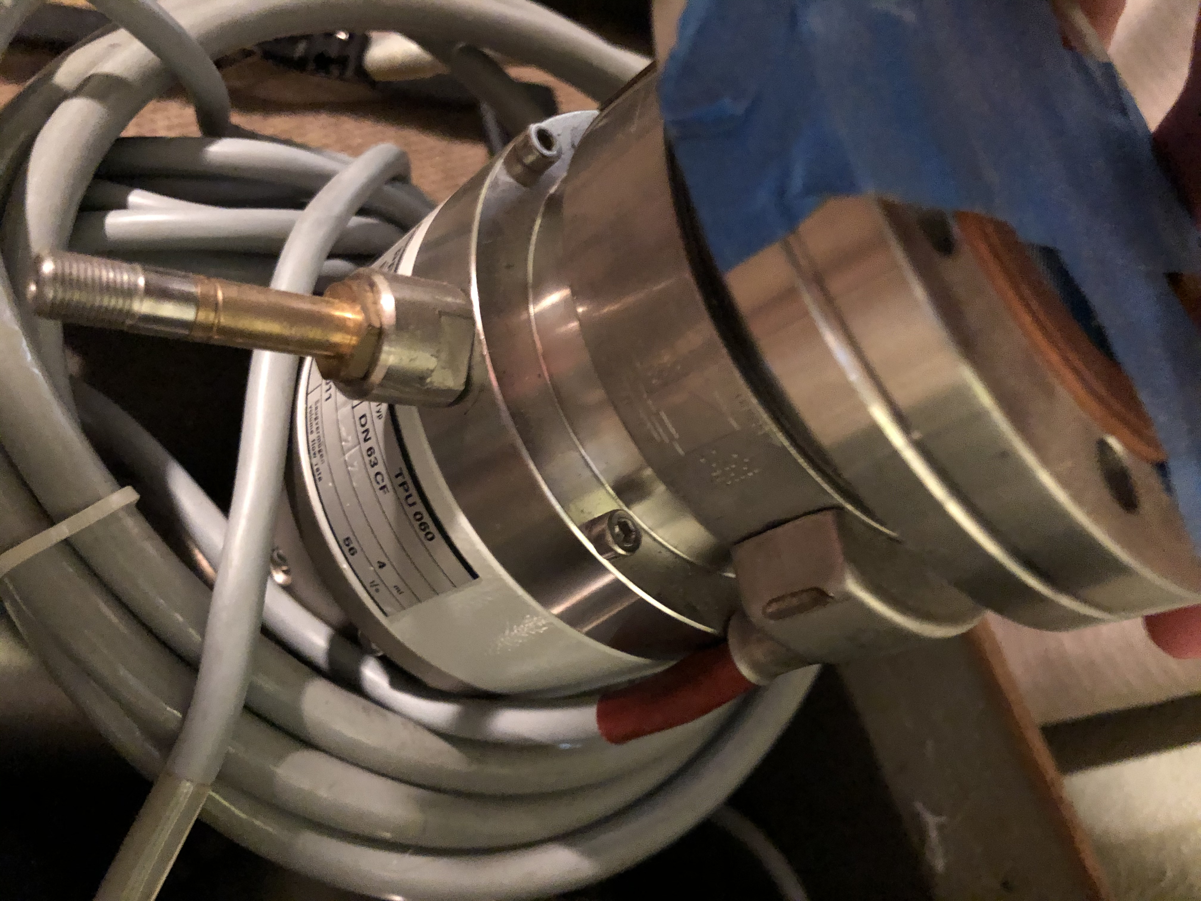

@festercluck I have a TPU060 and a TCP121 controller. I think that should be close enough to test with?

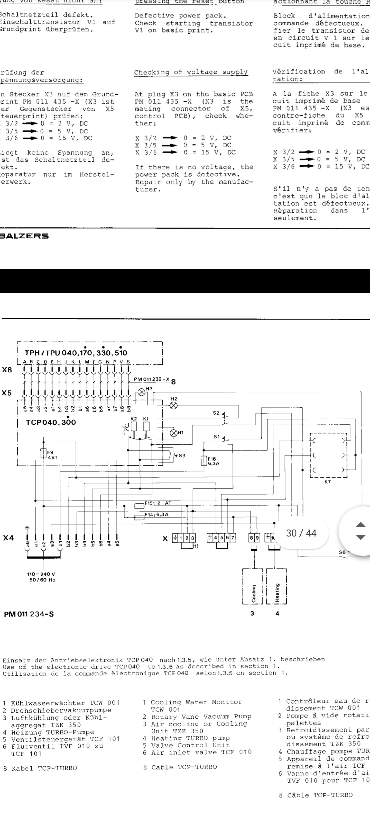

Looks like this is the schematic. Do you have a cable?

There’s a second cable that plugs into the round DIN (?) ports. It’s fastened to some device clamped around where the blades are on the unit. It looks to be some sort of magnetic pickup for RPM? I doubt it would be something for bake-out
I don’t see why it would be necessary if there’s already a motor that you could sense with, so maybe I’m mistaken
Here’s why I assumed the pump is a 040:
https://www.recycledgoods.com/pfeiffer-tpc-040-tph-040-turbo-pump-with-matching-controller-power-supply/
And again here:

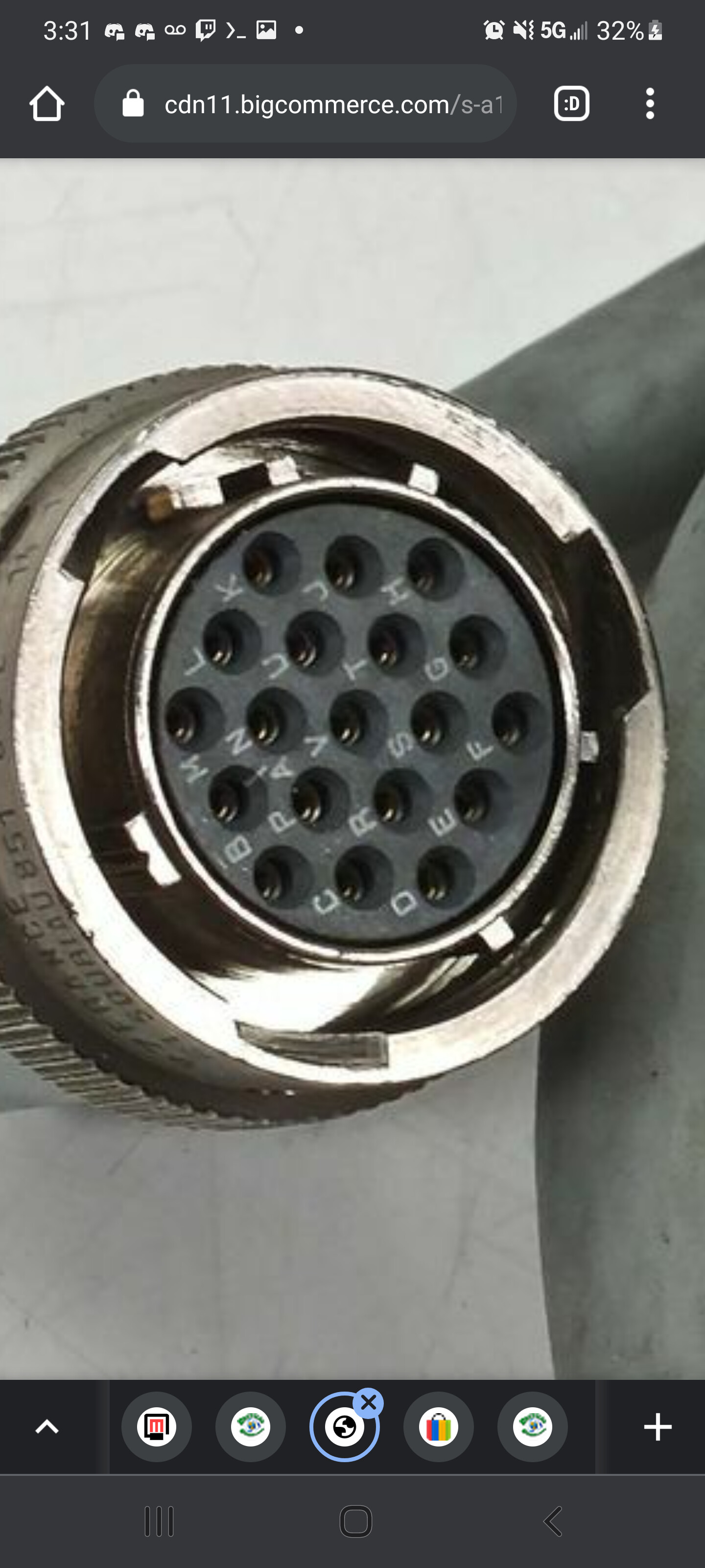

@Russell_Crow I do not have the cable. I had something here I thought was appropriate, but turned out to only have 4 pins.
@michaelb @kbraby It appears the correct cable is 16 pin on the controller side, and 19 pin on the pump side.
I have a pinout! Or at least the means to get there.
It appears some of the extra pins may be for a built in heater.
