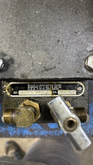

So I’m In the process of changing the oil hoses. I briefly powered on the motor and checked to see if the oil pump was running and it was not. I checked the voltage on the small lead that goes directly to it and it was only getting about 8 1/2 V but the face plate says that it should be 220 V. @TBJK what did you detect when you checked it last time?
Disregard @TBJK Apparently it is working but the voltage is still a question mark.
What meter are you using?
The fluke from the cabinet. I verified it’s reading correctly on a regular outlet.
@TBJK. Disregard yet again. It must be the battery with the multimeter. We tried another and it’s reading correctly now. 220v
