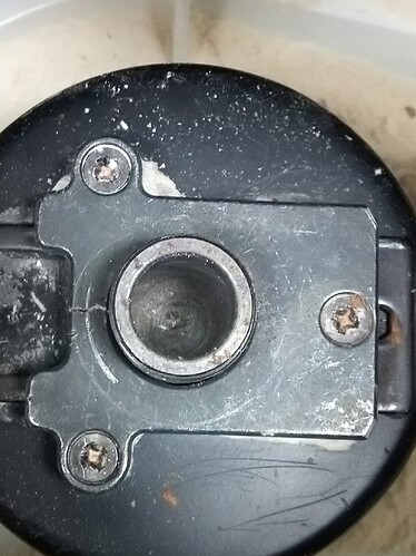

Last night I was showing someone how to change the spindles and noticed that the spring and pin for the lock fell out. Couple people looked at it but we could not figure how to put them back in. I put the spring and pin in an envelope and put it in the (donation box?) by the lathes. Well we were looking at it, someone noticed what looked like a crack in the steel plate were the spring would be.

So it’s a simple pressure fit pin that a spring goes around and pressure fits into the carriage pieces so when your press it in the pin prevents rotation and then the spring provided the pop out force sliding the pin and carriage assembly out! And the plate cause I’d talk to jet a long while back about it, they don’t or won’t sell just that plate we’d have to but the entire top spindle carriage assembly so basically when turned on the black part you see moving up and down, we’d have to buy everything from that black part upwards to fix the broken plate
