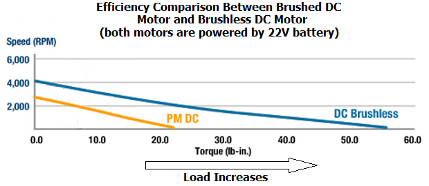

Before you decide to go with a brushed DC motor setup, consider the power loss due to how inefficient a bushed motor is compared to a brushless motor. Here is a chart comparing the two motors…
