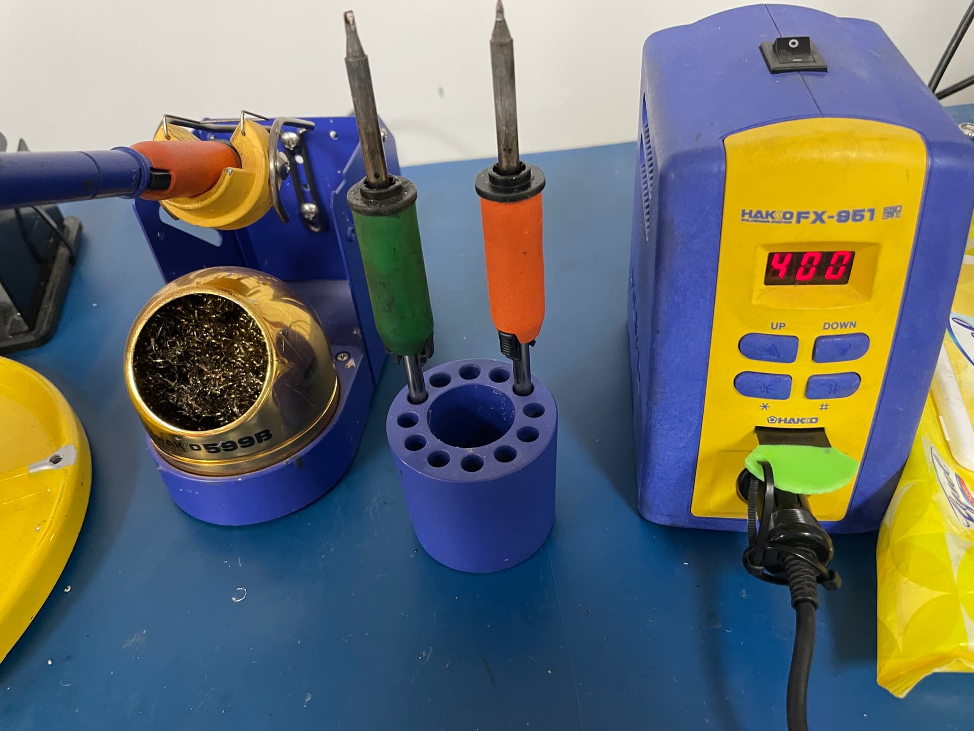

Someone shit and let it lay in electronics…
…and left the soldering iron on. That is all.
I’ve noticed that this is a recurring issue. Almost every time I go into the EE lab at least one of the soldering irons has been left on… There was one day a couple weeks ago, That I noticed they had all been left on for at least two hours without anyone using them :confused:
Page two of the manual here has instructions for how to enable the auto-power off mode, so that the iron will turn off after some programed time between 0-30 minutes after it’s placed in the stand.
400F is the standby temperature so it looks like the stand is connected and working, presumable the auto-off is just disabled.
There is no cable running between the holder and the base unit. The auto-off can’t possibly be functional.
Configuring the auto power off would be a good idea. About twice a year, with my home soldering station, I’ll do some work, shift gears to insulation and/or mechanical assembly, and flat out forget I was soldering by the time I leave the workbench. Usually it comes to me several hours later that I should check. So far, the Weller has shut itself off, and I will turn the switch off, so it isn’t at risk of turning back on with the next power glitch.
Huh. Like I said 400F is the standby temperature, which afaik is only activated by the switch in the stand, so I assumed it was wired correctly.
If the cable is missing then maybe it’s nearby, or Art could order another. I believe it’s a pretty standard 1/8" TRS type of thing.
It’s literally not connected. There is a 1/8” Jack on the back of each with no cable between them. I liked and didn’t see any nearby.
the auto-off feature was the primary reason I bought a couple of the Hakkos. But of course it needs the cable to the holder. But even then I think they can auto-off based on time.
