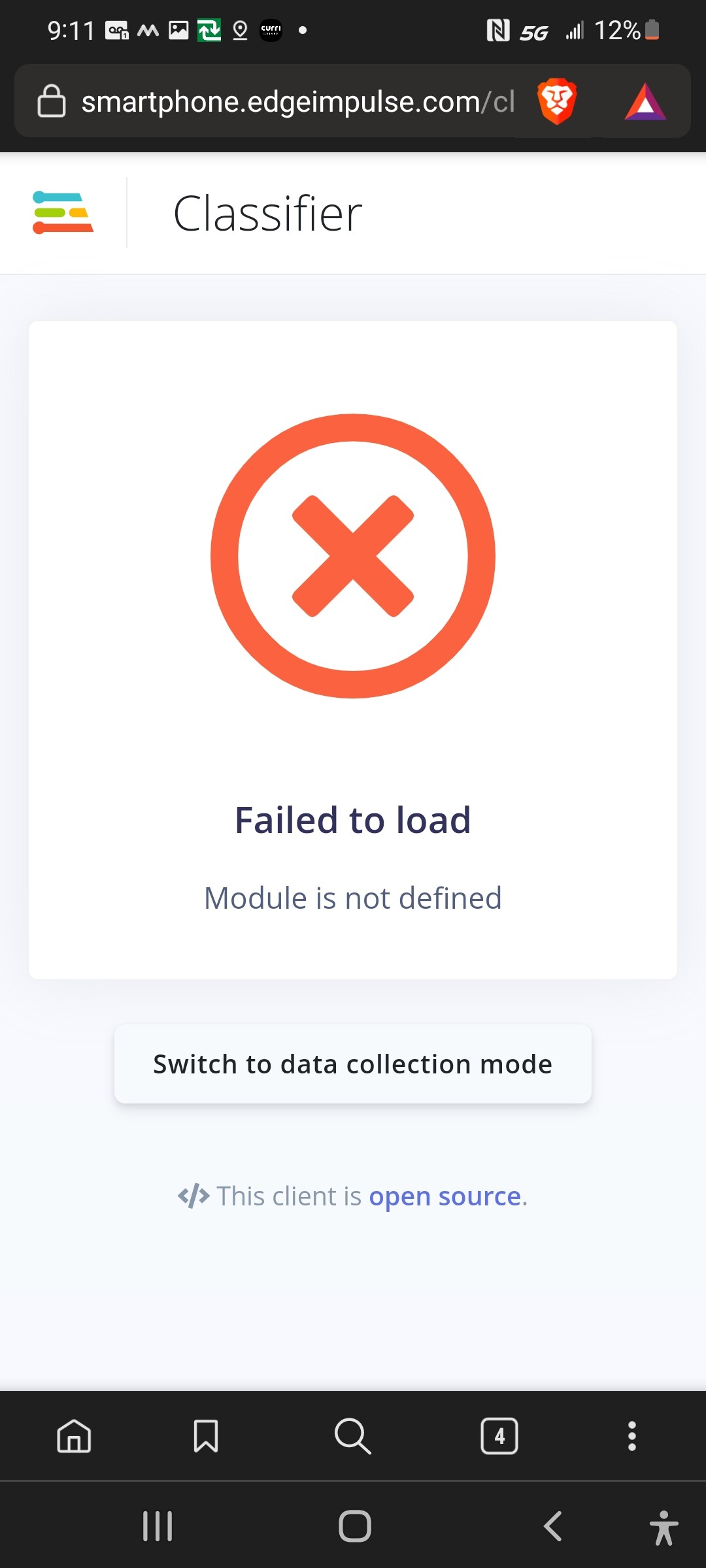

Created an ML model in Edge Impulse but when I try to deploy it (deployment page, green button at the bottom) to my phone or laptop I get the same error. Attached a screenshot
Forgot to add that I have tested audio classification and live classification with the model, so I know the model is working already; but I must be missing some kind of completion step somewhere to enable it to be deployed. Unless this is just a bug

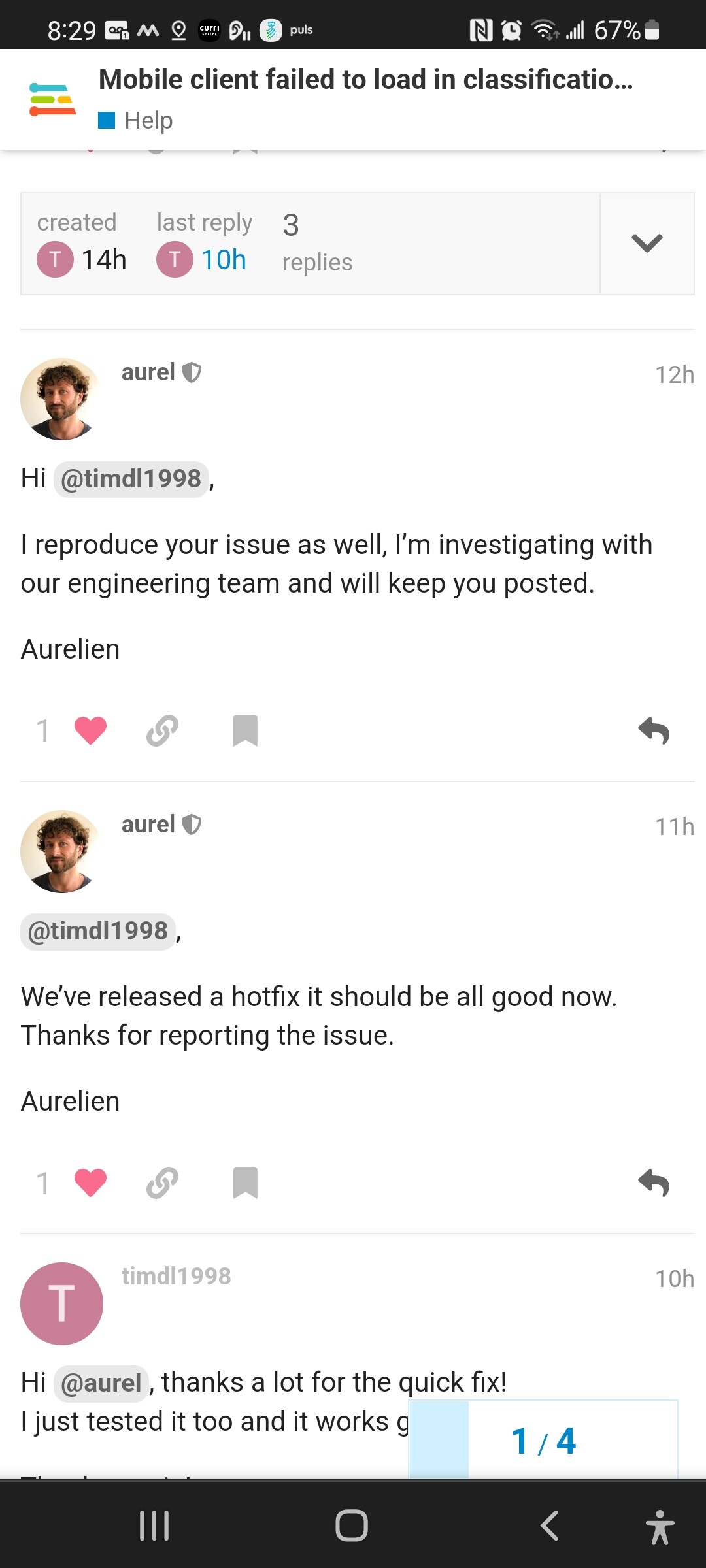

The error mentioned above appears to have been a bug in the edge impulse software. It appears edge impulse engineering team has released a hotfix for this bug. Havent verified it yet
They fixed the bug, so I was able to test some models last night, but every tweak I try I still get a ton of false positives. With so many parameters that I can tweak, i dont know where to first start to try to efficiently eliminate these false positives (falsely identifying the target sound)
