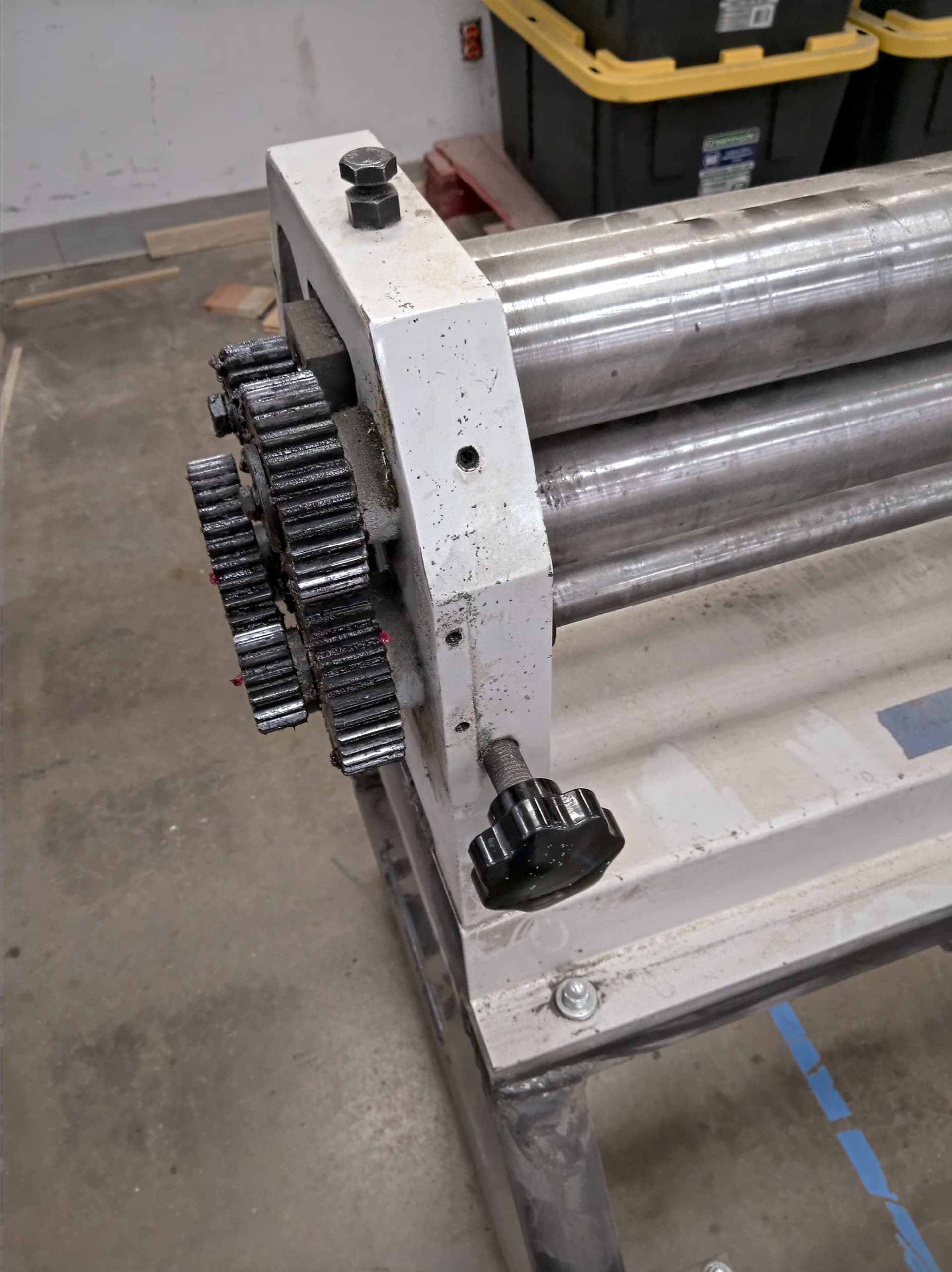

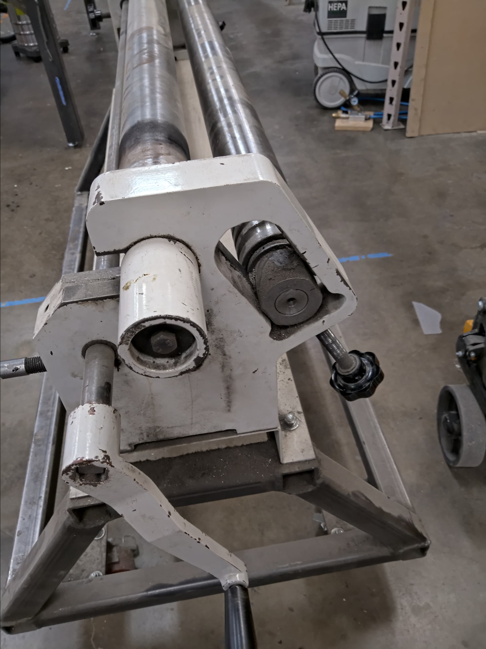

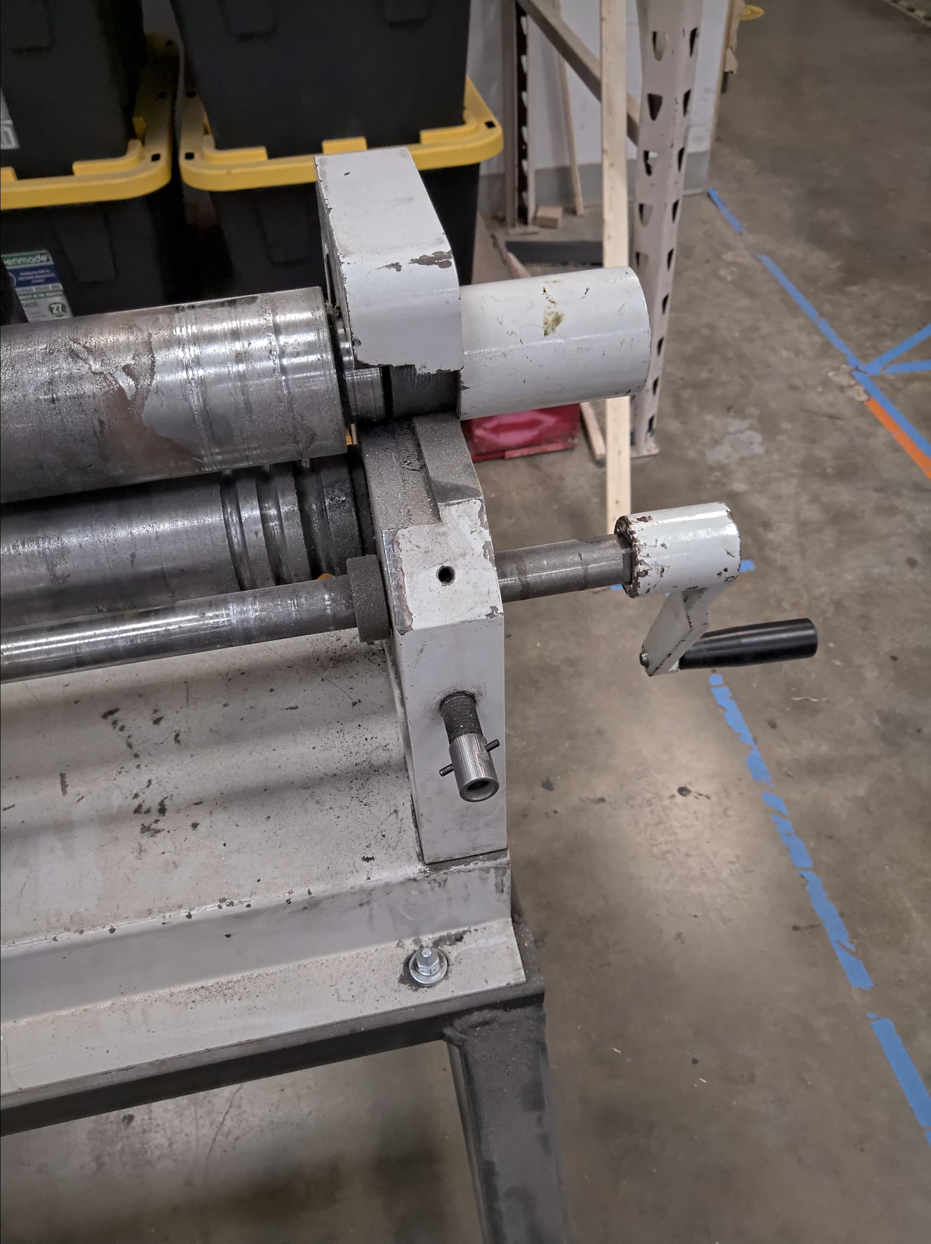

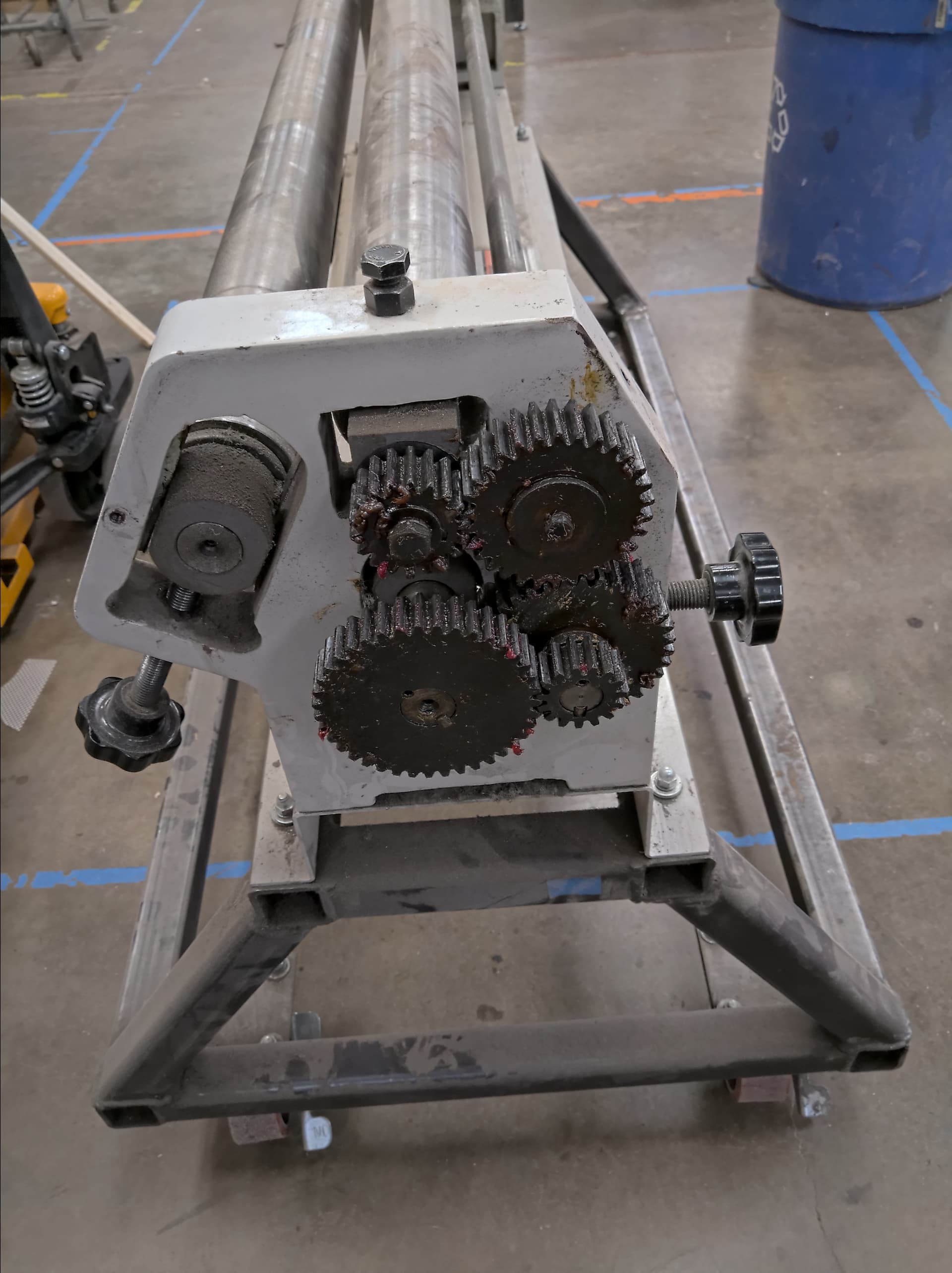

Is anyone familiar with how to lube the slip roller? I used it last night and the driven rollers felt pretty tight and back roller didn’t roll. I got a little grease on the gears but couldn’t see how to lube the rollers. I expected to find grease fittings, but no luck. Also front right knob is broken. @Team_Metal_Shop
Probably just needs to be cleaned and re-lubricated. All that grinding dust is certainly not doing any good.
I called Northern Tech support hoping there were grease fittings hidden somewhere, nope. So it will need to be disassembled and greased.
Also the part number for the broken knob is KLH49680-47 cost with shipping is about $21, phone number is 800-222-5381
