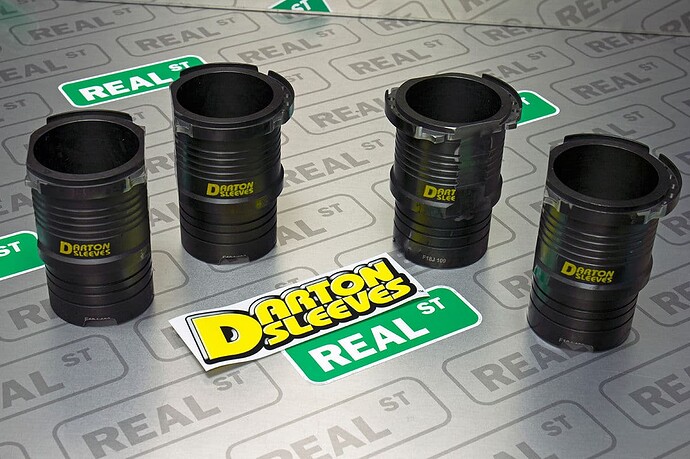

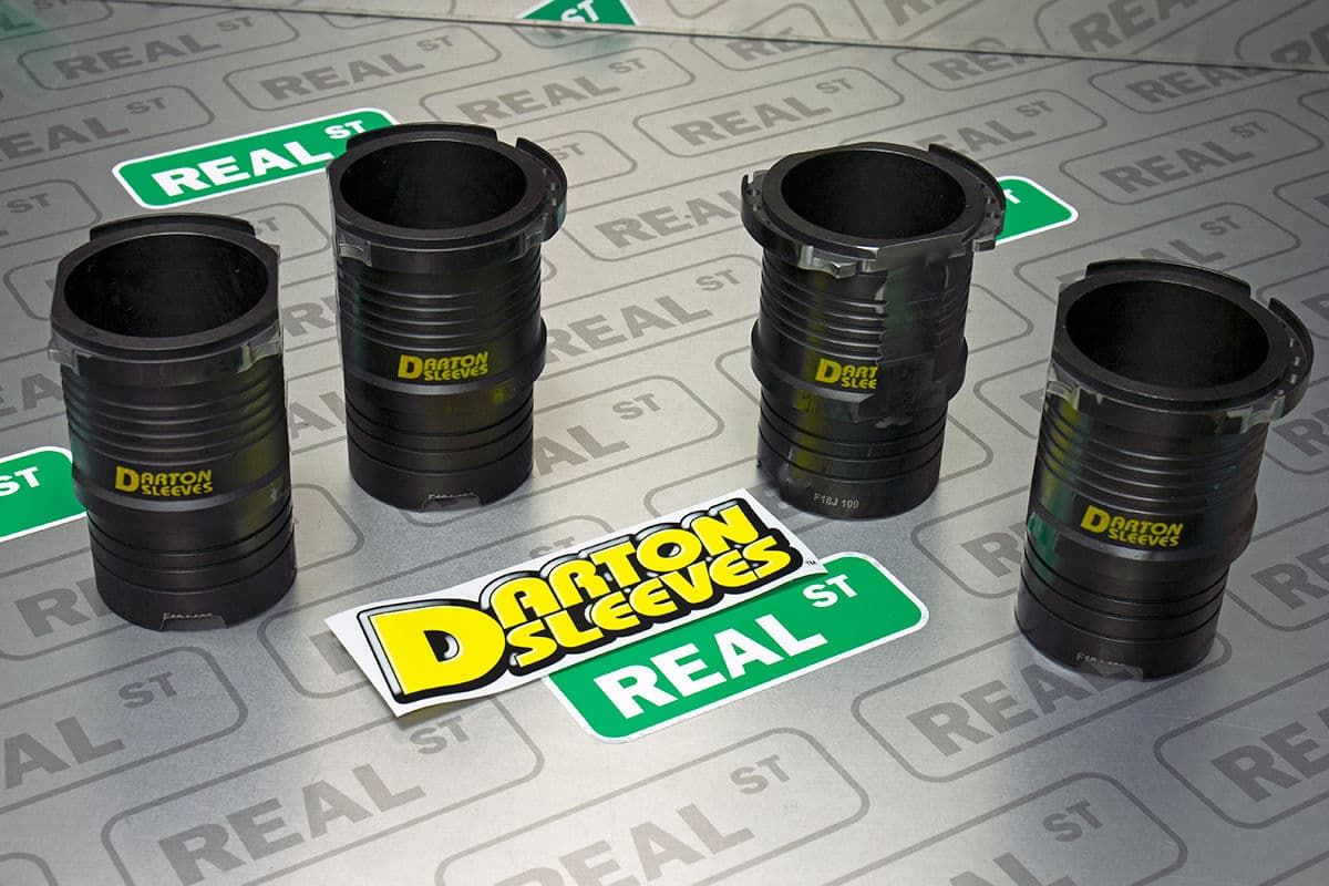

The top of the sleeves close the deck, and only have the necessary coolant passages. I believe this will improve the longevity of my head gasket since these boosted engines tend have higher stress and combustion pressures. The cylinder tends to warp under pressure which leads to head gasket failure.
Here is an image of the aftermarket sleeves for reference.
