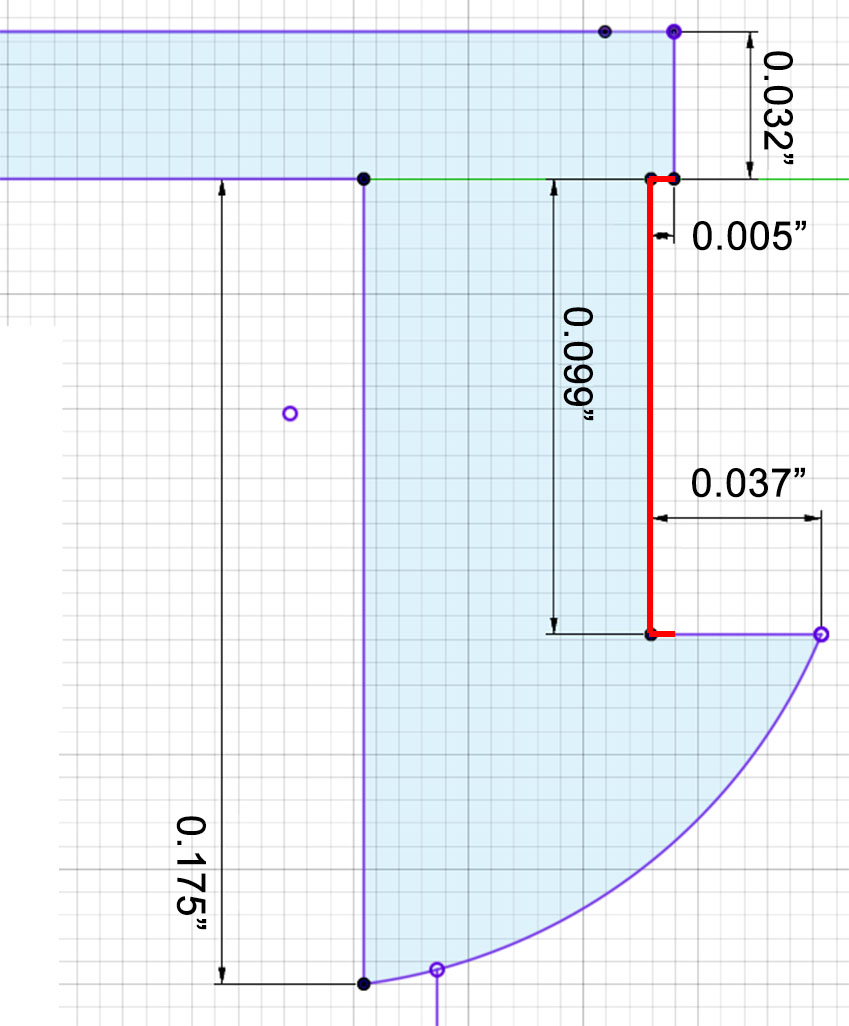

As an alternate, can anyone suggest a place where I could get a tiny T-slot cutter on a 1/8" shaft? I need to take 0.005" (laterally) off of a bronze casting (shown in red). I can hold the part in the orientation shown, or flipped 180 degrees, but I cannot rotate it 90 degrees so that the slot/channel is facing up.

The drill chuck should be fine. you’re not taking deep passes at high speeds so there won’t be much stress. Honestly, a small file might be a good alternative if all you’re taking is .005
