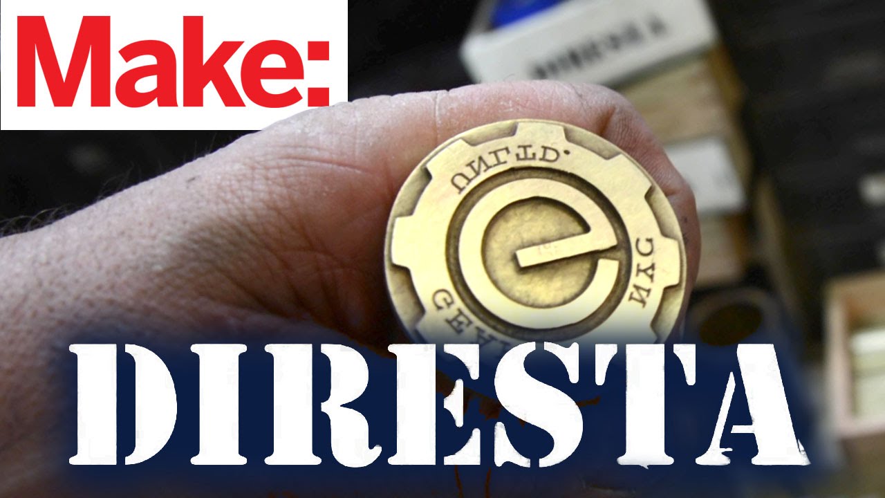

OK…y’all tell me. Will the Shapeoko be able to do this?
…sorry, tried to embed all fancy-time like Walter, but alas…
It should be given the right cutters and engraving bits.
COOLNESS!!! I heat the stamp and use my arbor press to get an impression in the leather instead of just a burn. I’m SO thrilled at the progress being made on this thing. I’d love to watch/help when y’all get ready to install the new controller components. I know NOTHING about that and it would be great to see that process in action.
