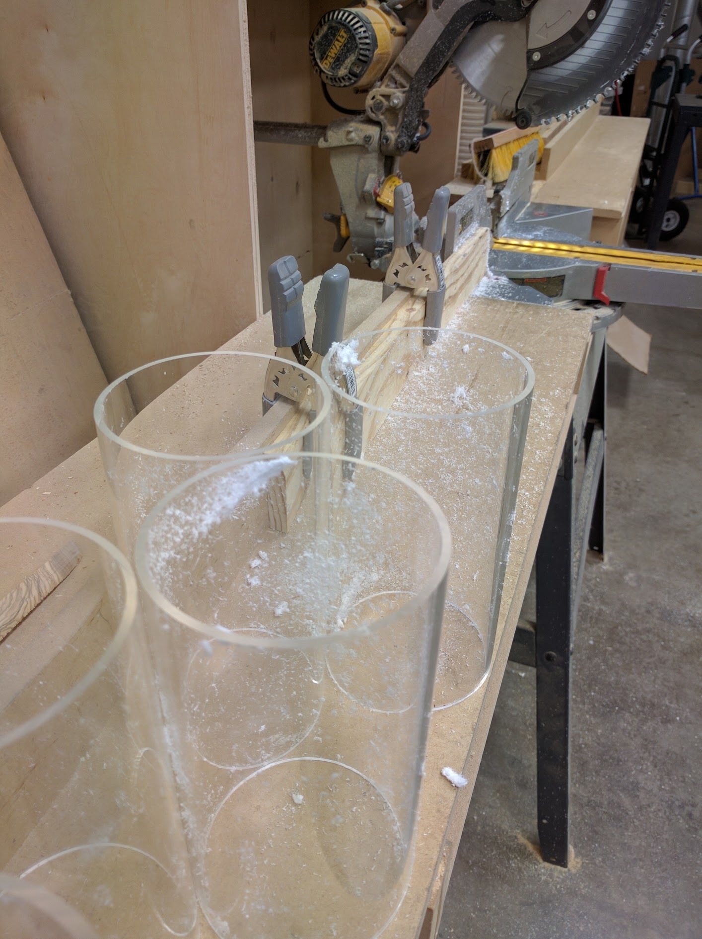

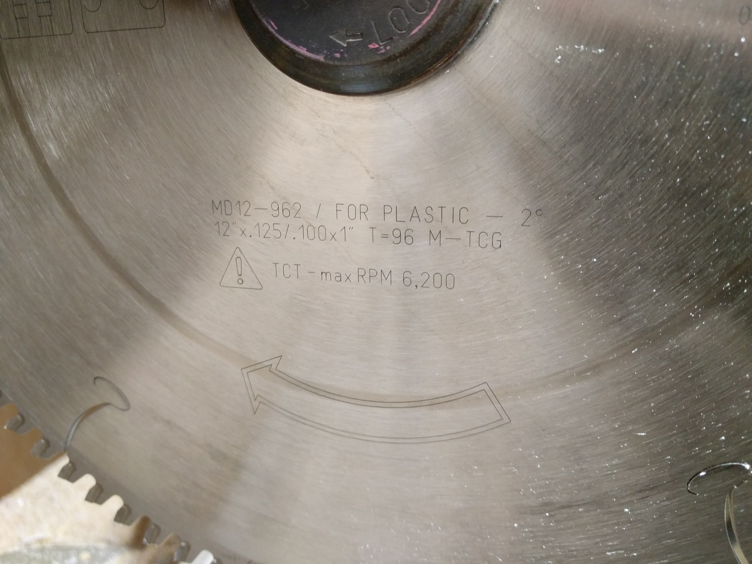

There’s now a 12" saw blade for the miter saw in the wood shop that’s designed for cutting plastics. It requires swapping blade of course and cleaning up after yourself but it’s worth the effort. It works awesome. Please don’t use it to cut anything else other than plastic! If you’d like a hand swapping blades or a quick lesson on how to do it I’d be happy to help.
I have observed the quality of the work and it is indeed impressive.
