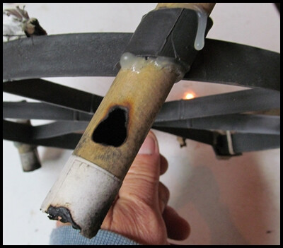

We are dealing with some tube burn through issues due to centripetal force. But, that issues happening in the last seconds of thrust. As long as we don’t have fusing over the area that typically burns through, it isn’t a large concern.
Here is a picture showing the burn through I mention.
Current solution to this is a faster burning BP, that way we get greater thrust over a shorter period, hopefully allowing out tubed to survive their duty cycle.
