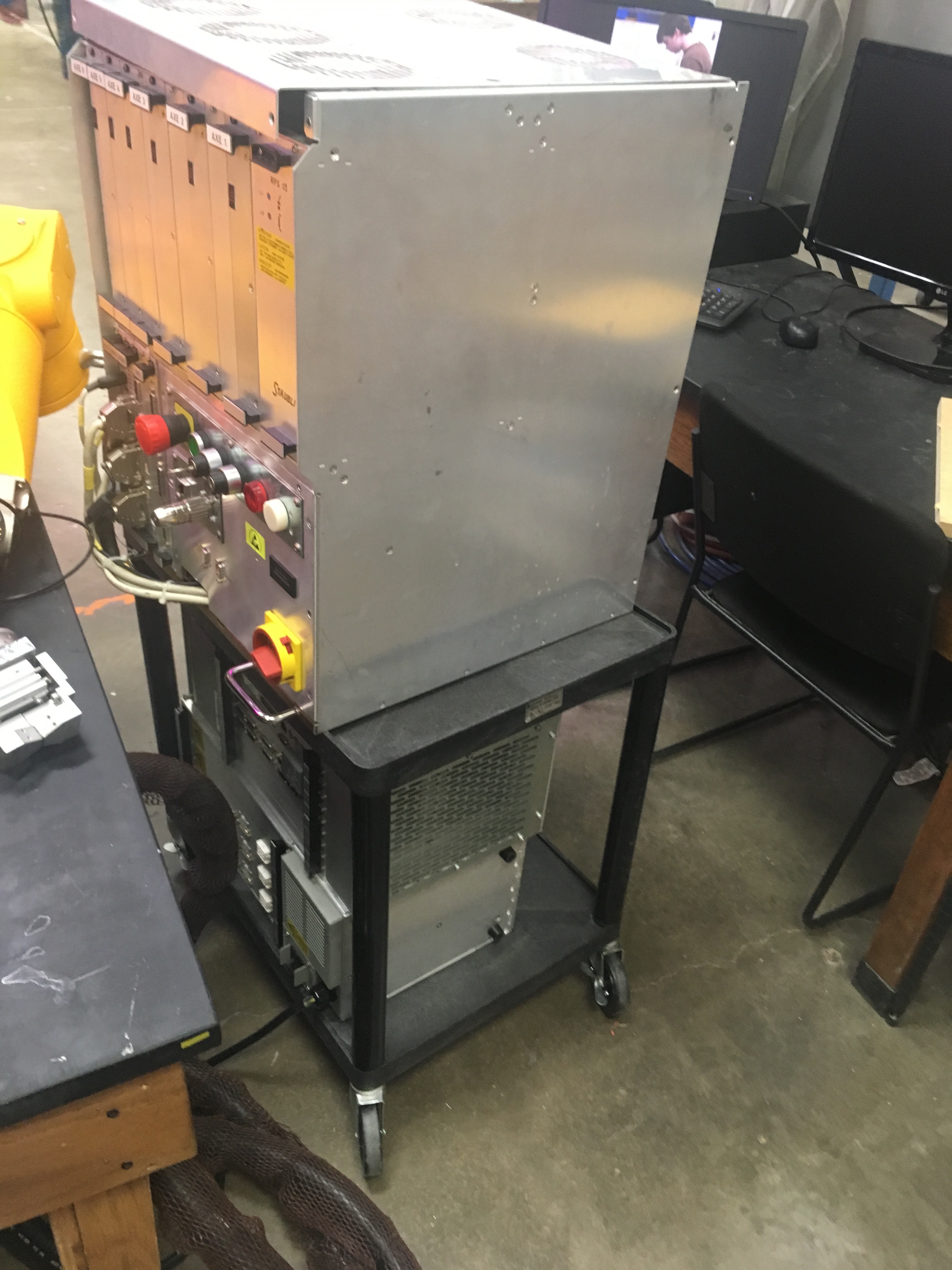

Tonight @engpin @JayJohnson600 @Chris_Wischkowsky @StanSimmons came together and help set up the control unit. Anybody can help no experience required. Check out the manual listed on the first post.
@engpin and @StanSimmons changed out the plug to get it powered up.
Control Unit
Start up Video

we plugged it in to the 3 phase 220v
Indeed it is. It fell of its cradle when they were moving it and decided it was crap. Its a lovely specimen its missing it’s second stage engine but everything else is there. 30k and it’s yours lol the perfect accent for any front yard
The video wouldn’t load for me did y’all get them functioning or just turned on?
turned on for now need a six pin keyboard
