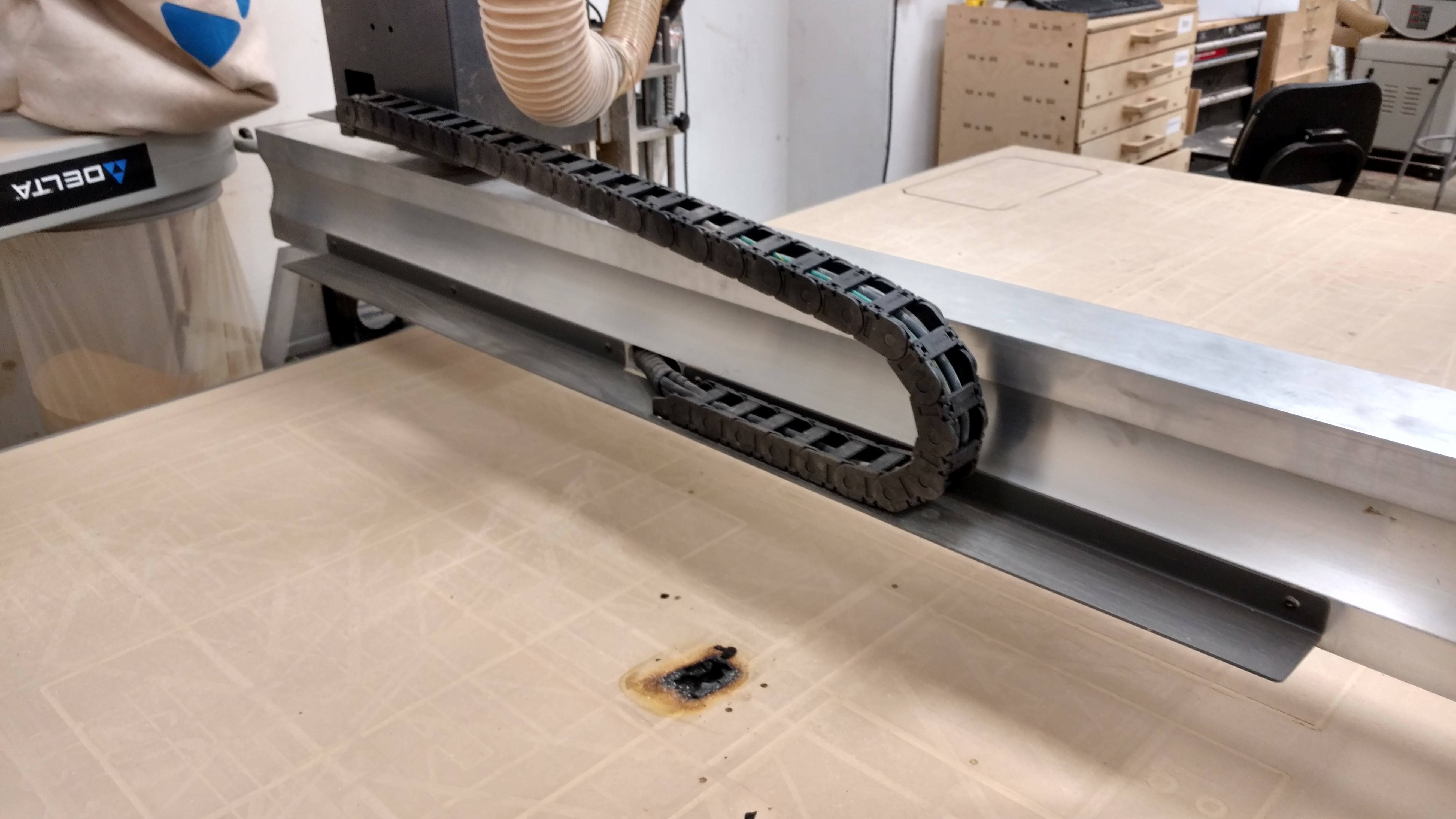

[RESOLVED] WOW! This is pretty nasty
Found this Saturday night.
Either…
You didn’t zero the table. OR.
Your didn’t tighten the collet enough.
But one thing for sure, you walked away from your job and started a fire on the multicam CNC.
BAD.
Looks like it burned right into the rubber mat vacuum table.
How the… skip that… how do you just walk away like nothing happened after something like that???
You could see the thing was in flames cause they POURED water or sprite on it. Then they were kind enough to put the collet holder back into the drawer. At least they cleaned up.
Sent email to CNC supervisor with link back to thread to ensure it got tracked quickly.
Found the picture, sent to Board of Directors.
Already addressed on the woodshop forum. We have to bring in an epoxy kit for the platter. No one walked away from it without working toward the solution.
The person did not just walk away he was with the job the whole time and if he did not act the way he did the table would have be gone.
You SHOULD thank Him
@fedakkee Hold your horses people.
I’ve already put the issue on the woodshop talk as soon as it happened. This happened while i did my job and had nothing to do with setup.
If anything its due to dull bits, the same bit that caused the fire snapped within a min of my job.
The nut your showing also had nothing to do with the fire. The gantry was already cutting another piece, the bit snapped and then all of a sudden i see a flame almost like a torch coming out of a hole a foot away from where the bit snapped.
So the friction generated enough heat to start an ember underneath the cut piece it was burning and i doused it with water which caused some nasty fumes that stunk up the place, I actually felt weird due to the fumes, not sure what the vacuum rubber is made out of but on fire, its not something to breathe in.
I posted the photo and let everyone know what happened. Yes I cleaned up cause that’s what i always do after a job, we dont have anymore spoilboards or i would have switched it out.
So no one walked away from this and this was not negligence, just an accident I had no control over.

My guess is a downcut/compression endmill and plunging. The chips pack in as opposed to being ejected then frictions starts taking place. The reason the fire is not seen is due to the Vacuum table sucking air in this also makes the fire bad fast as the air passes through the fire.
To avoid scenarios like this it is highly recommended to ramp as opposed to plunge the endmill and make many gentle passes in order to eject the chips. I would also recommend only using upcut endmills for smaller holes.
For example if you need to make a 0.25" hole in 0.75" material; Change the hole dimension to 0.3" and ramp through it 0.17" depth at a time.
If you absolutely have to have a 0.25" hole either use a drill bit or use a 0.125" endmill. If you use a drill bit you must peck it and pull the chips out to avoid the same scenario.

It was compression bit, per Multi-cam rep, is capable of plunging. Guess he was wronnngggg…QC already dispatched.
Down-cuts are used on softer woods as the up-cuts cause nasty tear out unless it plunges at least a 1/4 or more in the material. We spoke about this the other day, in order for the up-cuts to work they need to be super sharp and set at the correct feeds and speeds to not cause tear out, we have neither.
Every time i have used an up-cut it has nasty tear out when cutting shallow, which is why down-cuts are used for softwoods to preserve the project.
Last time I saw that compression bit, it was pretty dull. That’s my theory as to what happened.
