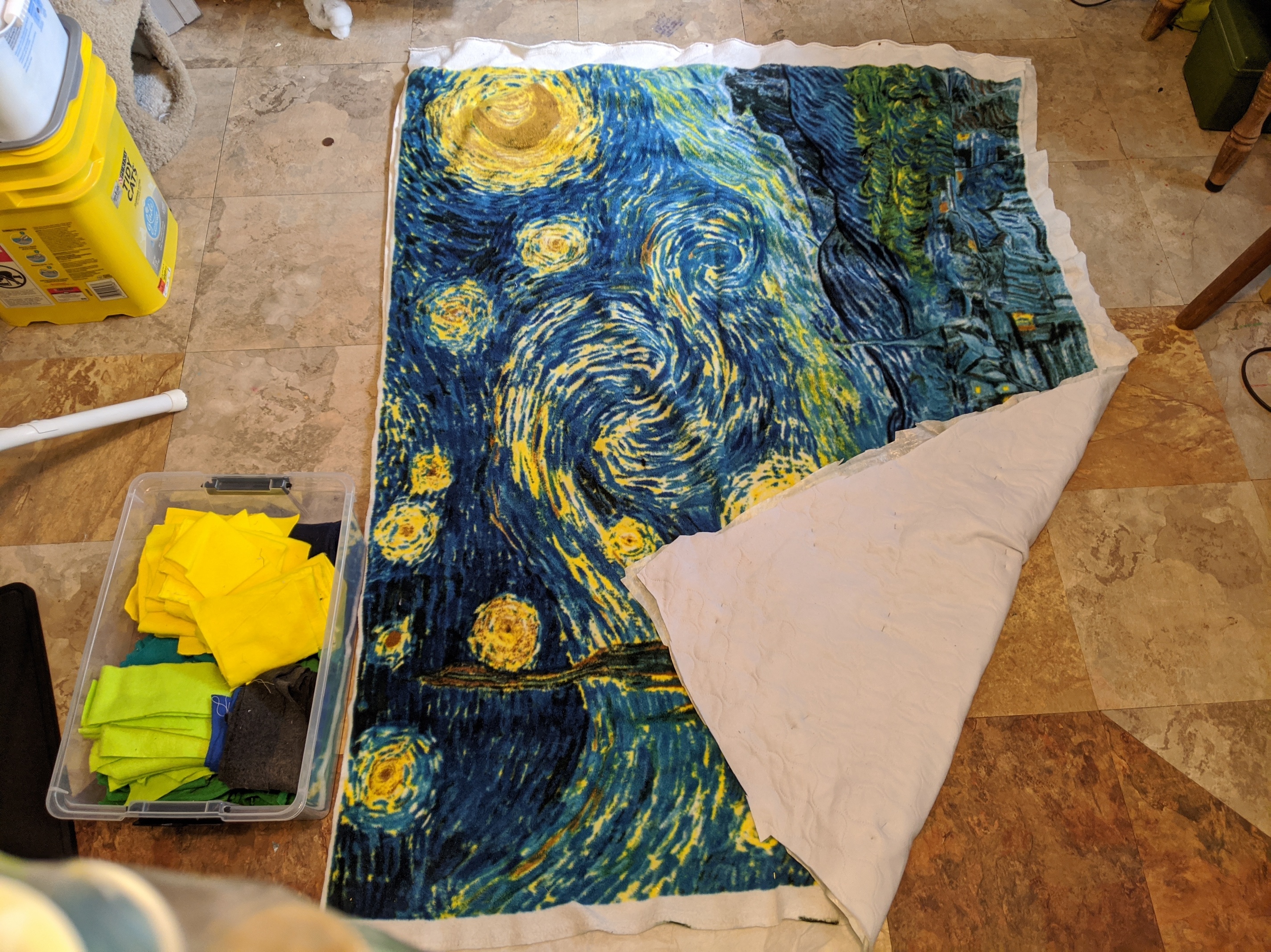

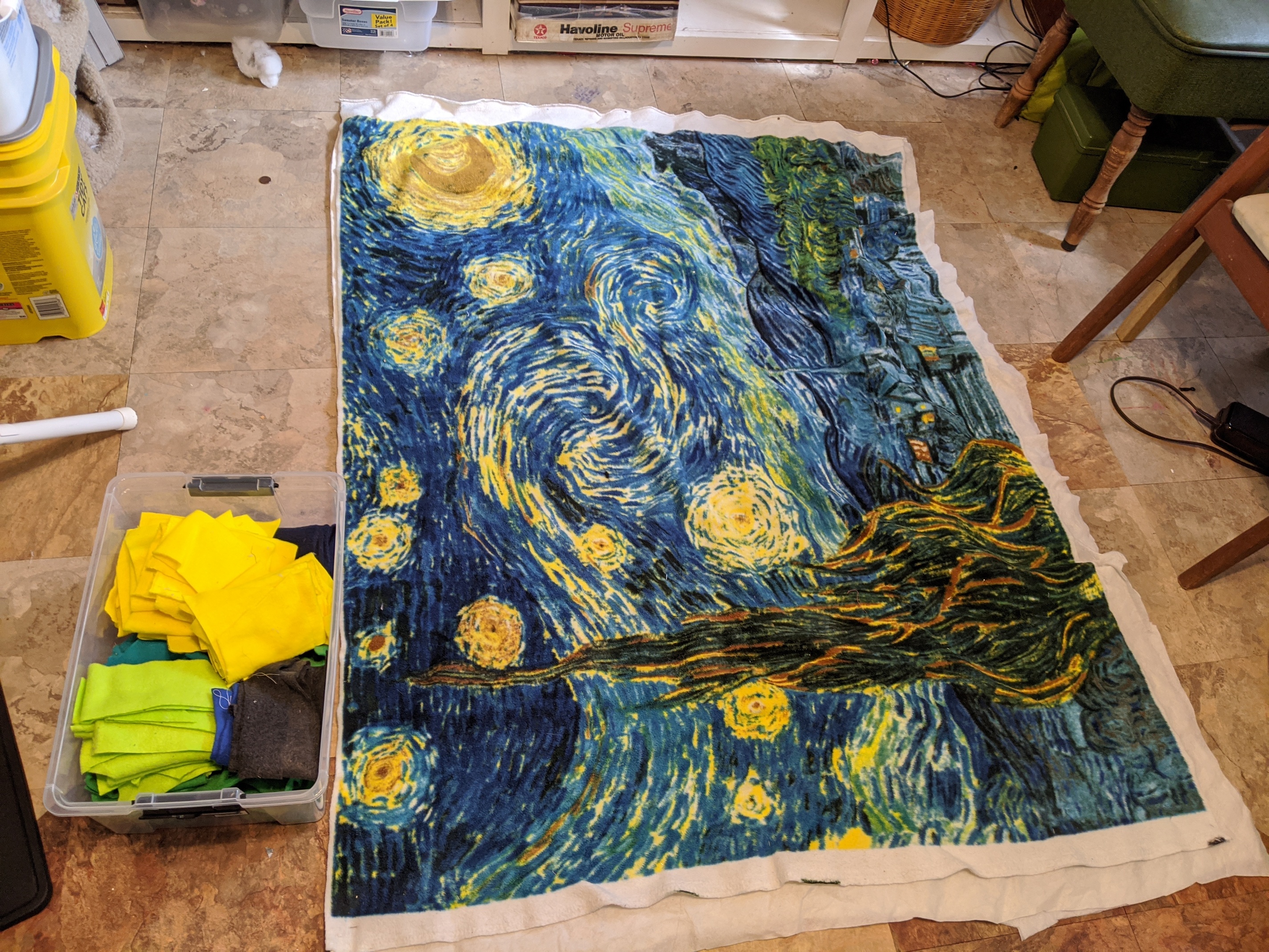

I’ve got a blanket I want to use as a quilt back. I have a mattress pad that I’m using as the “batting.”
I have a bunch of random scraps of fleece that I’d like to create a random, kinda fluid “quilt” to put on the other side of this blanket.
I’ve only ever done quilts with squares (and astrud’s strip quilt).
I’d like to stitch the pieces together to echo the starry night swirls, though much bigger and simpler.
Ideas on how to make that happen? I was thinking of cutting my shape out and laying it on top of another piece and stitching it down (so I’m not trying to join two curved edges.)
Or maybe using a sheet and sewing my cut out pieces to it?
I laid it out and pinned the crap out of it. Then i started in the middle and did (slightly wavy) spokes with my sewing maxing out to each corner. I’m thinking about hand sewing the blanket onto the mattress pad because I’m not particularly happy with the lines crossing the picture. It’s stabilized for now, so I should be able to hand wheel out from here (maybe)

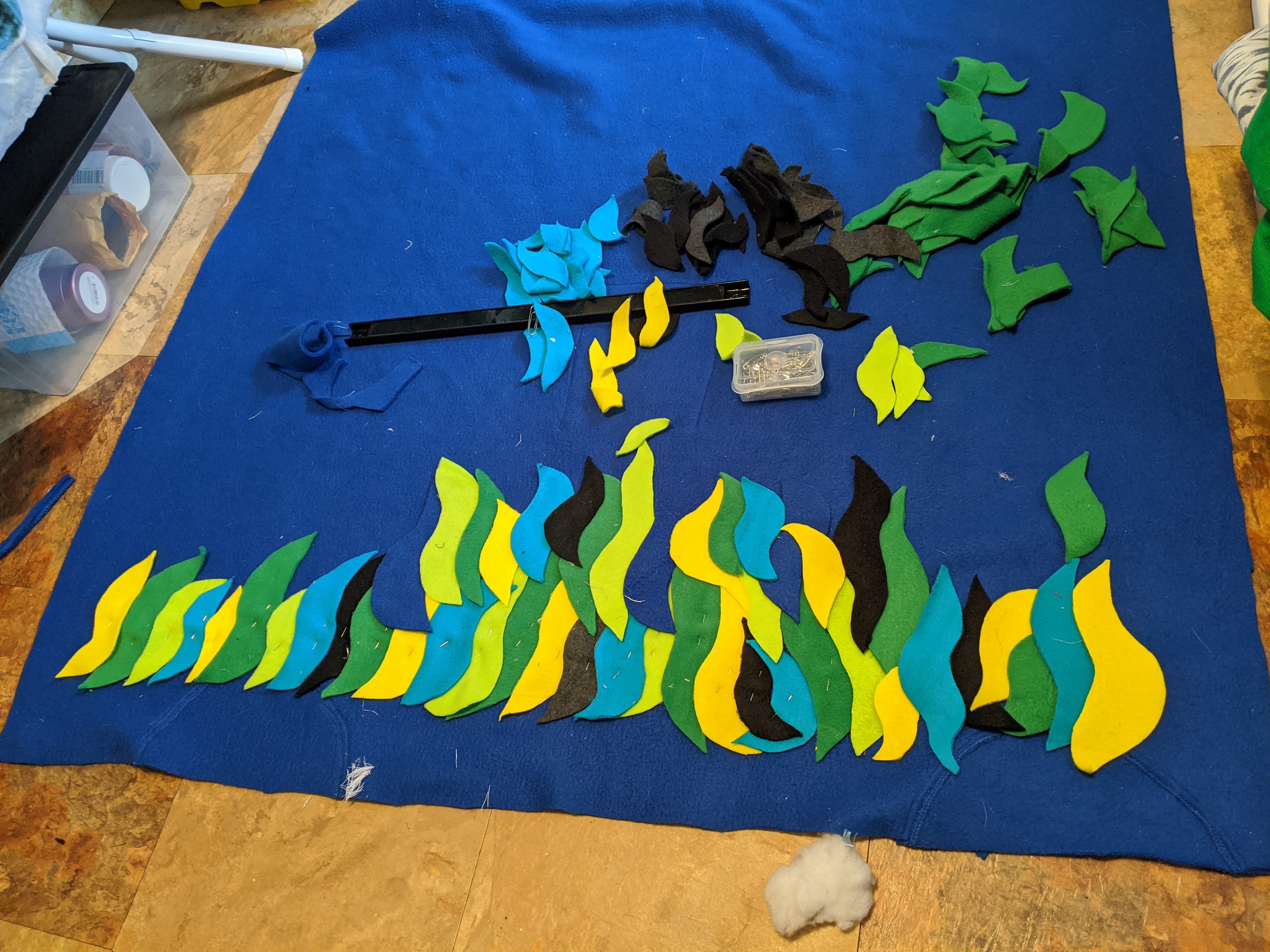

I think I’m assembling the back, but I’ll likely be using it as I sit on the couch, so I need to like both sides.
I’ve already started over 3 times placing things. Now I’m in slug cutting mode.
[version 2 of 3]
No adhesive, I guess. I’m not willing to gunk up my grandmother’s 70yr old singer.
If you were going to pin baste the slugs onto the blue fleece backing, any tricks? I feel like I’m going to pin it, hand stitch it, and then sew the crap out of it on my sewing machine.

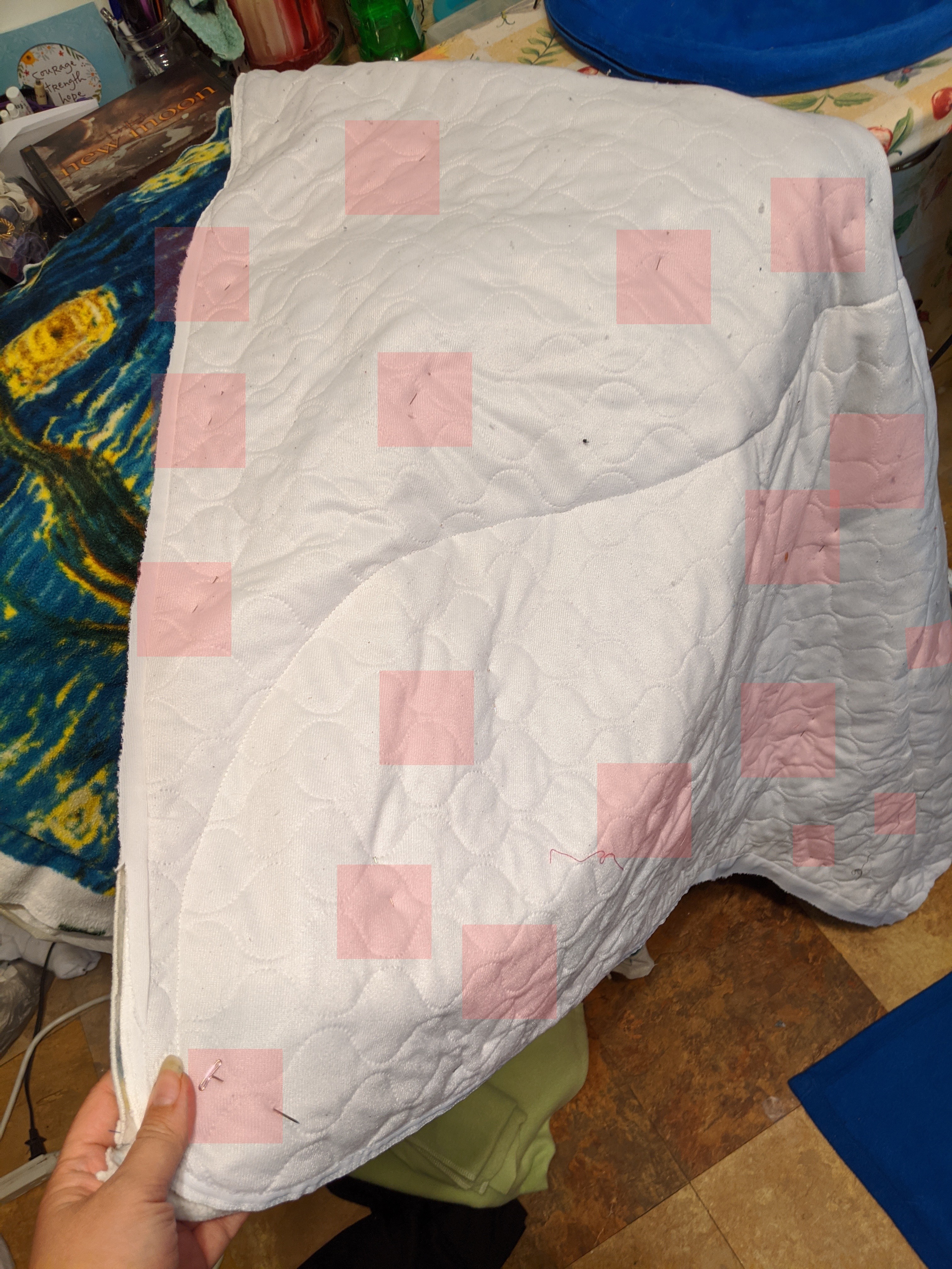

The front is pinned every 9-12 inches in every direction. Is that enough or would you do more?
And the lining/batting/mattress pad is weird but I think pinned enough to stay together.
Looking at your various pieces … has everything already been washed once? I’m thinking about different shrinkage rates during the first washing.
Oh, lord. I didn’t even think about them not being washed. All the little pieces of fleece probably haven’t been.
Thanks!
Well … let’s think about this. @jrkriehn - please chime in.
What is the fabric content of the starry night piece? If it’s 100% cotton it could shrink about 3% the first time it gets washed. Your fleece is most probably polyester so it will probably shrink very little - so prewashing that probably isn’t necessary. Your mattress pad isn’t going to shrink.
The difference between the cotton and the mattress pad is going to cause some puckering … however - some people really like that because it can make the quilting look a little puffier. However, it could also twist. It’s my experience that cotton fabric tends to skew a little when it shrinks the first time.
If the starry night piece is 100% cotton (which IMO is the most likely), I would pre-wash it (cold, with 1/2 cup of white vinegar) and then dry it on hot (with a towel in the dryer so it tumbles better). I wouldn’t do anything to the fleece or the mattress pad.

These flames are about to get a LOT bigger. Yeesh
