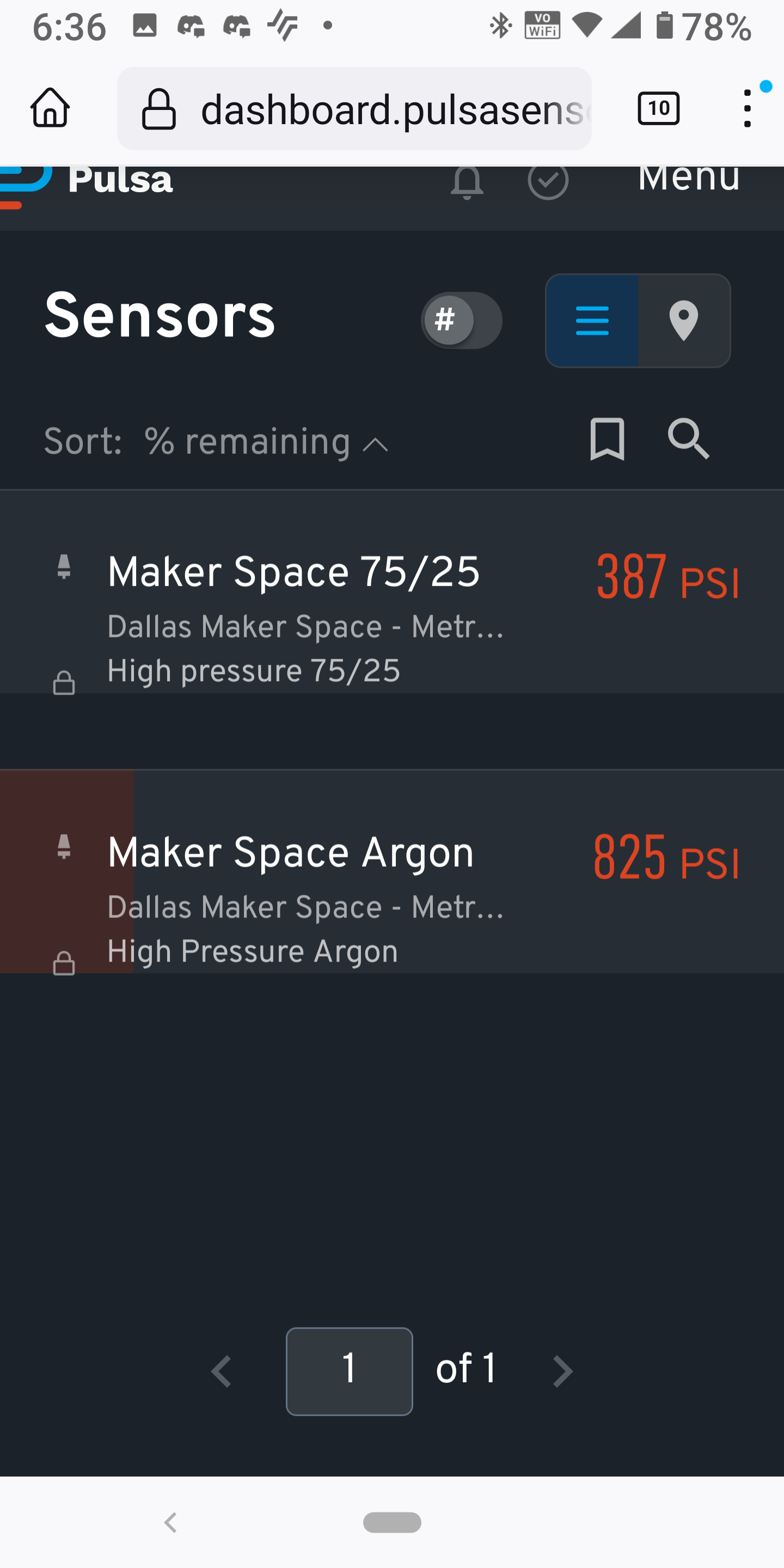

ONE LAST NOTE: It appears that we are very low on argon gas at the moment. Please remember to always check the pressure before using any lasers so as to help prevent fires.
@rlisbona – Do we know anything about the current state of the argon?
What indicates we are very low on argon? I opened another bottle about a week ago and its showing 800psi on the pulsa remote monitoring, i think we have 3 full bottles in the six pack.
Iirc we’ve turned the pressure at the lasers down as low as possible within the last few months, to minimize the effects of leaks and try and dissuade any use as blow guns. Maybe that’s what you were noticing?
If you are looking at the gauge on the wall on the black iron pipe that gauge is pretty useless, its meant for the cylinder pressure and we drop it to less than 150 psi outside on the six pack. Last time I looked at it it appeared to be close to zero line pressure
I am not sure. I looked at the tanks outside, and it looks like one was in the red zone and one was in the yellow zone/otherwise lowish pressure… Maybe I was reading the wrong thing, I’m not sure.
