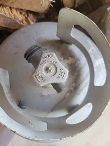

You don’t find many of the old ones any more. Legal ones have to have an “OPD” and the valve turns will look like this:
If the turn looks like this, or is stamped “OPD” (or generally both), they’re fine.
