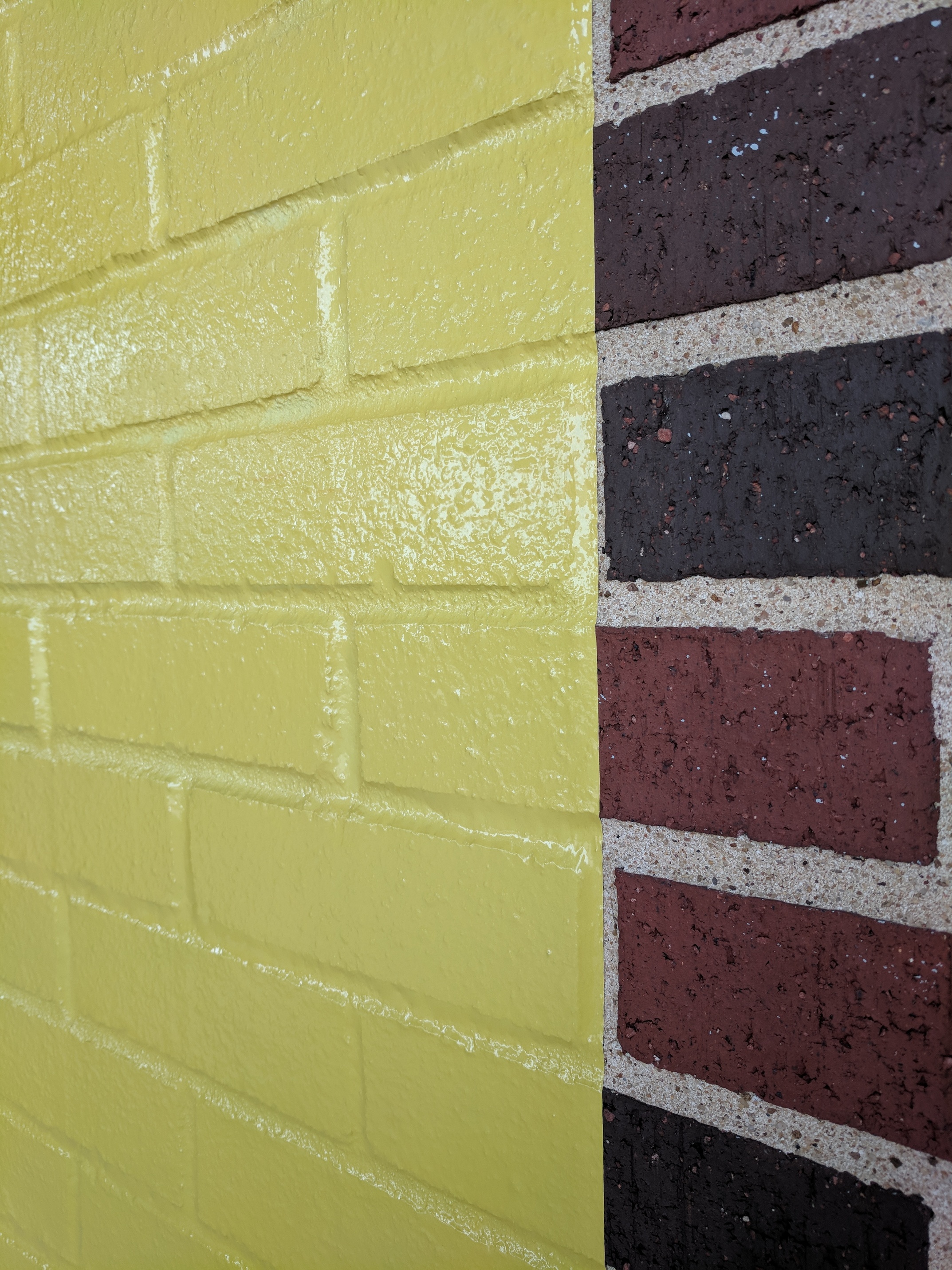

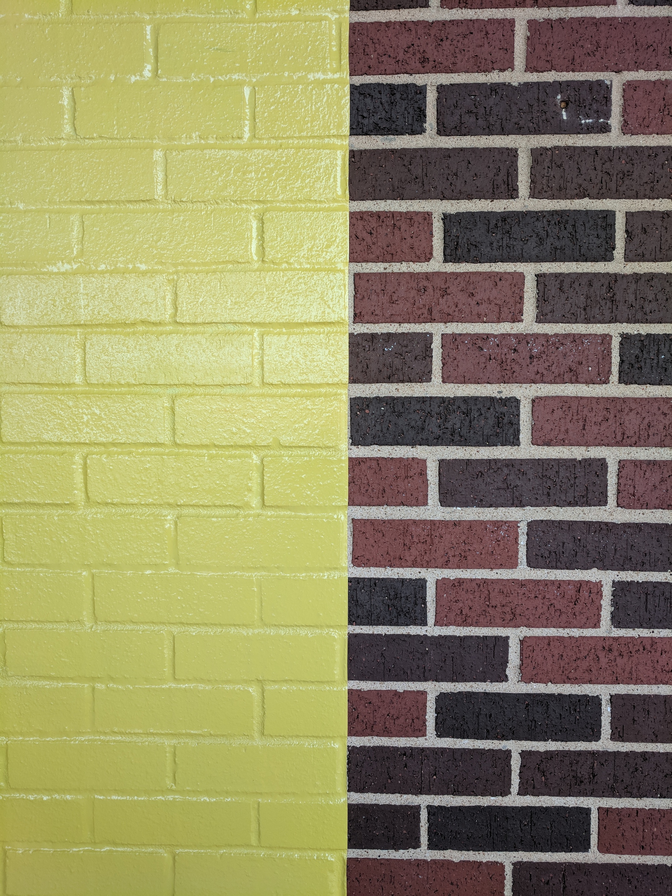

What would everyone want to wrap in a class? A lot of things like screen bezels, flat surfaces, and interior walls just need a squeegee and roller to apply but if it has a lot of sharp angles, curves, texture than heat is needed to stretch it/form to it. Here are a couple of examples of different material/applications I just took pictures of.

Mural on a brick wall (photos are only showing a close up) Same material as in that video that is applied with heat and rollers.
